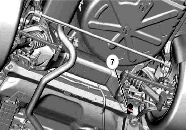

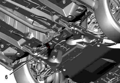

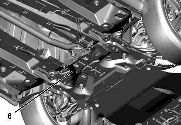

If the sensors are not sending data or are sending data way out of scope this can trigger a fault and the same will happen.
Sensors are shown at (6) & (7):
Front Rear
Front Rear
