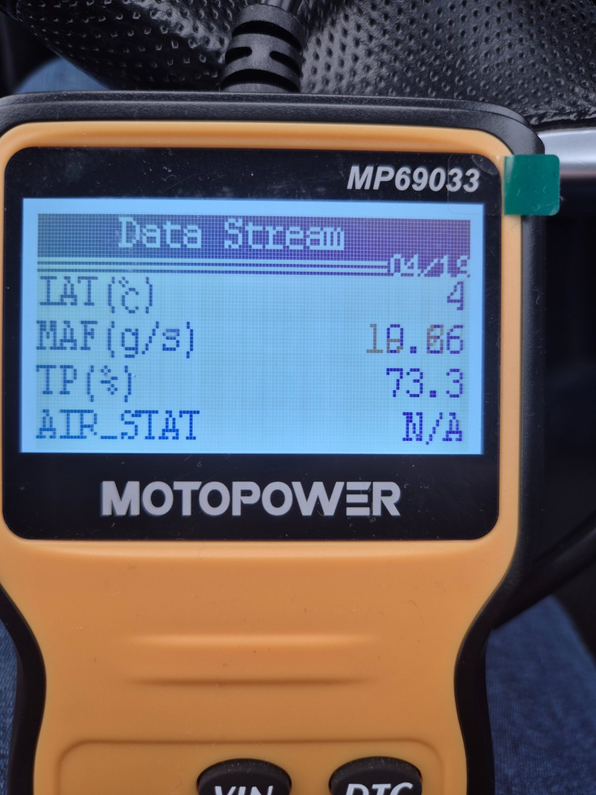

Well that's definately off unless you're living in northern Alaska - Fair to say that sensor is toast.
Try getting live data with the MAP unplugged, just to see if IAT changes.
If it does that rules out wiring I'd dare say, and it should be just a matter of replacing the sensor itself.
When it comes to things like MAP/MAF/Crankshaft/what-have-you sensors it's rarely worth it going the cheap route :)

Hi guys,
Seems I have an open circuit somewhere. Giving the wiring from the sensor effects the temp reading. Specifically at a T Junction. I assume that would be the 1st point to look at for a broken wire.
I'm guessing it would be fine to just solder and broken wires back together
Mart7379
Posts: 34
Joined: 31 May 2021, 10:35
x 2
Re: DS4 Intake Air Temp sensor - P0113
Unread post by Mart7379 »
Soooooo,
If i wiggle the wires into the plug into the MAF sensor, the data stream for the Intake Air Temp goes from -40 to around 15-20c. On top of that if i get pull the wires at the point it goes into the MAF plug it'll stay at 15-20c
Is it likely to be a plug/connection issue, or a faulty MAF sensor all along.
If a plug issue, I'm guessing the replacement is dealer only?
