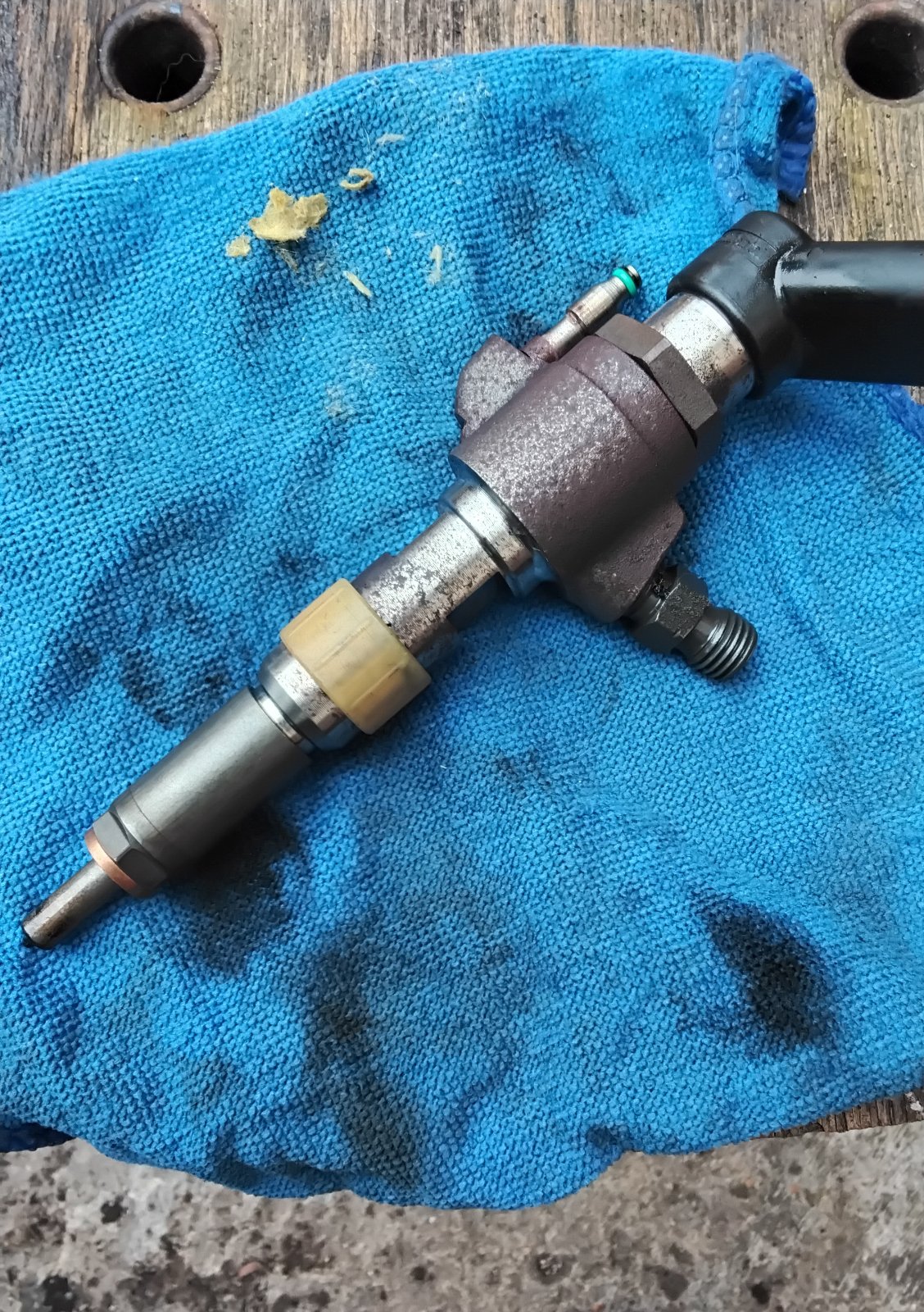

2 injectors had some lovely gunk all over the tips so I just sprayed carb cleaner and soaked the tips in some carbon cleaner for about half hour 1&3 were dirty but 2&4 were just like the photo. I've almost completed the job , think the leak over pipe has a rubbish connection so I've just ordered another (my mechanic that is) then whe that arrives it can be run up once the airs been pushed out the way , we did fire it up it ran then stopped 3 times but my battery needs a recharge so , charge that & when the leak overs get here , fingers crossed up & running again.
Ohms test for each injector 180.0 to 190.0 so all as it should be , I'm putting this down to two with very very messy tips. When the engine did run up the shake ,shudder was gone , just stopping now because of a busted connection on the leak over on number 3. Thanks to my mechanic & letting me watch & supply tea !

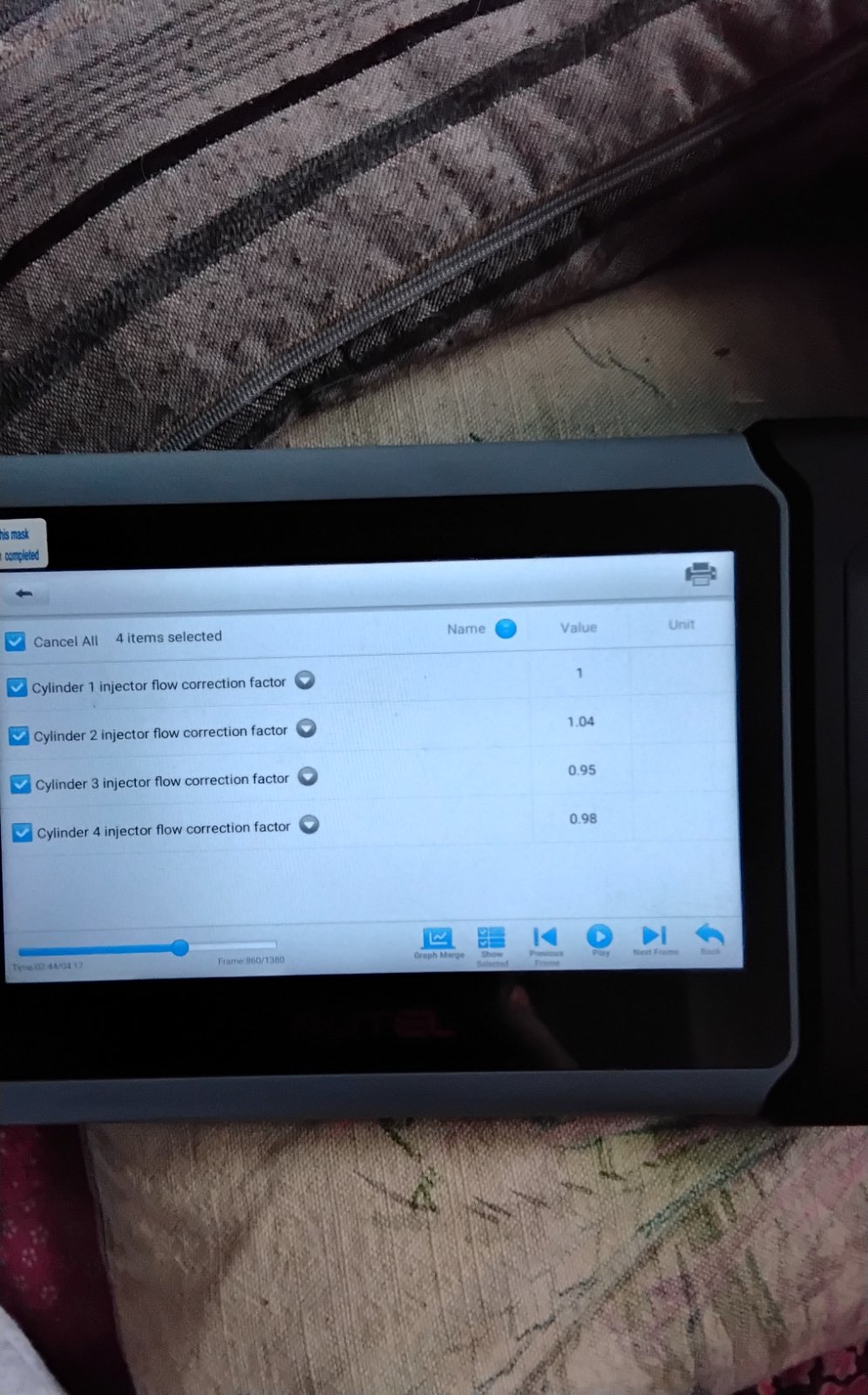

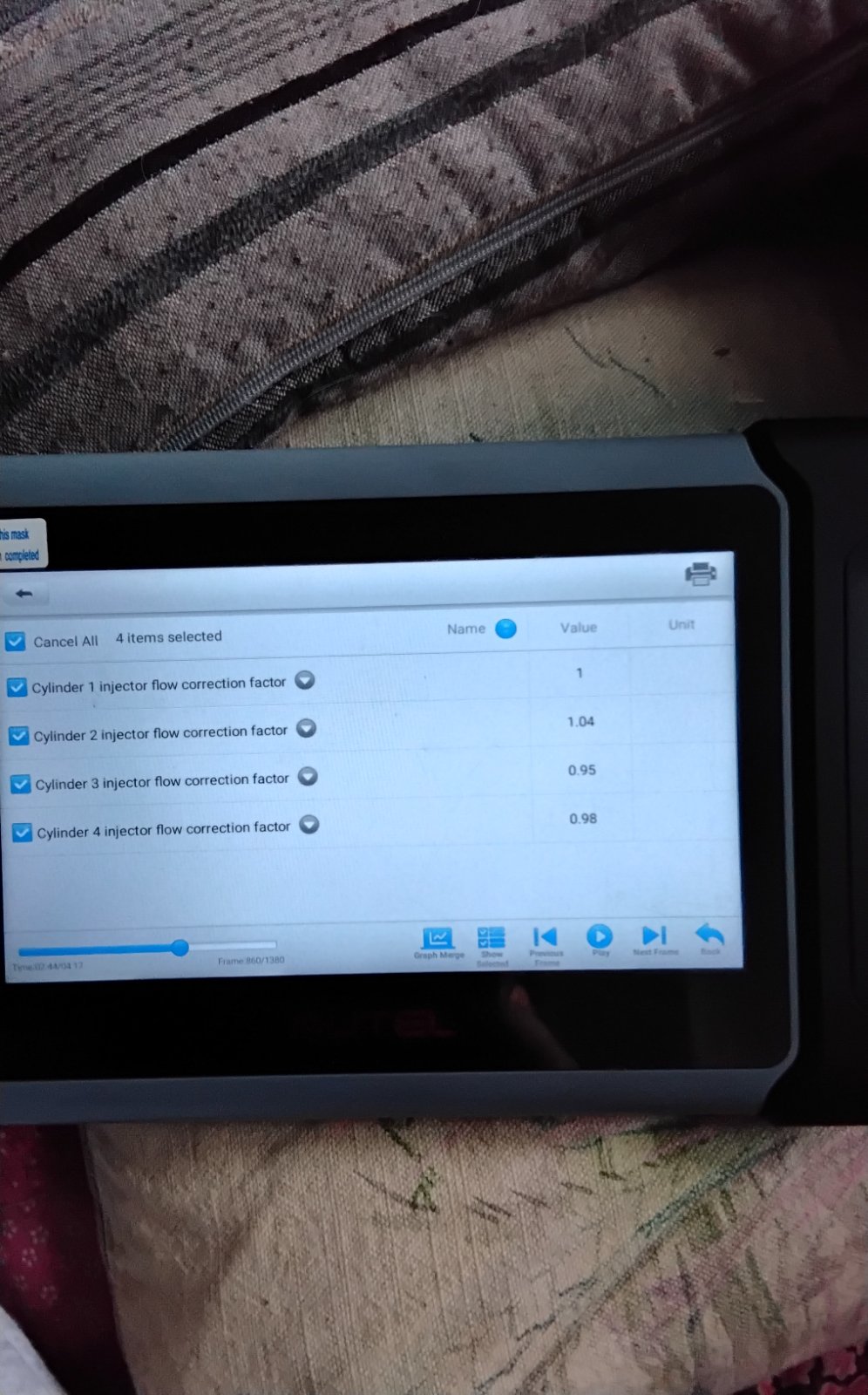

Snap shot taken from live data , when the numbers seem to jump and stay on 1 smoke came out of exhaust white ish , with a smell , rich like unburnt fuel, Battery had to be charged, then car fired into life it was a bit lumpy then settled so all the air is out the system , but the diagnostic picked up on the fuel pressure at first initial start up being to slow & low which I guess is normal when thing have been removed & air gets in .
Just wondering if my injectors are on there way out ?

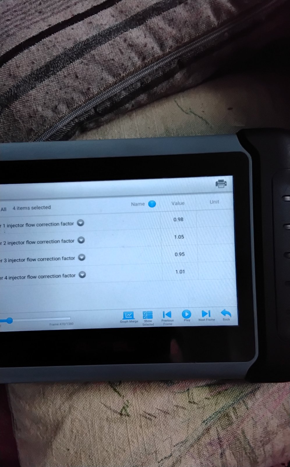

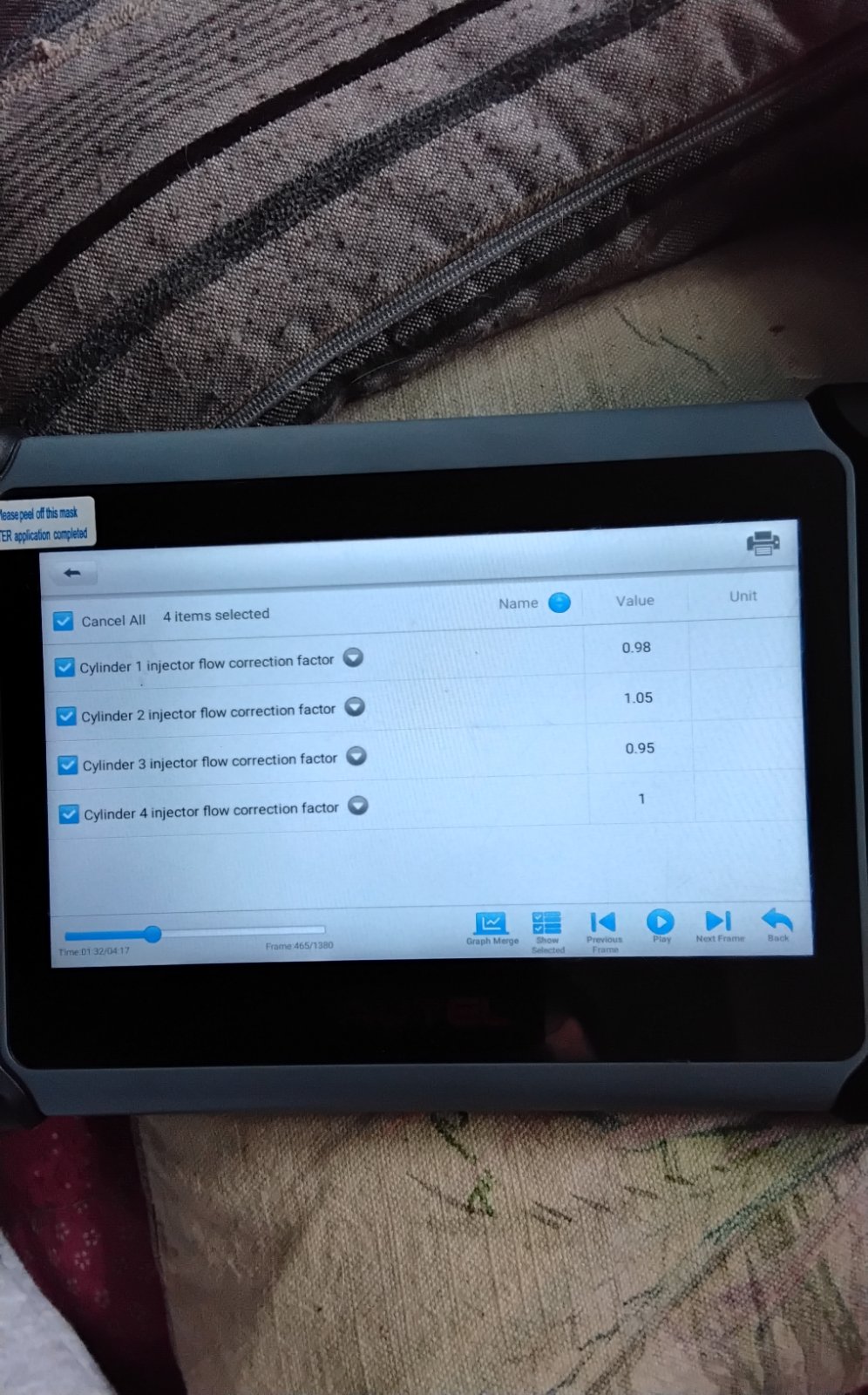

Re: 308cc 1.6hdi injector(s) might need a clean.
Also forgot , when these numbers were 1 and above there was a small shudder then smoke , this then stops once the levels fall below 1.03.
Am I reading this wrong, what should these flow correction factors be

These readings are all fine , for the age of the injectors none of them have any minus numbers , which means overfueling. So im OK with how these rates look.Huskyxantia wrote: 16 Feb 2025, 15:52 Snap shot taken from live data , when the numbers seem to jump and stay on 1 smoke came out of exhaust white ish , with a smell , rich like unburnt fuel, Battery had to be charged, then car fired into life it was a bit lumpy then settled so all the air is out the system , but the diagnostic picked up on the fuel pressure at first initial start up being to slow & low which I guess is normal when thing have been removed & air gets in .
The 1ms injection rate is very good , sports car ......
