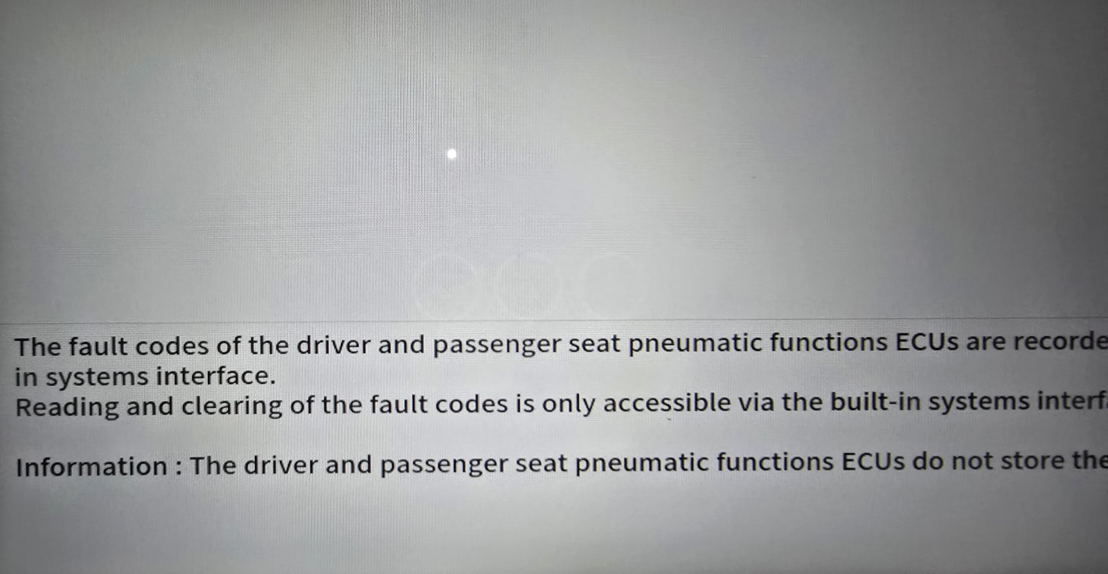

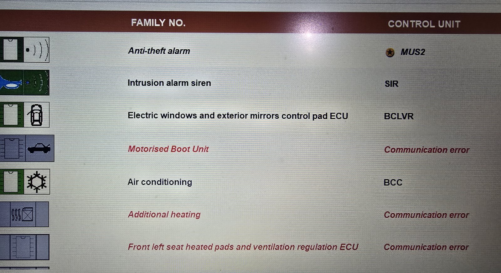

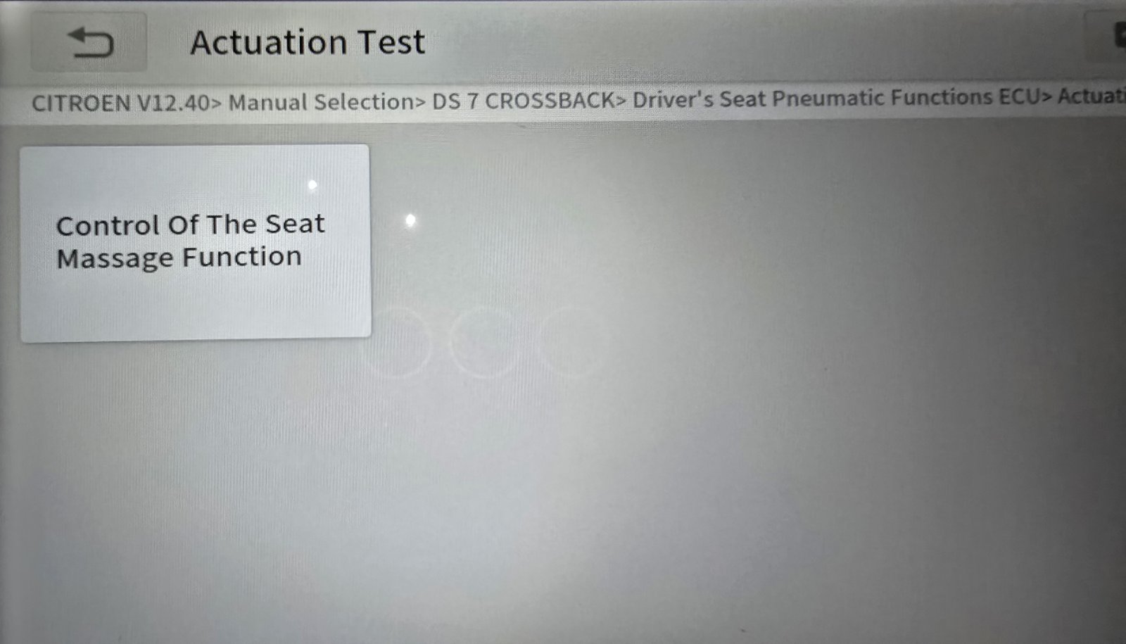

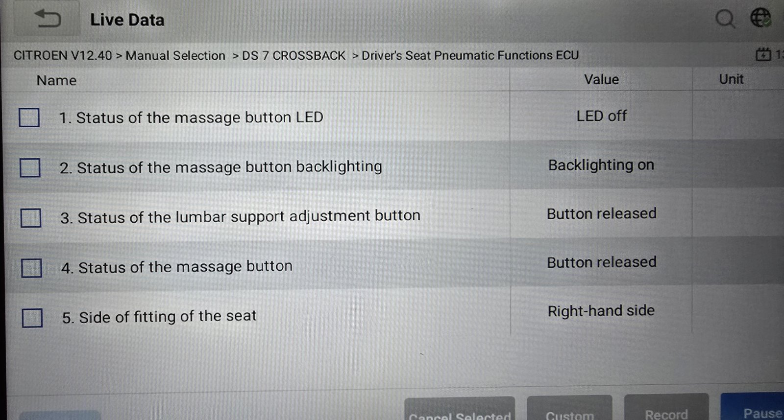

Ok. My laptop refuse to work last night so I did scan using other tool. There is not much option to choose. Only actuator test and live data. If Bsi reset didn't help with the seat/mirror condition it might be a plug underneath seat or anything else. So I am suggesting to go and have a proper diagbox scan to see what's what

All these screenshots are mainly regarding massage function of the seats (pneumatic).

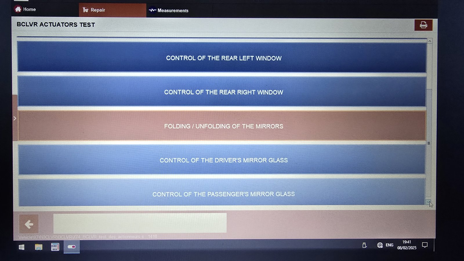

In diagbox electric windows and exterior mirrors control pad ecu you can test mirrors for folding/unfolding and control of mirror glass. In bsi you can configure indexing of mirror when reverse. One more question, option from the touchpanel regarding reversing the seat after ignition on and forwarding the seat when you shutting the door are working?

No problem, my bad))) When you are configuring your bsi thru diagbox program there is an option to set mirror to tilt when reversing (diagbox call it indexing), and fold back when you arming the alarm. You can change bsi settings but Diagbox must have a valid token (or you if you are in main ds dealer the can do it straight away). Checking if your mirrors folding back or mirror glass are working you can do it with version without token. But as I am advising go and check your car for faults. If there is no any faults regarding mirrors/mirror glass you might need to update software of your bsi. Garage should do a screenshots of every option you have stored in bsi and you should have all keys present, otherwise they might have a problems. Diagbox are uploading settings to psa servers, but it is not ideal process and after updating you need to set your own settings ( in my case they delete wireless charger, and I have to record back spare key...)

Do test from my previous post. If the mirrors will work seamlessly doing this test that's mean that signal from bsi to the mirror glass is uninterrupted. If they are not working during reversing that might be that the bsi having problem to send a proper signal hence bsi update (some executive file in bsi program might not working properly - like bad sector in the hard drive in the laptop) If you will have a problem during the test that mirror wont go as they should, I would start looking for a mirror connector. First I would dig out the mirror glass and check connection. If it's all ok then connection to bsi, door joystick pad etc
