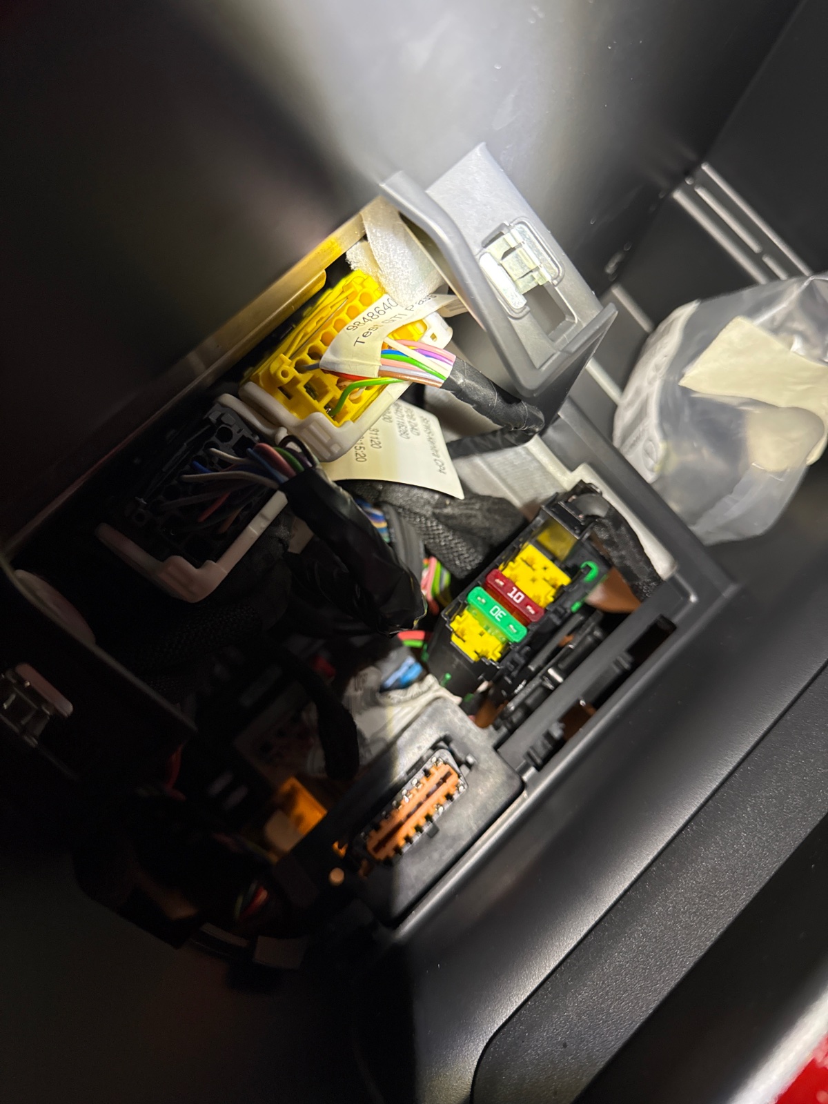

Someone said RAC. I’d assume they would have fuses galore?

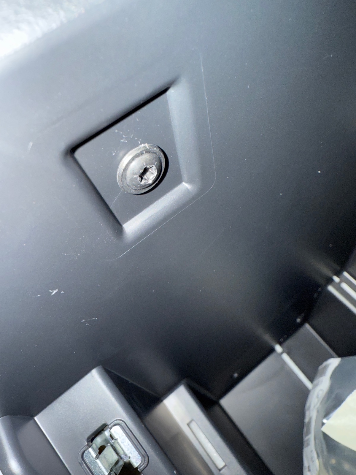

Looking in passenger dash it looks like I need to remove the housing? But what do I need to unscrew? No screw driver or Allen key seems to fit

You need a torx bit to fit that screw, they come in different sizes so best to get a set since your car will have quite a few on it in different places.
