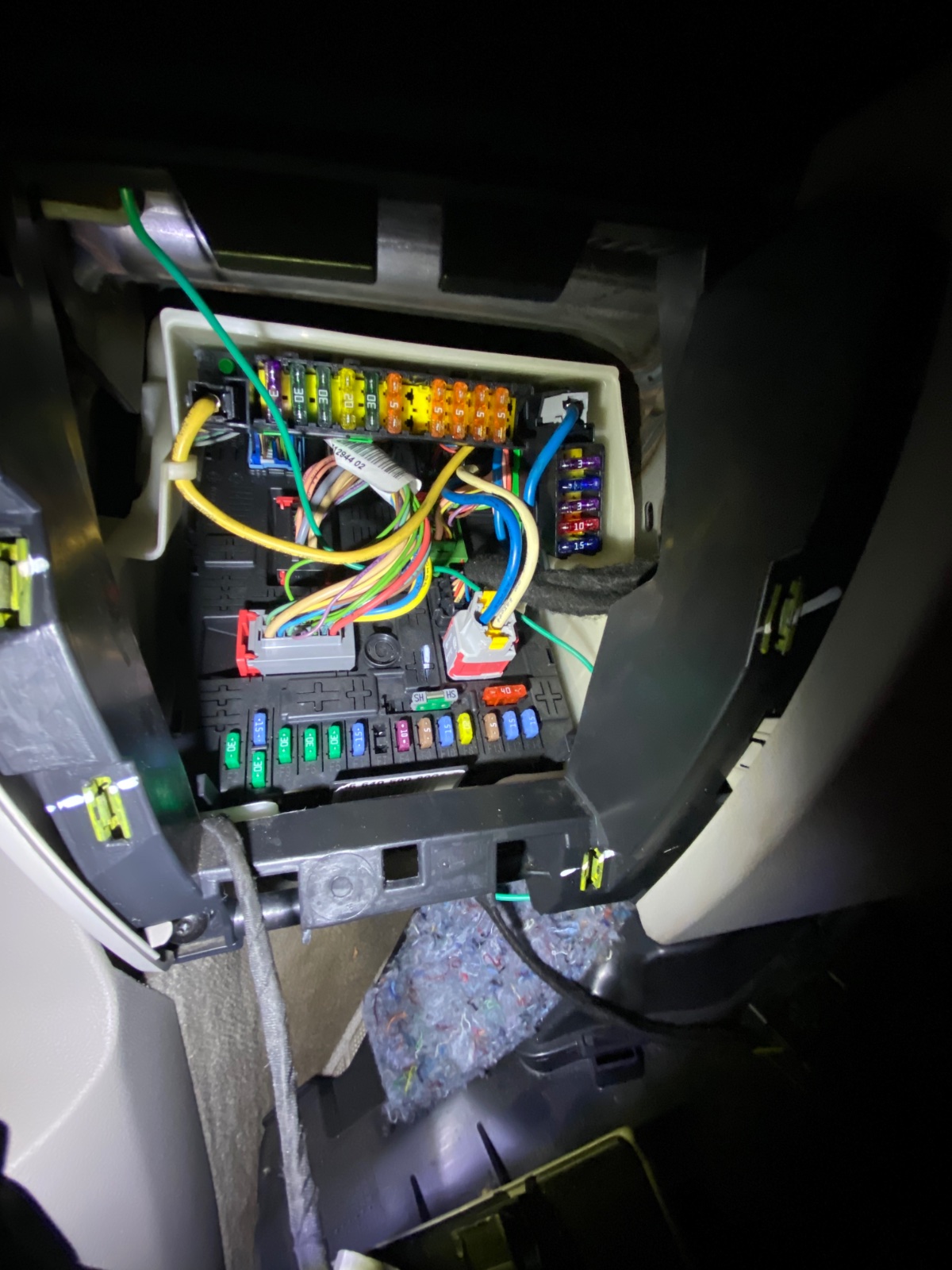

So, I have gone thru the fuses and finds no-one blown. What puzzles me is that I now have three different references of F39 but not one on the plastic.
When I have said that they are good, it is of the hard way by pulling everyone.
From the different pages here on the forum, I identify number 1 and number 4 from the top in the short standing bank "B".
The pic are of my fuses beneath the dashboard.

On the vertical blok, the 10A is the right one.

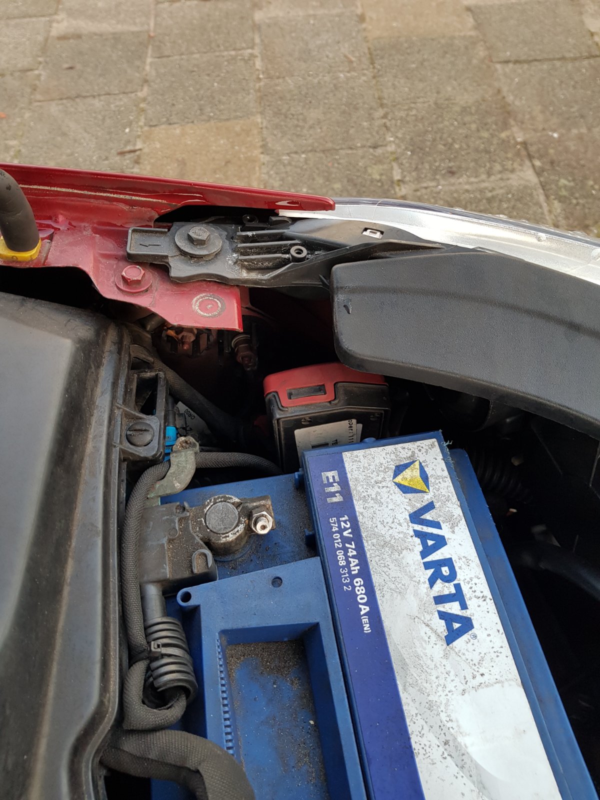

This is a mistake, the other one he means is the 40A fuse in the box near the accu.

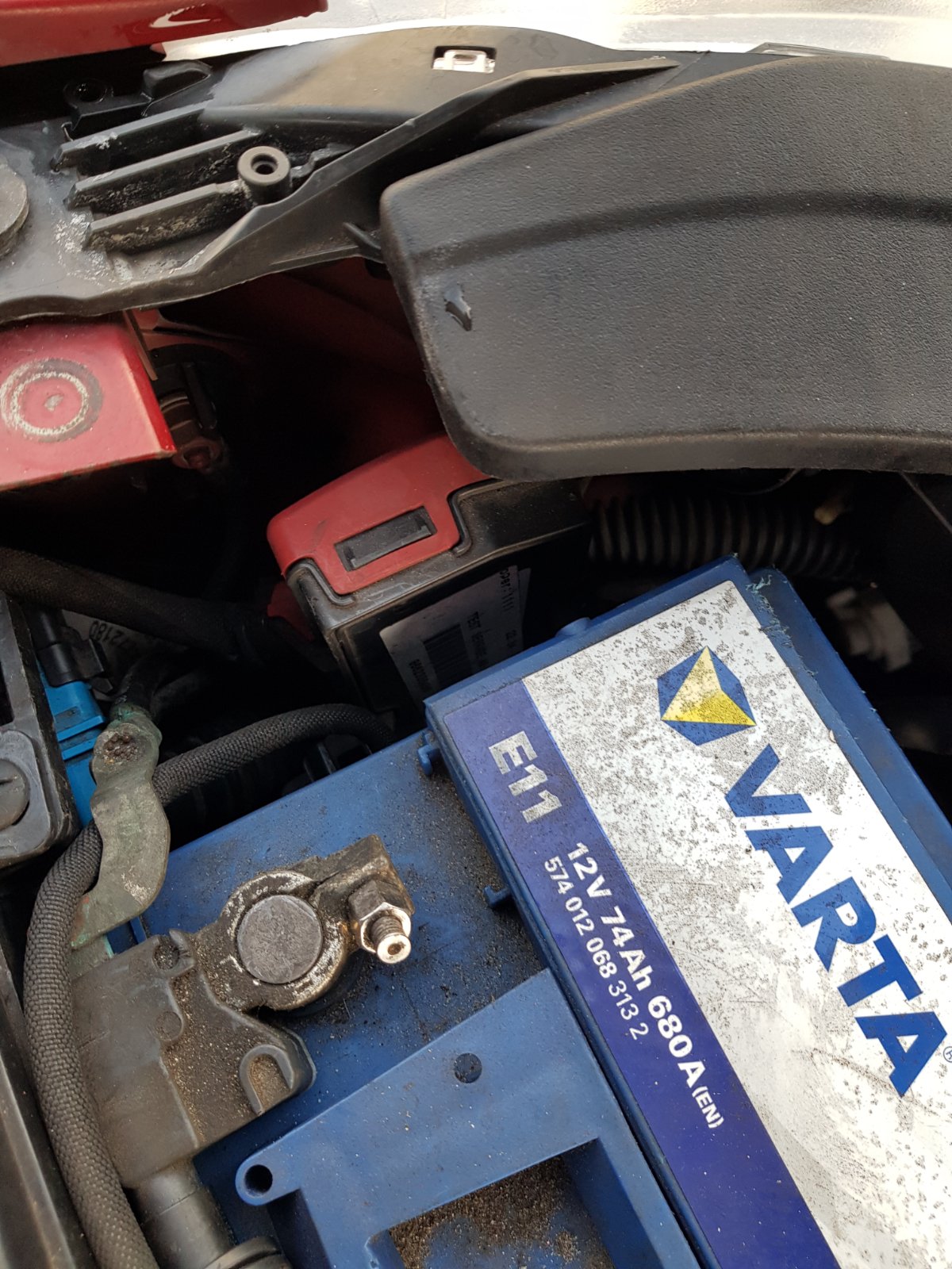

Ok, I'll do so. Can you take a picture of your fusebox so I can try to locate where my loose cables can be fitted?
Kees
- Posts: 603
- Joined: 16 Nov 2021, 16:16
- x 148
Re: BHI replacement
Here you can see the red box, the location is in the left front side behind the left head light.
But remember i have a V6, so if it's not there in your car, send a question about the location in your car to Givemeabreak (Marc) with your vin number he can help you with this.
