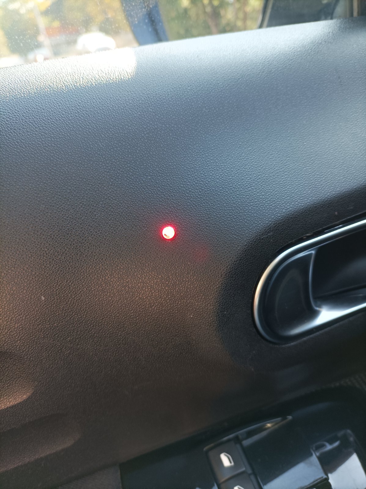

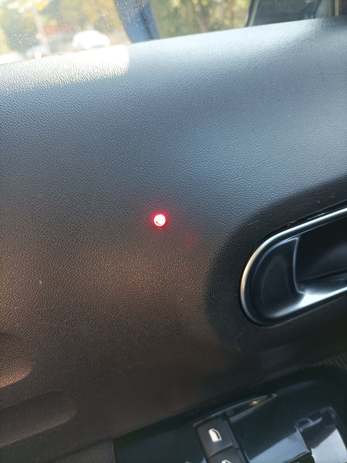

If I may suggest. They use LED 5mm 20mA, color as desired. Since they are LED for a voltage of 1.5 V, they must be used with a resistor of 560 Ohm 1/4 W. There are already preconfigured LEDs with a resistor. Here's an example from Amazon :
https://www.amazon.com/EDGELEC-LED-Ligh ... 10?sr=8-10
I don't know about your location if there is an electronics store where you can buy only 1 piece. Amazon sells 30 pieces.
I installed my diode on the door.

Hi MihaelMihael_M wrote: 20 Dec 2024, 20:12 If I may suggest. They use LED 5mm 20mA, color as desired. Since they are LED for a voltage of 1.5 V, they must be used with a resistor of 560 Ohm 1/4 W. There are already preconfigured LEDs with a resistor. Here's an example from Amazon :
That looks very slick and professional, thank you for the reply. And thanks for the Amazon link. Sadly our local Maplins shop closed a year or two back. I wish we still had Tandy, I'm sure they would've had one. I spent hours in there as a kid.
Now that I know the specification of the LED I'm sure it will be no trouble to find one somewhere.
Thanks again..
