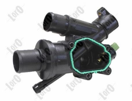

Re: I am stuck 😔
Unread post by LedZep »
So this is a different kind thermostat from the one that you saw in video.These torque specs are for DW10FC engine which is newer version from yours.I believe that they have same or similar torque specs but this is a guess.I would tighten bolts in these torque specs and then by feel close to diameter bolt torque and i think you will be ok.This must be your thermostat i suppose.
amazighman
Posts: 58
Joined: 27 Oct 2024, 17:27
x 1
Re: I am stuck 😔
Unread post by amazighman »
Yes that is the thermostat I have.
I found a manual stating 8nm for all the bolts and nuts... 4nm for the studs themselves.
