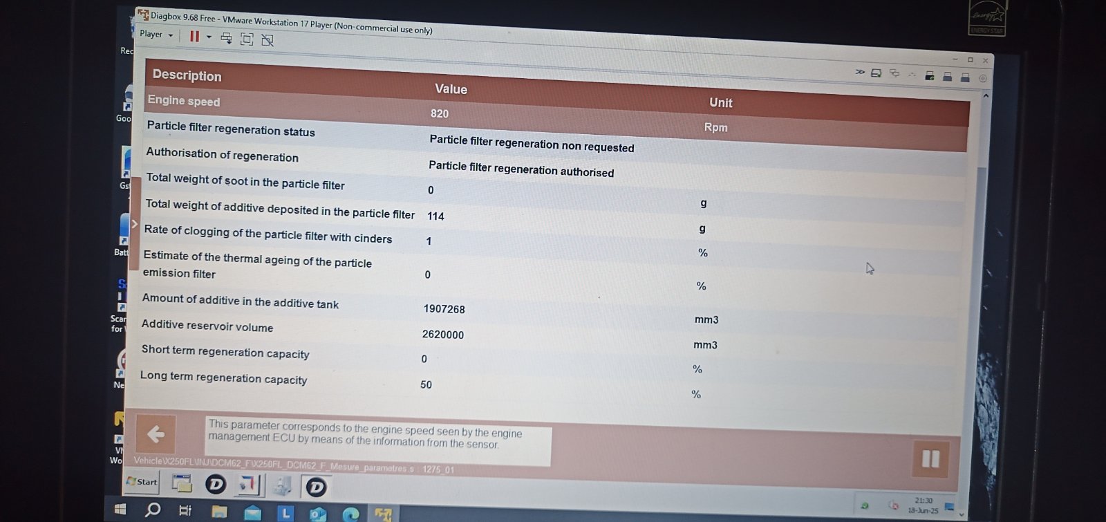

The DPF is still into configuration i guess because I saw different numbers for soot grams and additive inside DPF and I could reset those numbers to zero with Diagbox. If the differential pressure will start to rise with the new filter, and alsoo soot estimates, I guess I'll soon notice the regenerations.

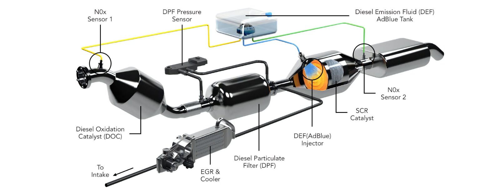

This popped up today, it's an advert but might be useful.

This DW10FU engine has no Low EGR. But the crystallization and deposits are a real issue.
Edit: I see in the image that SCR is pictured after the DPF . I guess it is specific to the Low pressure EGR configuration, in my engine they are reversed, SCR is in front of DPF.

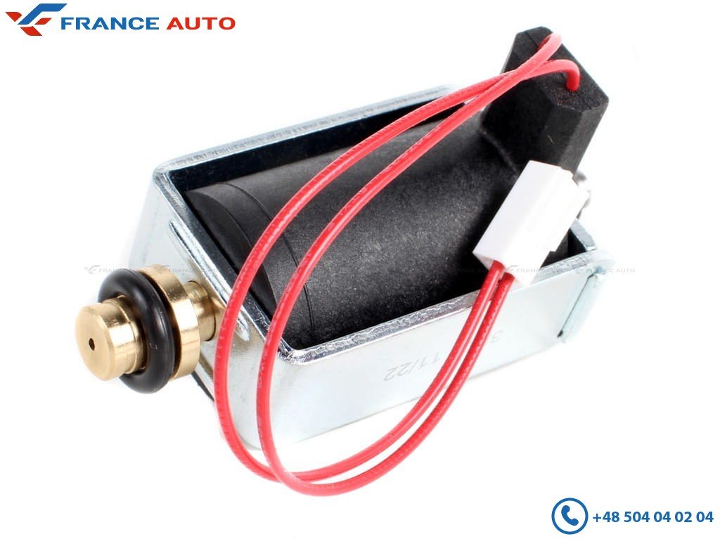

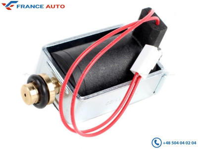

This morning I dsimantle the Eolys pump, was completely stuck. The solenoid pump itself was rusty, water was there. Soak it in WD40 and shock it with a hammer from both sides and now it's ticking but for the flow test there was something more like 5 ml. Might have to get another one.
It looks like this: In my case there is no board, the pump is controlled directly from the ECU (on the connector there is ignition 12V and command to ground).
