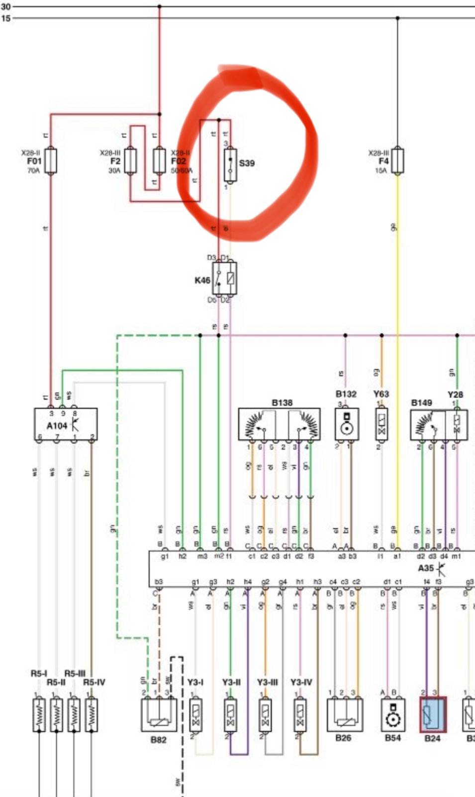

Where is s39 fuel cut off switch located on the wiring diagram
wheeler wrote: 24 Aug 2024, 22:56 B24 is the CTS
wheeler
Posts: 7910
Joined: 21 Sep 2002, 19:07
x 1052
Re: Wiring diagram
Unread post by wheeler »
Right here
