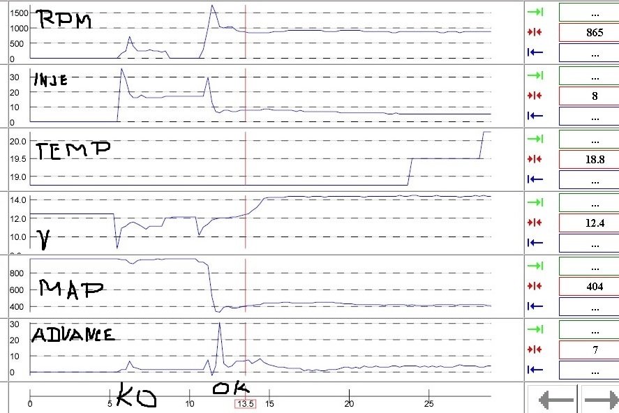

2. What the graphs showed
In the older graph:
Unsuccessful start
• ECU sees rpm.
• ECU counts injection.
• engine does not start.
Second start
• practically the same conditions.
• engine runs immediately.
This means:
The ECU is not "dead" during the first start.
It works:
• senses the crank,
• counts injection,
• controls the start.
________________________________________
In the older graph:
Unsuccessful start
• ECU sees rpm.
Second start
This means:
It works:
• senses the crank,
• counts injection,

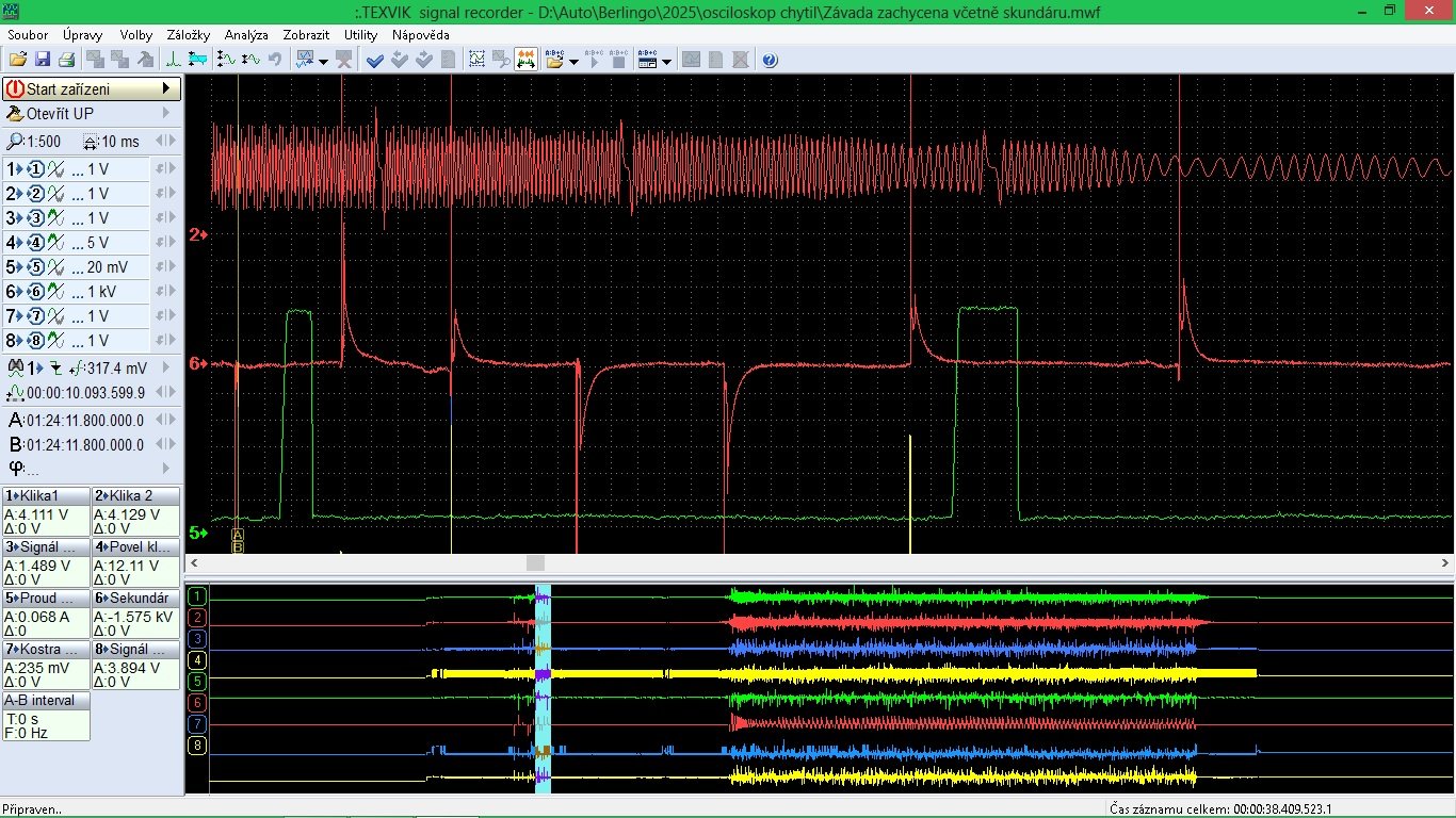

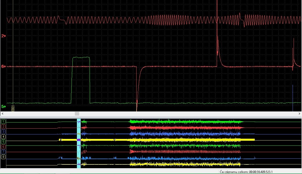

Re: NFU engine no start
oscillogram failed start
up speed then spark and then injection of the first cylinder....why does it ignite and inject so strangely as if the synchronization is broken? what is the cause?

Could this be a defect in the Bosch ME7.4.5 ECU itself (for example, in the part of starting dose control, synchronization, internal adaptations or another circuit that does not trigger an error code), or is this type of defect known for ME7.4.5?
Can I send an oscillogram from Texvik, Please read carefully and analyze the text. I will add any necessary information if needed.
Thank you
Control unit: Bosch ME7.4.5
Fuel: petrol + LPG STAG (the fault is also manifested when the LPG is physically and electrically disconnected)
DESCRIPTION OF THE FAULT
The engine has been showing a very specific starting fault for a long time (approx. 4 years).
Symptoms:
· at outside temperatures of approximately 10–15 °C (spring, summer, autumn) the engine usually does not start on the first attempt after a long standstill
· at temperatures around 0 °C and in frost, it starts normally
· a hot engine starts normally
· if the engine has been stopped for only about 30 minutes, the start is usually normal
· the fault is reliably manifested after several hours of standing or during the first morning start
Procedure of the fault:
· the engine does not start at the first start, the second start immediately
· it usually does not start even after a longer start (about 5–8 seconds)
· after the first attempt, the engine usually starts immediately
· after starting it runs completely normally
· there are no problems while driving
· engine performance is normal
· emissions are flawless
· long adaptation plus minus 4 percent, short-term plus minus 14 percent
DIAGNOSTICS
· no errors are stored in the ECU faults
· fuel pressure OK
· sensor values ??in diagnostics correspond to reality
· engine temperature displayed correctly
· MAP sensor replaced without change
· crankshaft sensor replaced without change
· ignition coil replaced without change
· spark plugs replaced without change
· injectors replaced without change
· fuel pump replaced without change
· throttle valve replaced without change
COMPRESSION PRESSURES
14 – 14.5 – 14 – 14 bar
ENGINE AFTER START
· runs regularly
· no misfiring
· no smoke
· no error codes
ECU SOFTWARE
· verified at an authorized Citroën service
· ECU software corresponds to the vehicle
· no newer software version available
· calibration was checked and confirmed as correct
INTERESTING NOTES
1. After clearing the ECU autoadaptation, the engine at least once after a whole day of standing, it started immediately on the first try.
2. After the subsequent drive and re-learning of the adaptations, the fault returned the next day.
3. After deleting the adaptations, the engine's behavior was subjectively noticeable.
4. Emergency start on LPG was successful at least once even in conditions where gasoline start normally fails.
5.
OSCILOGRAMS
Oscillograms were taken:
· crankshaft sensor
· ignition coil primary
· ignition secondary
· cylinder injector no. 1
· MAP sensor
· battery voltage
· fuel pump control
In case of unsuccessful start:
· ECU sees engine speed
· injectors are controlled
· ignition system creates a spark
· fuel pump runs
· no crankshaft signal drops are noticeable
QUESTION
Thank you

J'ai essayé le spray de démarrage, sans succès. Elle ne démarre qu'au deuxième essai. Voici le graphique PP2000 en fonction du régime moteur : 1er démarrage : échec, 2e : démarrage correct… Que dois-je mesurer si le démarrage échoue ?
Autre photo de l'oscilloscope de vitesse : première injection, deuxième injection…
Peut-être que ça fait tic-tac et que ça s'allume au mauvais moment ?

I did some simulations and I need information, how much exactly does the NFU engine with the ME745 ecu give at start the injection duration in ms? At a temperature of e.g. 15, 20, 25 degrees? Preferably a graph of the first start e.g. in PP2000. Thank you very much
soundlovers
- Posts: 24
- Joined: 15 Aug 2024, 13:10
- x 2
Hello, I did another measurement and I need to compare the injection duration at start. Question: how many ms is the injection duration at start (only at start) for this engine?
