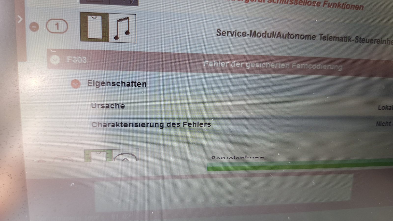

Sorry i have upload 1 picture 2 Times.
This is link for F303
https://ibb.co/fDWCfbr

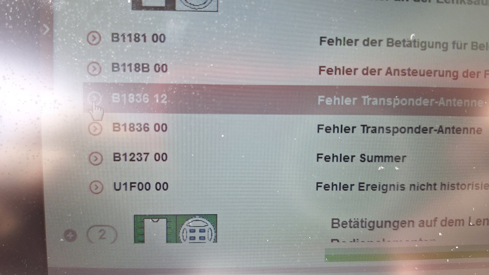

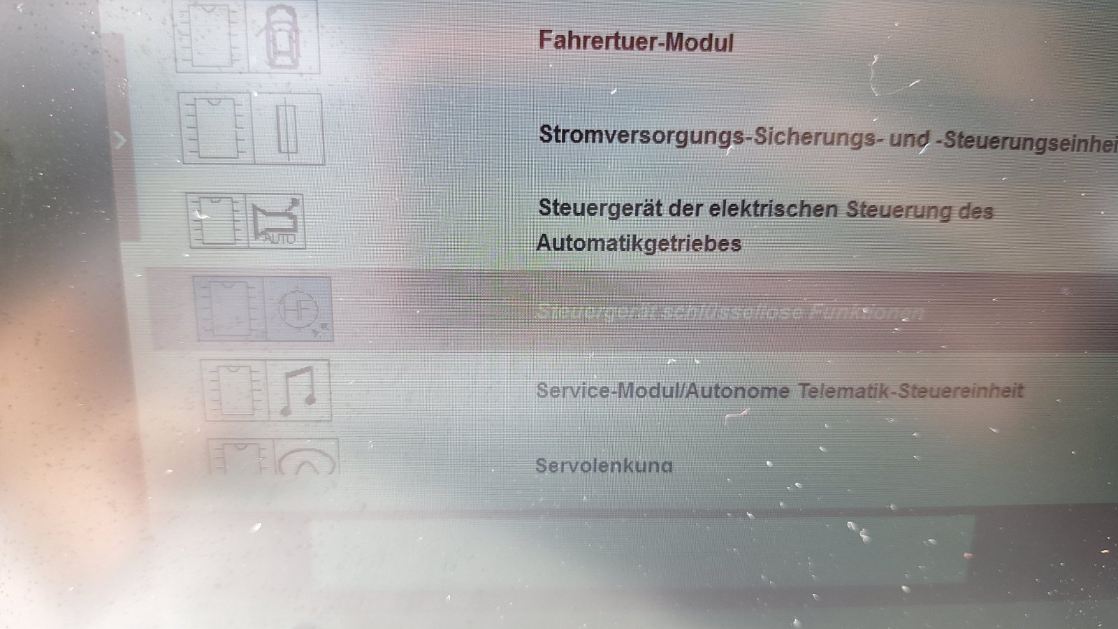

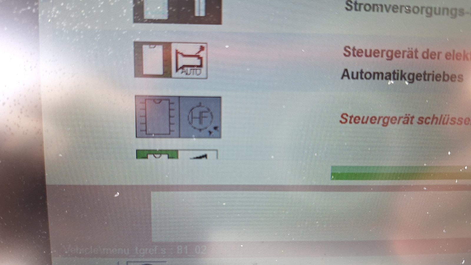

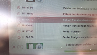

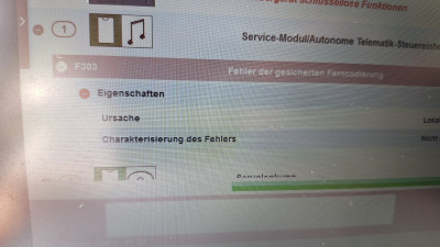

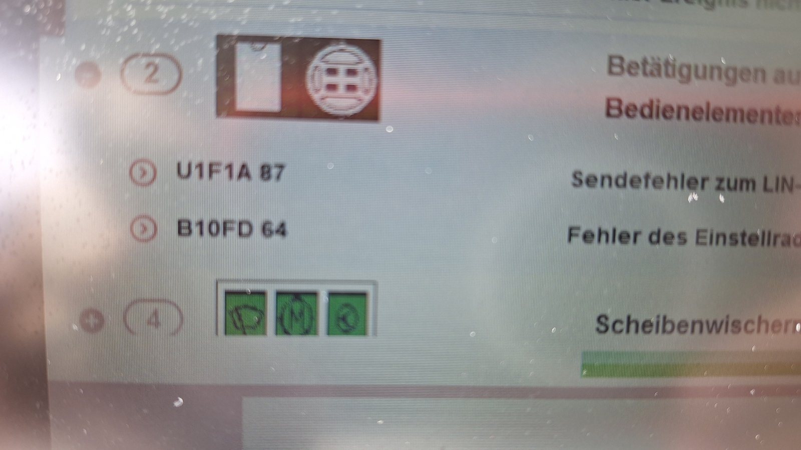

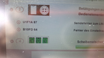

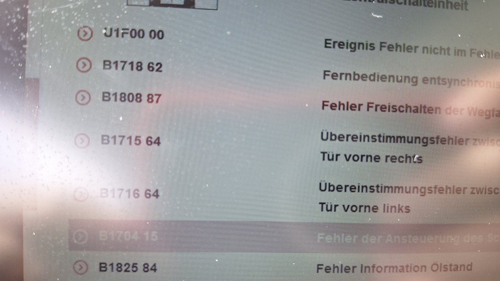

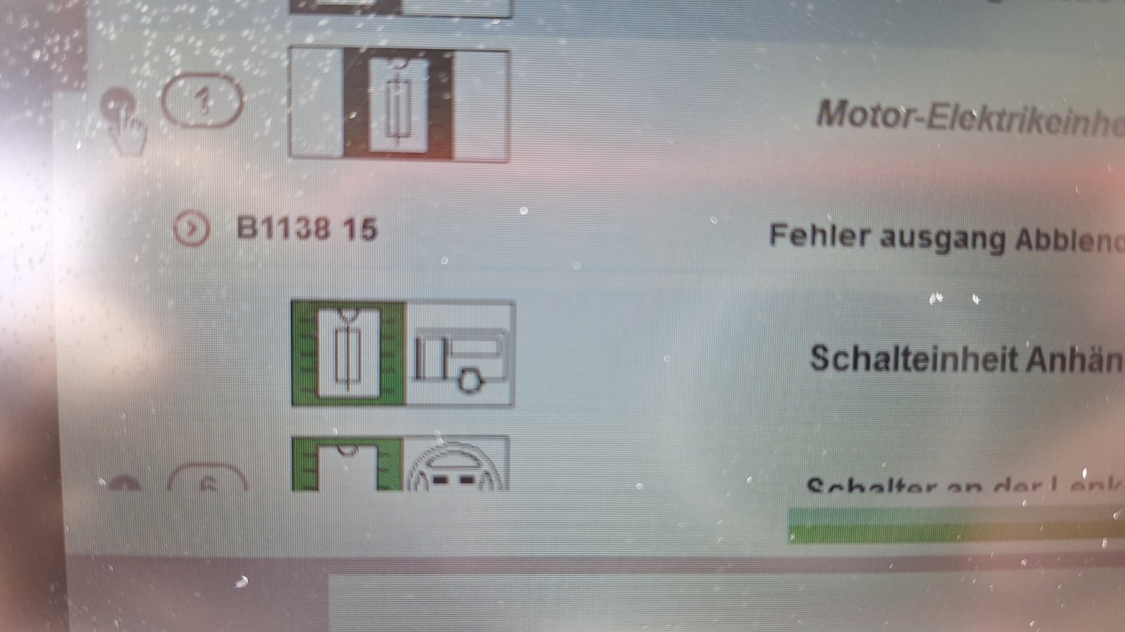

Im tryin to enable keyless... :( what can you see in the pictures?
GOOGLE TRANSLATE
x 6946
Re: Keyless not work
Ok, I'm sorry but I really can't help you with these faults - you have a multitude of system failures and I suspect there may ne a mis-configuration of the BSI here or electrical failure for this number of system faults.
I don't have time to go into all these - as I think there is little point if it's a configuration error. You really need to get it to Citroen and let them run a proper full diagnostic as this is really beyond the scope of the Forum to deal with.

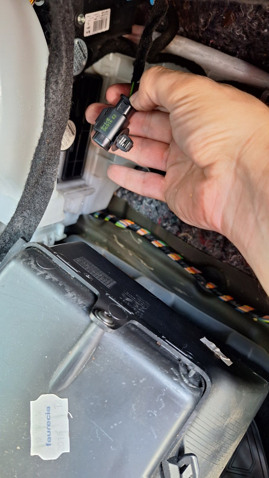

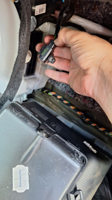

Unread post by GORAX »
When I changed the cabin filter, I found a slot
behind the glove compartment which was empty. In the video I used as instructions, the slot was connected to an antenna. Can this be a keyless go antenna?
