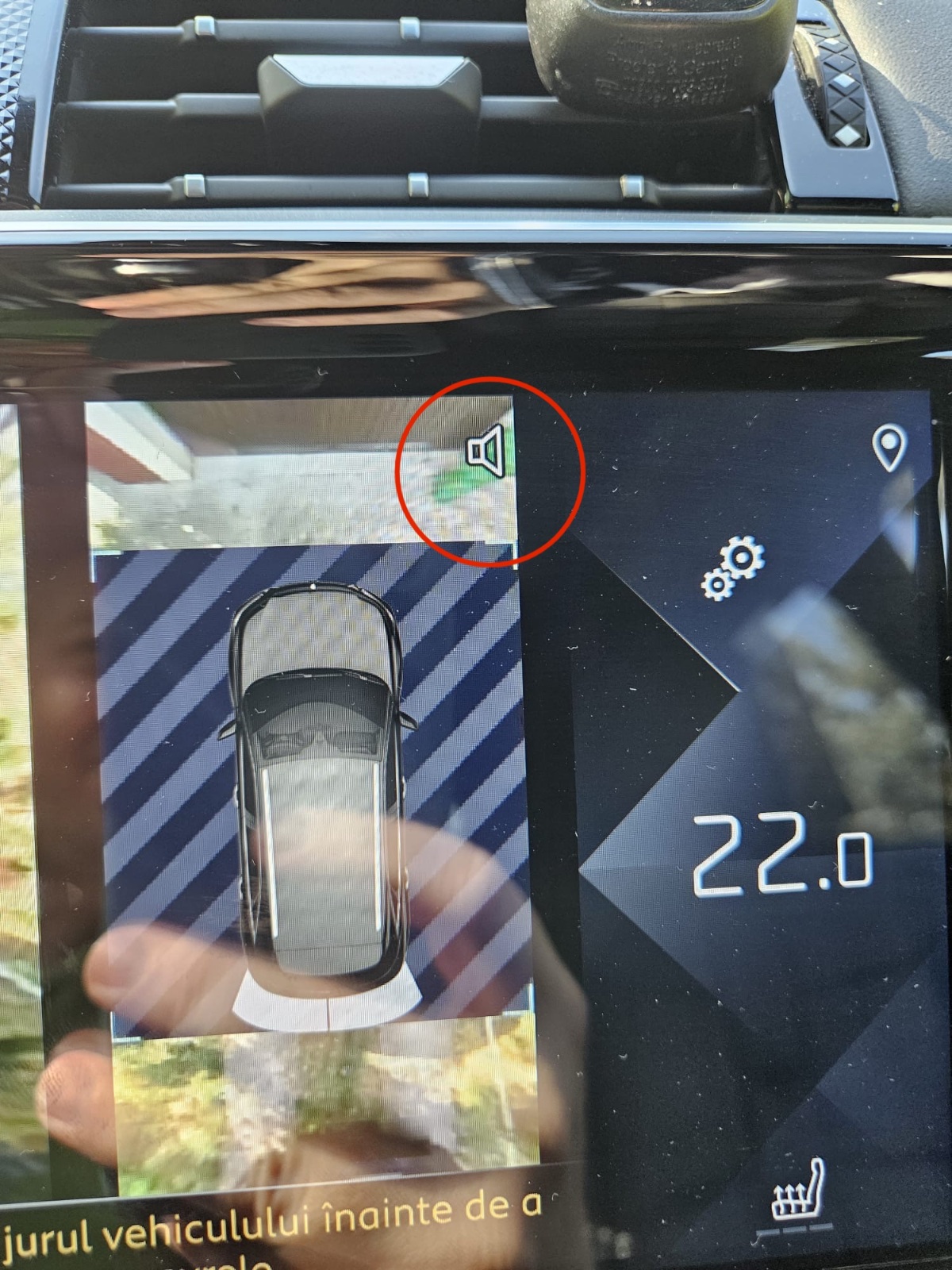

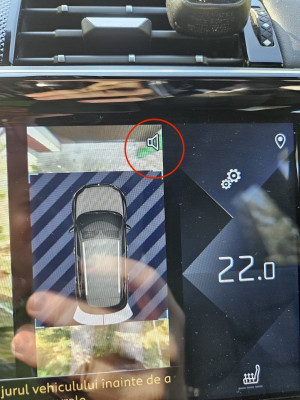

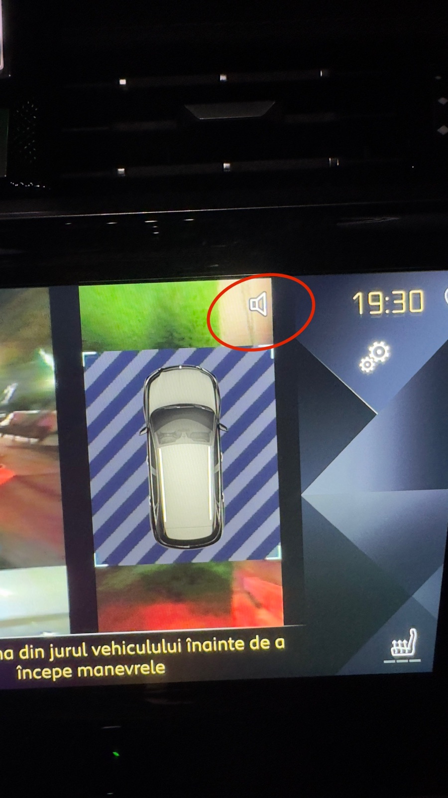

The problem that I have with my car is that the volume of the parking sensors is low and I have seen that on some models you can make the volume higher, but it doesn't work for me because I don't have that speaker where I can adjust the volume of the parking sensors.
I attach the picture for info.
Thanks for your reply and I appreciate your involvement.

Re: Original Diagbox with token login issue (explained)
Hi
On some connected NAV vehicles this speaker icon appeared and according to the manuals it could be used to adjust the speaker volume of the parking assistance beeps, but I should tell you that many who did have the speaker icon found it never actually worked - so I think this may of been one of those things that they put into the manual but never functioned.
I have connected Navigation, but there is no speaker icon either, and turning the speaker volume (round button on Head Unit or steering wheel volume buttons) has no effect - it just raises the volume of the media source.
Of course, the system is designed to increase the volume as an object gets nearer, but I can't see anywhere to configure or change this.
I am only aware that on some very old units from 2006 this could be done using Lexia - but there is nothing I can see on later equipment to do this using Diagbox.
If it is possible, it may be a dealer-only function that may require some change in the Head Unit configuration that is locked out from normal diagnostic configuration. I have checked the BSIs for some later vehicles and I can't see any function for this in there.
On all the cars that have this icon the volume works
I don't understand why some cars have it and others don't
although they have the same configuration.
Just so you don't misunderstand what I said - I know owners who have this speaker icon when reversing, but it actually does nothing when pressed. Even though it says the volume can be adjusted in the manual, they have tried it and again, nothing. It's quite possible they have removed it in later firmware updates for this reason - but they are very lazy updating the owner manuals - some they can't be bothered to update even when the telematics system has a new interface - everything in the manual is totally out of date and no longer relevant in the instructions in many areas. Would cost too much to update it I guess
