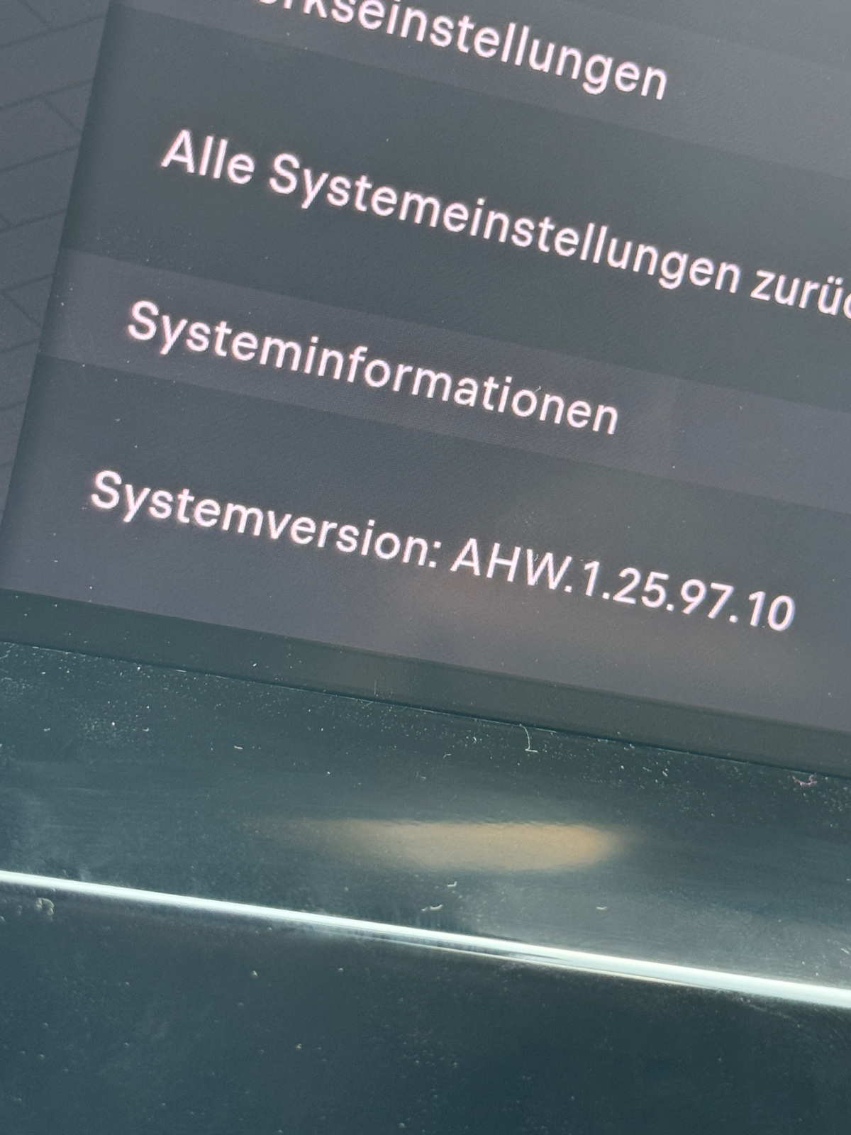

Hi, here is an update: They installed the new ecu for the infotainment system on Monday, it has a new firmware on it and they told me everything should be fixed by this.
What I noticed so far is that I can now see the navigation instruction on the HUD when I use Apple Maps via CarPlay. It still not working with the stock navigation system and google maps. Also I noticed that my Parking cameras on front and back sometimes are not working, what makes me really mad because it worked perfectly before… I hope the main problem is fixed, so the displays and systems won’t turn off randomly while driving or starting the engine…. I’ll keep you updated when any more problems occur or not.

Good news on that front, but if you're still having issues with other systems like the parking assistance, then take it back - something is still not correct and you need to make use of the warranty while you have it.
