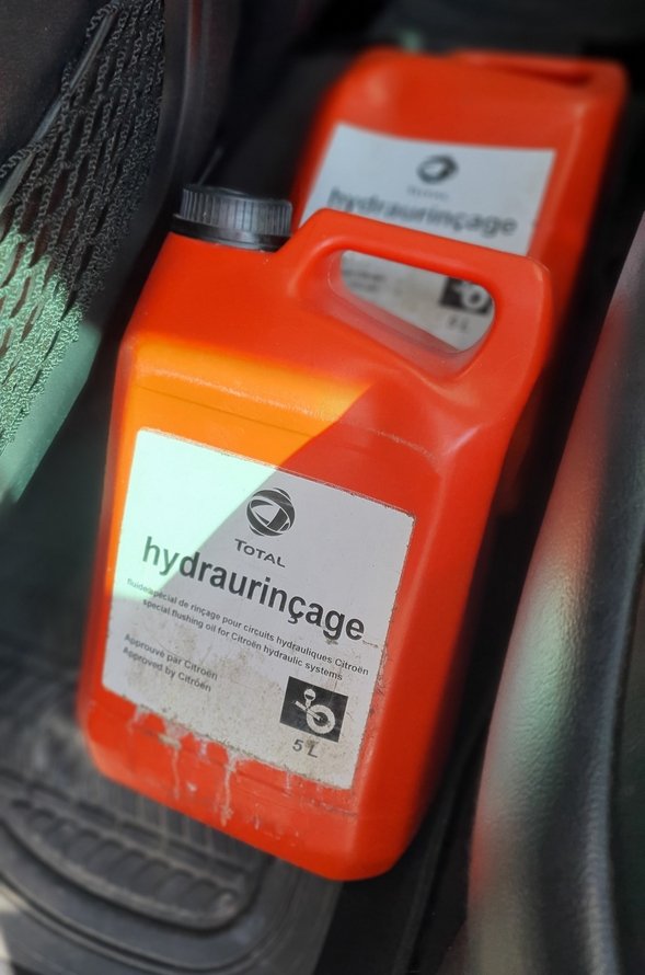

However i was wanting to change LHM when i remembered of the old Hydraurinçage , and i think i found the last 2 of them for sale in Portugal (So i got them immediately)
I used it before in a Xantia, but however i have one doubt: As the car will not be used for quite a while, would it harm the circuit to let it inside for longer time? With my lack of time it will be a few months until being able to do 1000 or 1500km... The Activa is currently without LHM, so id prefer to put some fluid after clean the filters.
Whats your thoughts on that?

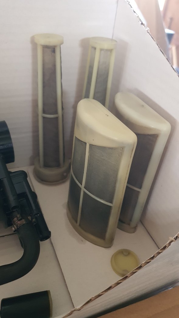

Filters (almost) clean.
Need to give a final passage with brake cleaner (Thought i had more but ended in middle of process) Yes. I have several sets of filters , that way next time i'll change them instead of cleaning immediately to make the process quicker.

I am confident that leaving the Hydraurinçage in the system for a few months will do no harm. In any case, the 2 litres that you have won't fill the system - it'll take 4 or 5 litres. So if the other 2 - 3 litres are LHM you should have nothing to worry about.yoseff wrote: 22 Aug 2024, 14:03 Not much time available for now (Summer) , so not much have i done on the Activa.

That's actually 2 x 5 liters , so i plan to fill the system with Hydraurinçage. I definitely trust more in this solution than an home brew oneArmidillo wrote: 23 Aug 2024, 00:31I am confident that leaving the Hydraurinçage in the system for a few months will do no harm. In any case, the 2 litres that you have won't fill the system - it'll take 4 or 5 litres. So if the other 2 - 3 litres are LHM you should have nothing to worry about.yoseff wrote: 22 Aug 2024, 14:03 Not much time available for now (Summer) , so not much have i done on the Activa.

My Activa is also doing that (rear falls after turning off engine), and i plan to manually clean the anti sink valves, height correctors and electrovalves. The goal of the flush is more other areas where is harder to reach by disassembling.

Indeed, it can stay in for an extended period and in fact, if not too manky when drained to refill with LHM, after passing through a fine filter - an old-school coffee filter perhaps - it can be re-used...

Your replys assured me , so today having a bit of morning free time , decided to put the Hydraflush on the system , with clean filters , and also put a new tube on the aspiration side of the pump. (Transparent)
A few workout with the suspension , and after a while that behavior that the rear would literally fall when turning off engine stops and rear, that was solid as a rock even on normal position, is now moving on a much smoother way.
This Hydro Carnage is powerful stuff
Cant wait to try it on the road.

That's good and you should notice a big improvement when you drive it!
