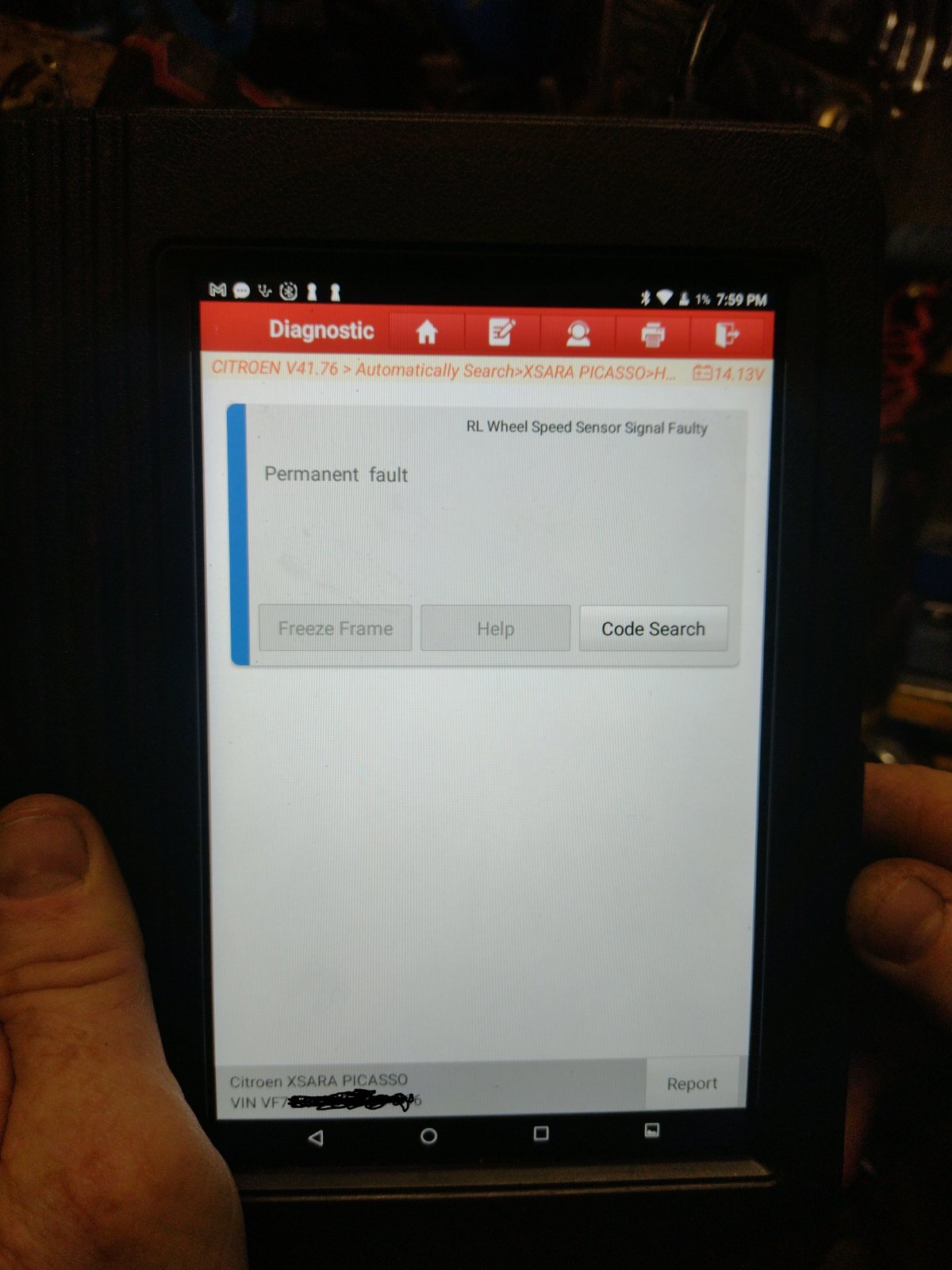

The error on Launch diagnostic scan tool was "RL Wheel Speed Sensor Signal Faulty" "Permanent Fault" no code number listed. cleared all fault codes , but fault returns.
Yes GiveMeABreak , ABS light does come on temporarily with ignition, on , then it goes off. but after a few seconds without even starting the car or moving the car, the error light comes back on again.

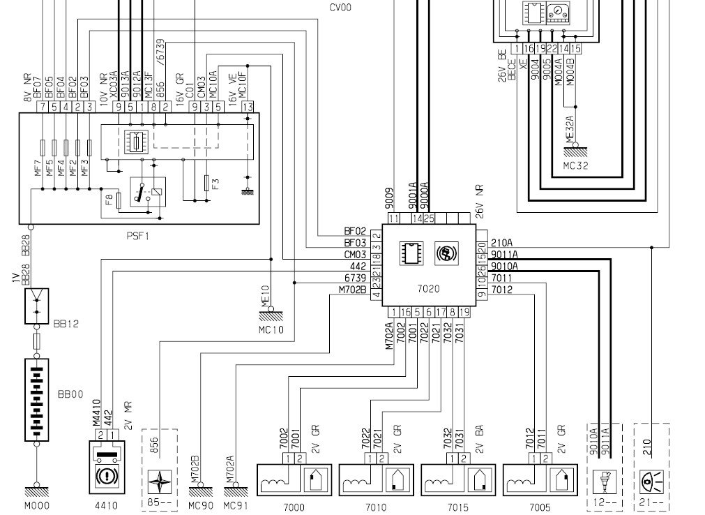

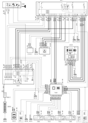

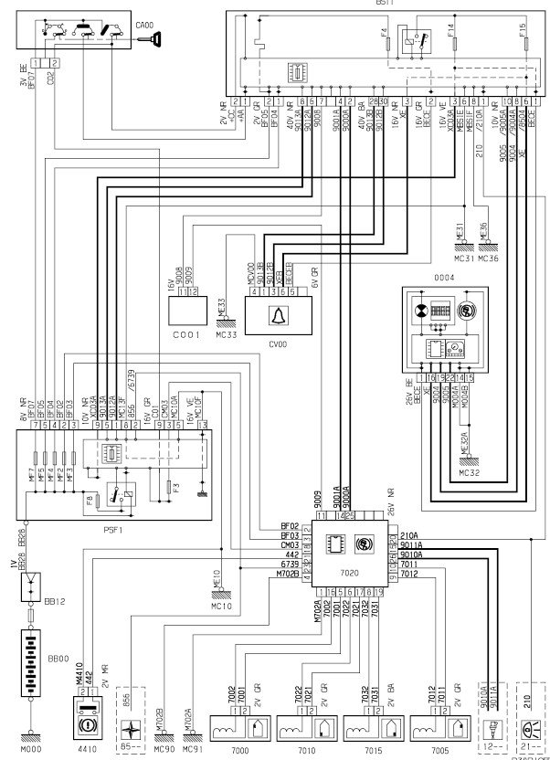

Can anybody help with a wiring diagram for the ABS sensor system on a 2007 Citron Xsara Picasso .
VIN Number ; VF7**************[VIN obfuscated, can be read by forum staff]
Thanks for reading . Tony
wheeler
- Posts: 7927
- Joined: 21 Sep 2002, 19:07
- x 1056
Re: ABS light 'No function' but no ECU fault code, how clear? BSI?
This is a diagram for a model without ESP

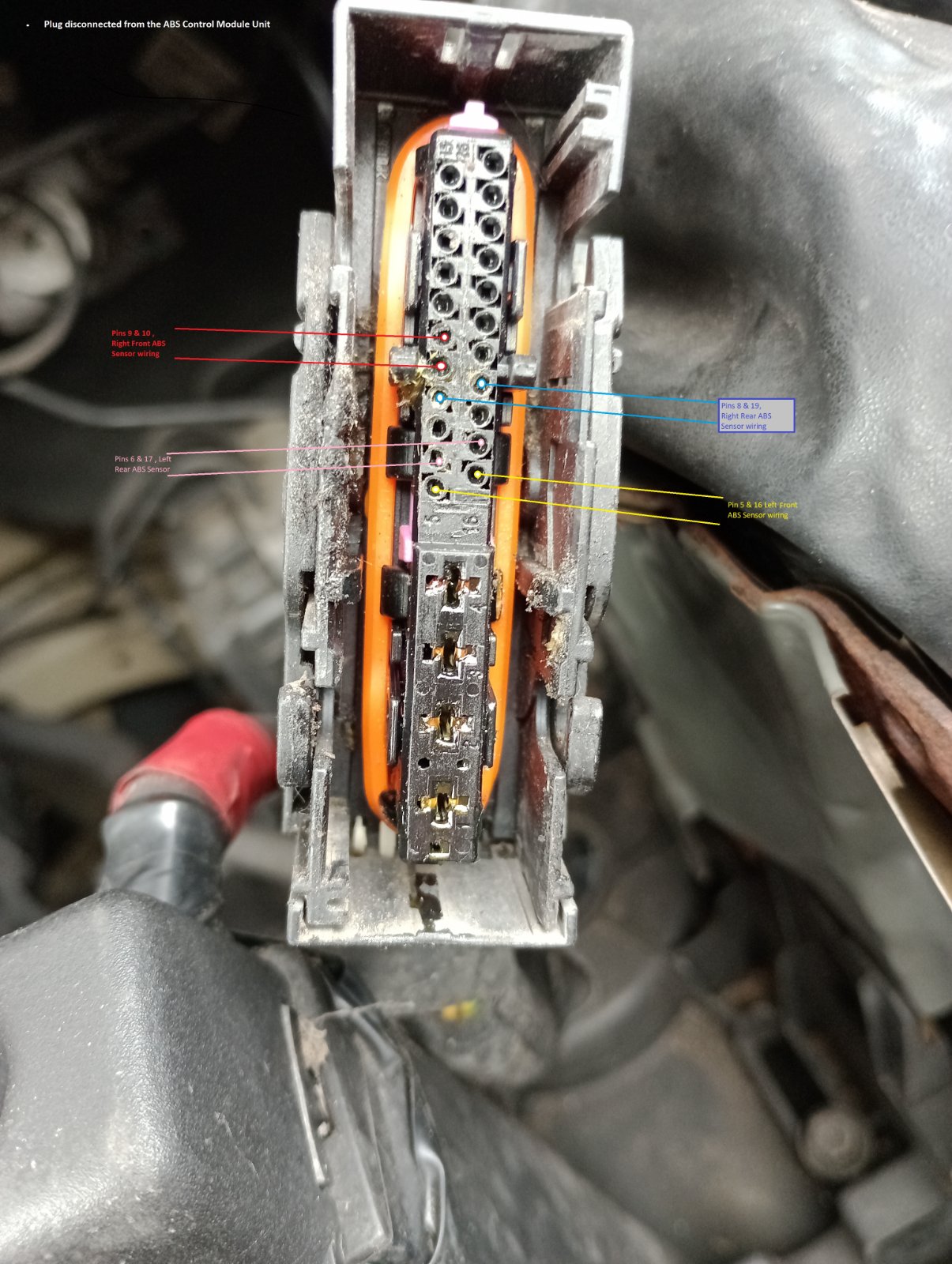

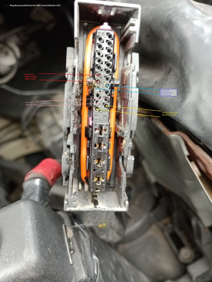

My report after testing the wiring .
I unplugged the large connector on the side of the ABS Control Module unit.
Using a multi-meter I measured the resistance of each Sensor on the pins indicated in the wiring diagram supplied above .
all sensors indicated various Resistance readings except the Front Right Sensor on pins 9 & 10 . This was reading Open Circuit.
I Confirmed that the wiring in the loom to this sensor was ok by unplugging the right front sensor and putting a short wire across the socket pins where the sensor connects to the loom . this was confirmed with a multi-meter on the pins 9 & 10 on the Control module plug.
So I have now ordered a new front Left ABS Sensor, I should have it onMonday.
Thanks again for all your input, This is a great Forum.
The Launch Diagnostic unit had indicated that it was the RL Speed sensor that was faulty and this threw me on a wrong diagnosis of where to look .
