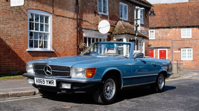

That'll be interesting to see what that does (or doesn't) go for later this evening. I look at those R107 as perfect for slowly driving around enjoying the experience and the surroundings - not for frantic driving, but for driving for pleasure.

In case you missed it that car sold for £23.5k plus fees
- Posts: 6847
- x 3565
Re: Crank, no start....
Jeez ! It did seem to be a relatively good order though. I wouldn't be surprised if the buyer's plan is to own and enjoy it for a year and then this time next year sell it for roughly the same amount and then start the process all over again

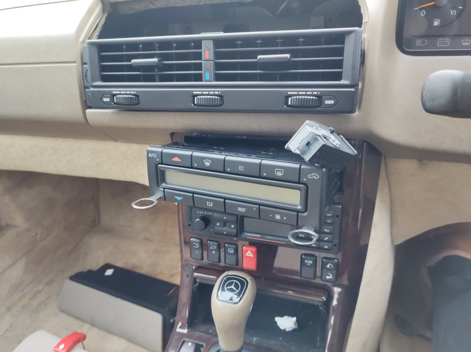

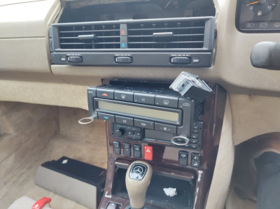

Today was chasing down an errant climate control unit
Easy enough to remove - a couple of MB radio removal keys and out it pops.

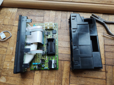

The issue had been that it was all over the place instead of doing what it should have been doing : Fans on but air not coming out where it should have done, front fans for the condensor running but no aircon, bits of the display going on and off, etc, etc. I spent a bit of time massaging the wires that go into it and found that the CCU would change behaviour with the slightest prod - classic dodgy joint indication.

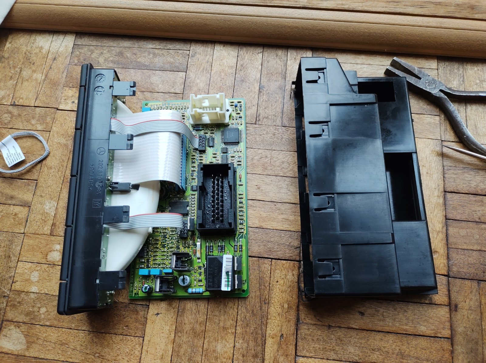

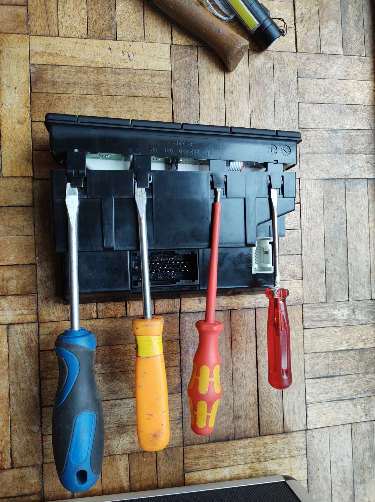

Easy enough to open up..... with a bit of improvisation
Nothing obvious on the soldering of both sets of connector pins, but I re-flowed the solder on them anyway
Clipped it back together then returned to the car to have a look into the two multi-pin plugs that plug into it. It was easy enough to get into the plugs for a better look at the connectors and there seemed to be nothing awry, so a quick splodge of contact cleaner and I put them all back together and turned it all back on and....... nearly success
The CCU behaves as it should now - all the controls work OK and the vents open and shut as they should, but still no actual aircon : compressor not engaging and the condensor fans not running.
Handily - the CCU has an array of diagnostic features to allow you to troubleshoot. A series of key presses will get you - amongst other things - live sensor readings. A common fault on these is that the evaporator temp sensor goes U/S and gives an unrealistic reading and that stops the air con from working. Sure enough - the reading was above 40°C for no good reason. A-ha ! That'll do it then
A new one ordered for just under a tenner delivered. We'll have to wait and see if that gets the system back up and running, or if something else will decide not to work. ](./images/smilies/eusa_wall.gif)
