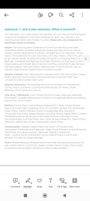

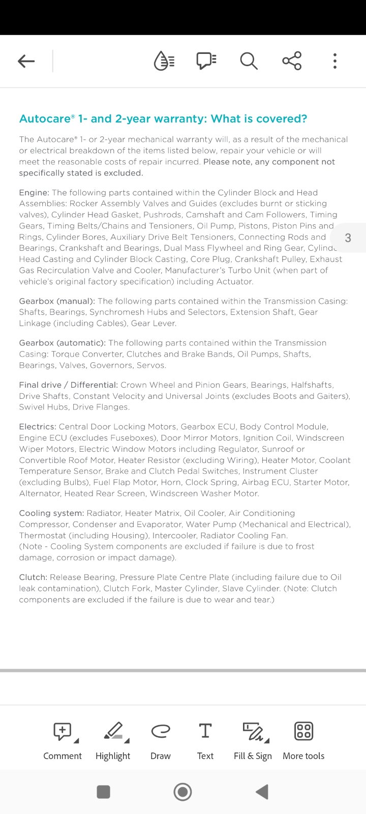

Attached the auto care covered items:
My situation is a bit different I think though, would have nothing really to do with Citroen, more Arnold Clark as its outside of the manufacturers warranty (2018 model).
- x 6945
Re: C4 grand spacetourer tailgate issue/battery drain
The seem to cover lock and window / tailgate motors - I still think it's worth a call as they can't list every single electrical item.

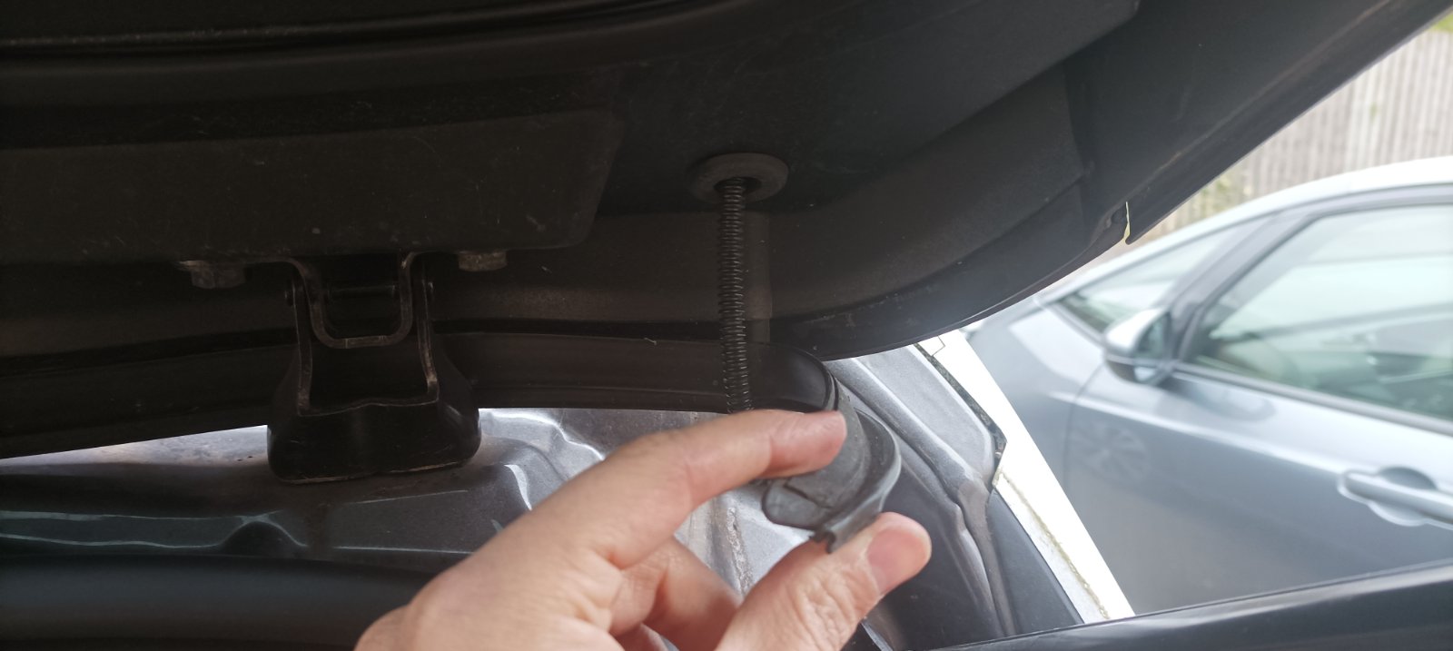

Is this the anti pinch sensor?! Or just a bit of plastic?
- x 6945
There's a complete seal that does around the whole tailgate, then there's another top seal and then there's an anti pinch sensor in the D shape I mentioned, which may or may not be visible, which has wires coming out of the left side.
