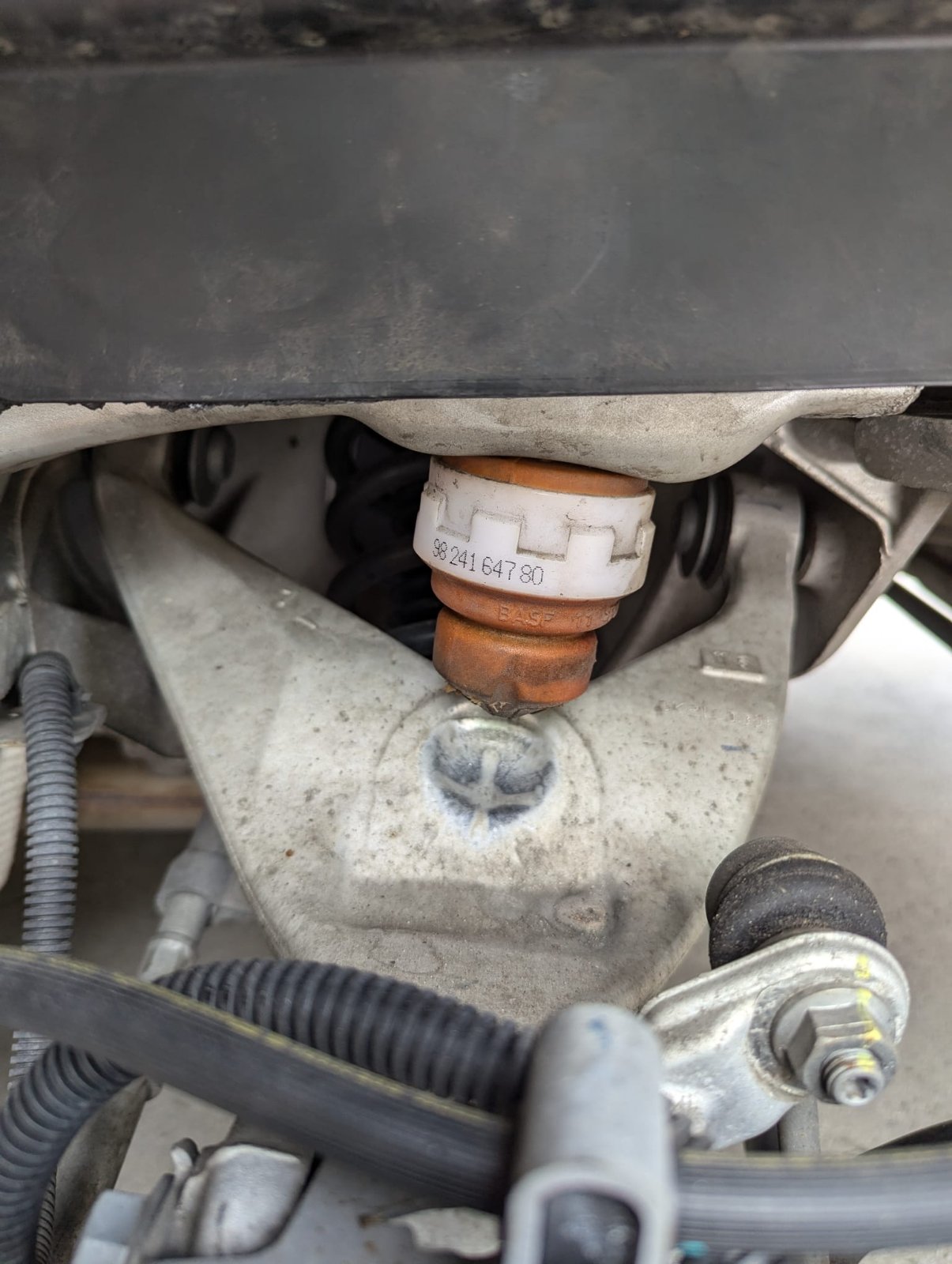

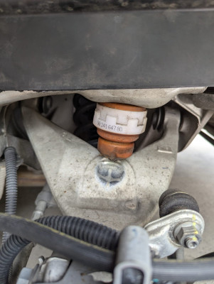

Hi
I did some sound deadening on the passenger side back wheelarch area this weekend, there isnt much there so I filled it out on various sides a fair bit with dodomat and closed cell foam. The top area was a pain and I couldnt get to it but generally happy with it.
I noticed what I think the suspension geometry is. On the front the bump stops would be inside the shocks but on the rear they are just a plasticky rubber thing that seems to sit on a suspension plate, looks quite rudimentary. X marks the spot so they seem to be hitting the right place. I turned the bump stop around to show the model number, the part comes up on a few latvian sites etc. Strange to see BASF on there, not sure if they are the same brand as made video tapes etc in the 1980s.
Just wondered if there was any way to perhaps easily improve the situation, either by upgrading the bump stops? or the other thought i had later was putting a but of high density rubber in the "cup"..... but I presume this would wear away?
