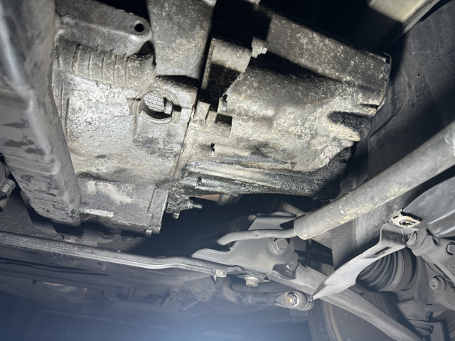

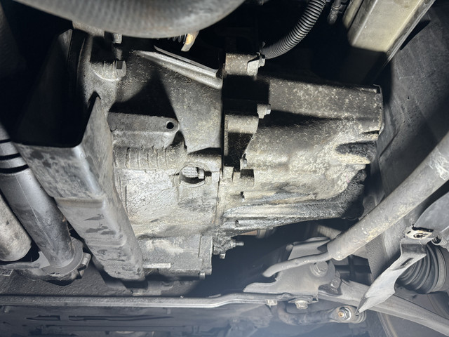

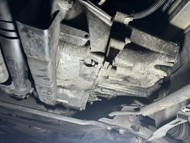

In Citroen with my frame they told me 2.6 liters, but how do I know? I don't see fins, where is it? supposedly cvm

From the pictures in the other topic you do not look to have fins which implies 2.6 litres of oil after a drain and for the refill.
You could always put your vin on here and hopefully admin will look up your car.
