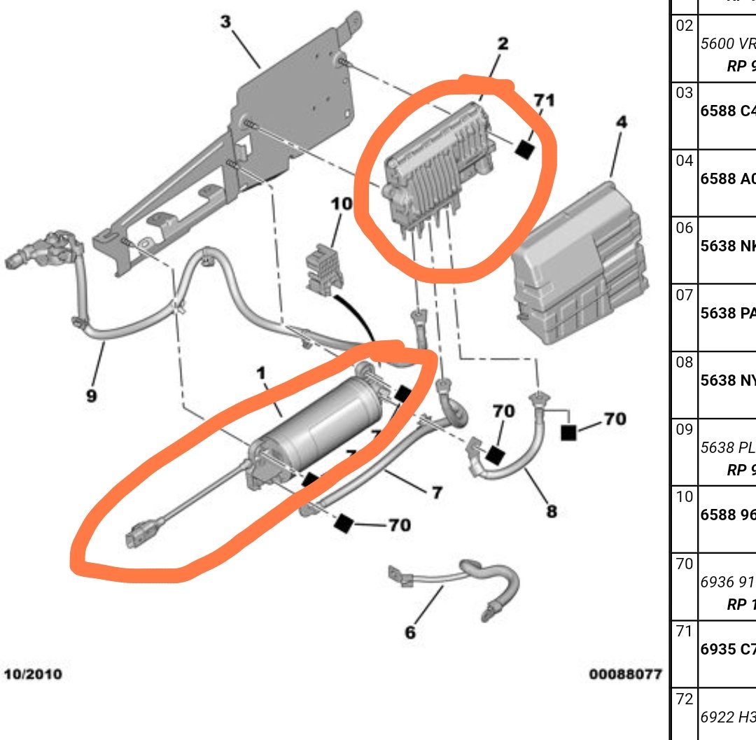

So as you know, (7) is not available, so you will either have to find a second hand one or get somebody to repair the connection if it's only that part that is bad.

GiveMeABreak wrote: 25 Feb 2024, 16:22 So as you know, (7) is not available, so you will either have to find a second hand one or get somebody to repair the connection if it's only that part that is bad.
Yes and I sad because the second hand cable is green in the connecting part as well. This picture was from ebay.
Or I cut the bad part and I put back the cable lug maybe my electrical friend help me :D
I hope this will be the problem. :?

kalm007 wrote: 25 Feb 2024, 17:53
myglaren wrote: 25 Feb 2024, 16:25 Perhaps an auto-electrician could supply a suitable part. My car isn't here now but when I replaced the battery last week I'm sure that there was a similar dual cable on the negative post.
You mean I will buy this cable and somebody will transform it. Will it be working?
I meant that an auto electrician may have such a thing as a stock item as they are used in other cars too. It may not be the precise one but could be suitable.
x 6956
Re: P1AA0 error code
At the end of the day it's one of the negative earth cables, so as long as it is thick enough and suitable for the job, I can't see an issue.

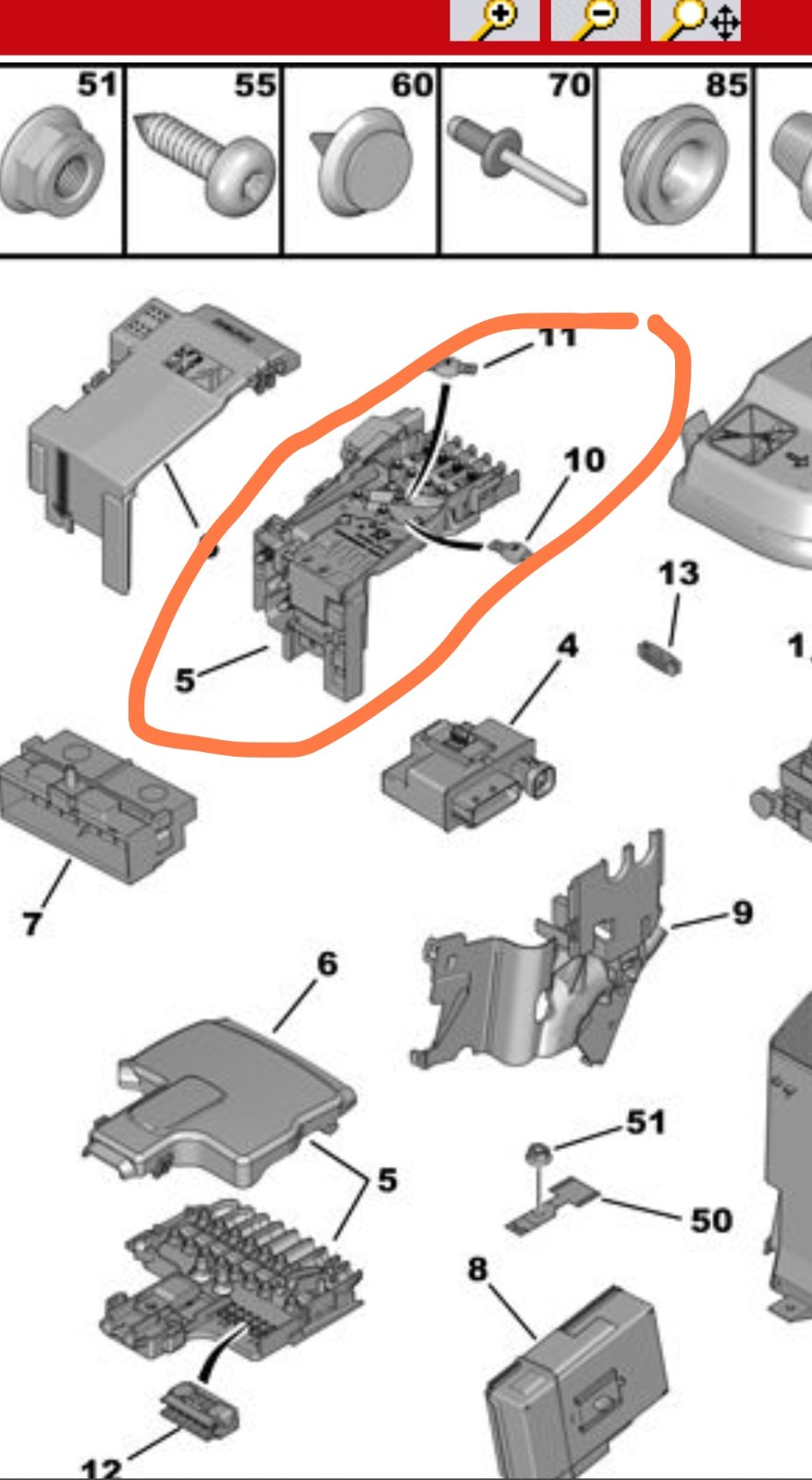

Today I replaced the 5. part and the error has still been here. I had to code the new part and it has been done. But currently I got P1AA0 error code.
Where is the problem? :D

When you replaced these parts, did you use new or used?
If used, then you may be putting faulty parts back on.
Failing that, the other possible faults point to the electrical harness.

Capacitor and stop-start controller was used but the accumulator controller (5. part) was new.
