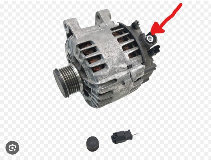

wheeler wrote: 22 Feb 2024, 22:03 Just confirm you are measuring the positive here?
If you are & still getting no voltage move the negative lead of your meter directly on to the batter negative terminal & see if you get a reading.
No, I had the positive end on the battery itself, and the negative on the alternator...
I'll do this tomorrow...

L_Downer wrote: 22 Feb 2024, 22:11No, I had the positive end on the battery itself...
To confirm, on the positive terminal of the battery?
L_Downer wrote: 22 Feb 2024, 22:11...and the negative on the alternator.
Whereabouts on the alternator?
L_Downer
Posts: 13
Joined: 21 Feb 2024, 11:45
Re: 2005 Citroen C2 L Electrical Issues
Unread post by L_Downer »
Yes, on the positive terminal on the battery... where tou would connect a positive jump lead....
The negative was on the casing on the alternator, as stated on the instructions.

L_Downer wrote: 22 Feb 2024, 22:24 Yes, on the positive terminal on the battery... where tou would connect a positive jump lead....
Even doing it this way you should still get the same as what the battery is reading, just make sure the bit of the casing you are touching the negative lead of your meter to is nice & clean metal, the casing can get oxidisation on it, give where you are taking a reading a scrape with a small file or emery paper to ensure a good electrical connection

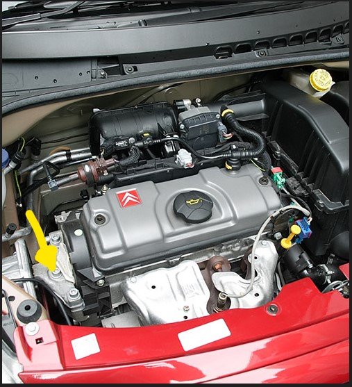

Do all the scenarios above & note which ones do not give the same as the battery voltage.
The big terminal on the alternator is directly connected to the battery positive & the casing is connected to the negative hence the reason you should get the same voltage reading direct at the alternator. If there is a difference (and assuming you are making good & correct connections) there could be an earthing issue.
Do you have jump leads? if so take the black one only & connect one clamp to the battery negative terminal & the other one to a good bare metal bit of the engine (engine mount bolt is ideal, see pic).
once this is connected re check the battery voltage with the engine running.
I will try and check these tomorrow, however I don't believe there is an earth as tested continuity between Battery - and Engine Block, with the resistance being very low.
