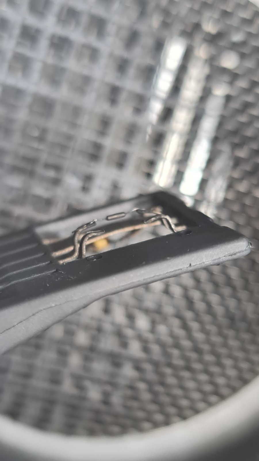

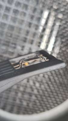

Probably unrelated, but I think my MAF (or IAT) is damaged. It doesn't affect the problem mentioned here and unplugging doesn't seem to anything other than create an EML but I cleaned it today with electrical cleaner and noted quite a bit of dark in the liquid runoff. But when I looked closer it looks like one of the thermistor looking things is missing. I don't know if it's MAF or IAT as I think they're combined but it's the wider section inside not the one that looks like a tower.
On the side nearest the incoming air there's a thermistor(?) bridging 2 thin bits of wire. On the side nearer the turbo the thin bits of metal are there but there's no component bridging them. Assuming there should be.
Also, I haven't double checked in lexia yet but my ObdLink reader has the Maf at about 17 g/s at idle and around 45 g/s at 2000 rpm which looks to be way too high according to some old posts albeit for a 2.0.
If it thinks it's having more air than it is, I'm guessing it's going to be over fueling?
It looks to be a 3rd party sensor either way so no harm in changing it. I'd better go dealer for that as it'll probably be a waste of time going cheap

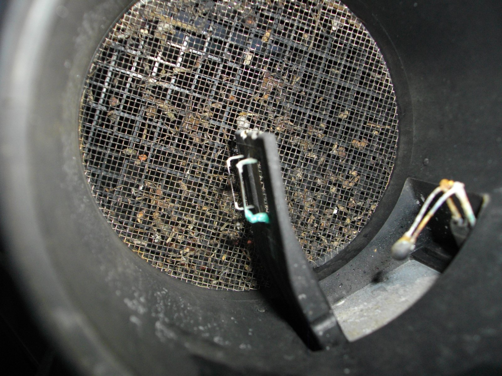

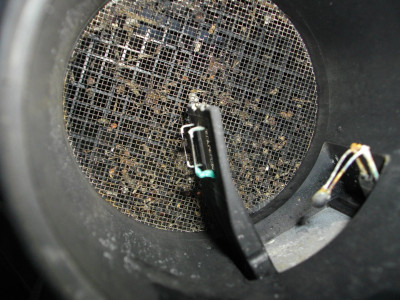

Nothing missing, it is as it should be.
This was mine, or one of them anyway.
Those thin wires are very delicate and will be ruined if touched or the unit dropped.
IIRC the thermistor measures the air temperature and the wires measure the airflow by determining the temperature drop caused by the airflow over them.
It is corroded and full of debris sucked up from the side of the road when the wheel arch liner disintegrated and water and muck were thrown up into the induction hose.
I cleaned mine with carburettor spray and it worked fine after that.

Ah that's really helpful and wow, that's pretty grubby. How did so much pass the filter!
I think that pic actually shows that mine IS damaged though. One of those staple shaped parts doesn't have anything across it, not even the thin metal "bridge" it looks like yours has both connected. I'll try get a picture up for confirmation in case mine is meant to be for whatever reason. I wouldn't be surprised if it is damaged though, having accidentally touched one a few years ago and seen how easy it fell apart it was a good lesson

The filter was completely sodden and misshapen and the 'horn' to the left of it completely full of water and grit.
Still mystified as to the purpose of the horn thing.

Here's the MAF the thermistor looking thing is on the other side (in the background) and there's a similar one on the "tower" structure opposite (out of shot).
On the side in focus can see one is joined but the other seems to be missing a component. Shame it's not the cause of the main issue though.

Apologies, there was a hole in the bottom of the 'horn', about 5mm and it looks like it is meant to be there as there's a clear punch out section in the moulding (although not centre bottom where you'd expect)
Anyway, problem still unsolved but after reconnecting the vac lines and learning a bit more about them and the eletrovalves, the egr one was still hot and failed so constantly opening egr.
I also found that both of the inlet flaps EV were stuck open and very hot like the egr one so they're back off for now as it was bypassing intercooler permanently; and I've electrically unplugged egr and both inlet EVs as well as blanked the vac lives again so at least the ecu is aware it can't use them this time.
None of this seems to affect the cold shudder but I think I should at least get some functioning EVs so I can diagnose further on a stock configuration. Having the egr constantly open just chucks out white smoke out the back. I have one good EV on my Dispatch that I can use so will try that on the egr first but the ecu may still get upset if it can't move the inlet flaps so scrapyard or eBay next port of call
