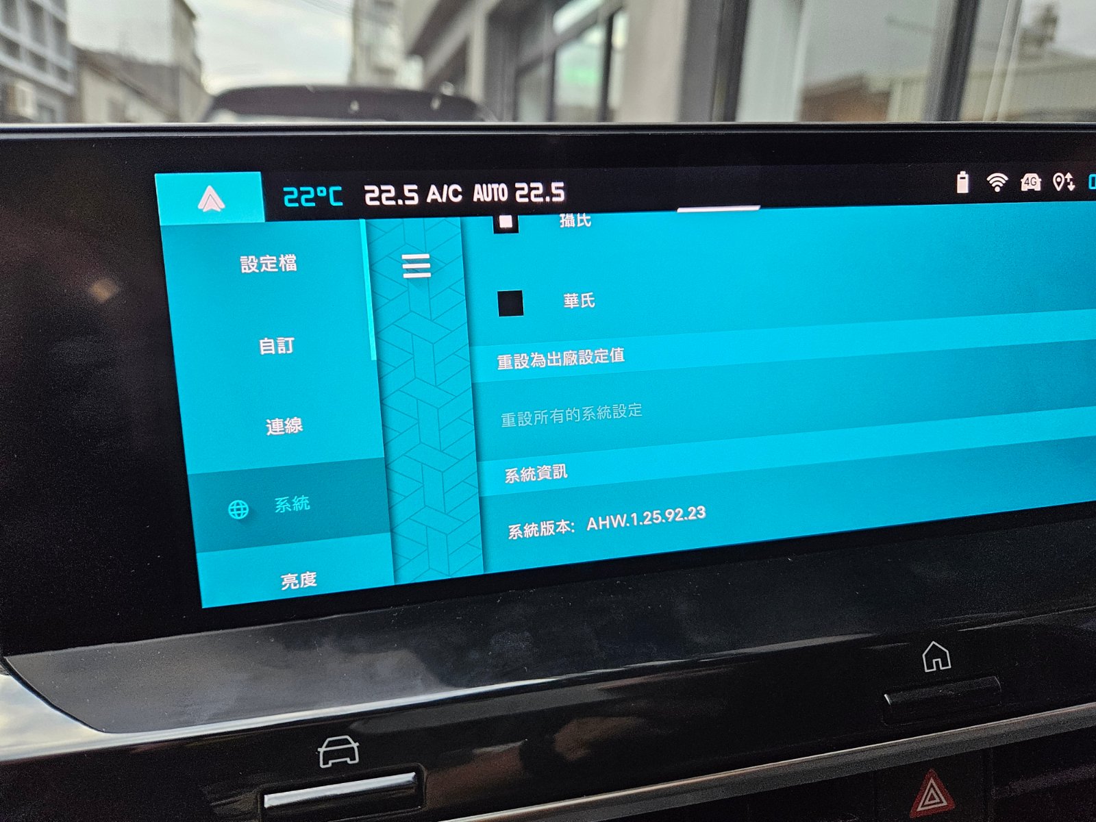

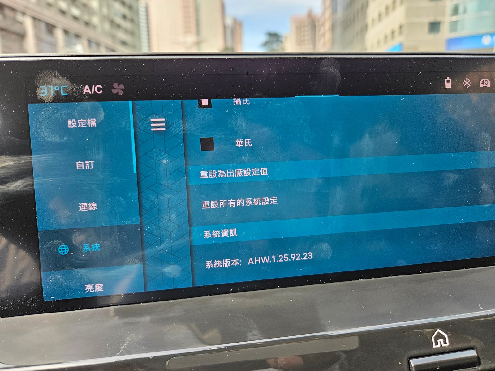

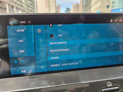

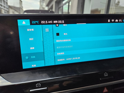

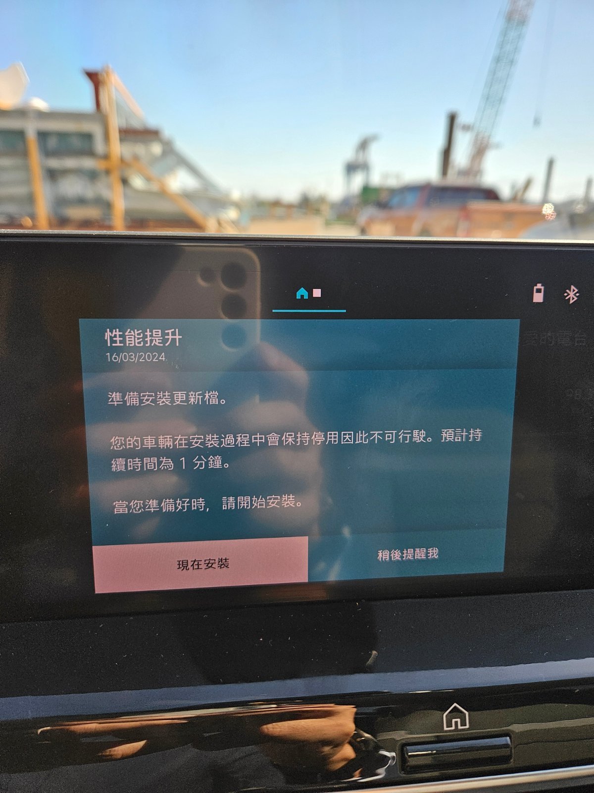

It aseems to be global that OTA failed. Mine and few other C4s in Taiwan all experienced the same situation. OTA failed and many system onboard are missing, ADAS, parking assistant, mirror screen, etc. The A/C configuration is wrong and there is heating seating page that my car doesn't have.
I'm currently at the dealer 's workshop and they need to contact French headquarter before they can do anything.
And I found the OTA is dated at 3/16 2024....
Updated: The dealer is able to write the correct software back to solve the problem. I'll stay away from OTA for a while.

Not sure how they can release a software with a date that has not arrived as yet??? Unless this is a beta version that may be reduced on that date after testing - so you may be a guinea pig for the corrective firmware.
Either that, or they have used your old firmware and changed the date of the firmware and version number possibly to make the system believe it is a later version to allow it to install to get the system working again. So you may just have your original firmware on despite it saying it is a later version just to get you out of a fix.

Marc, the software version shown on display is the same for both. AHW 1.25.93.23
Wrong software
Wrong software
Correct software
Correct software
x 6948
Re: Firmware Update Error for Citroen C4 2022 Shine
So maybe they reapplied the corrected version of the faulty software. You can always update with the same firmware version, but can't go back. But at least it is working now. I have seen cases where the firmware has not installed properly and a repeat is needed.
