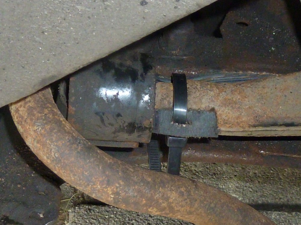

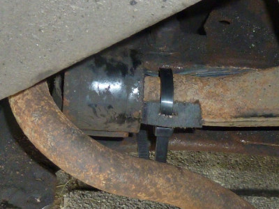

The rubber in the front bushes is not a solid section, and can fracture. This does cause the steering to pull under power or braking. Here is a temporary bodge I used until I was ready to fix it properly.
It uses a bit of toothed belt (or possibly poly V) threaded through the spaces each side of the bush, but I don`t remember whether it was timing belt or something smaller. It needs to be retained with a cable tie, or it works itself out.
