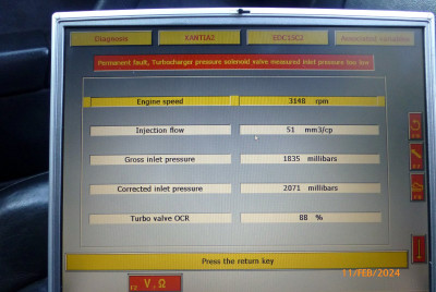

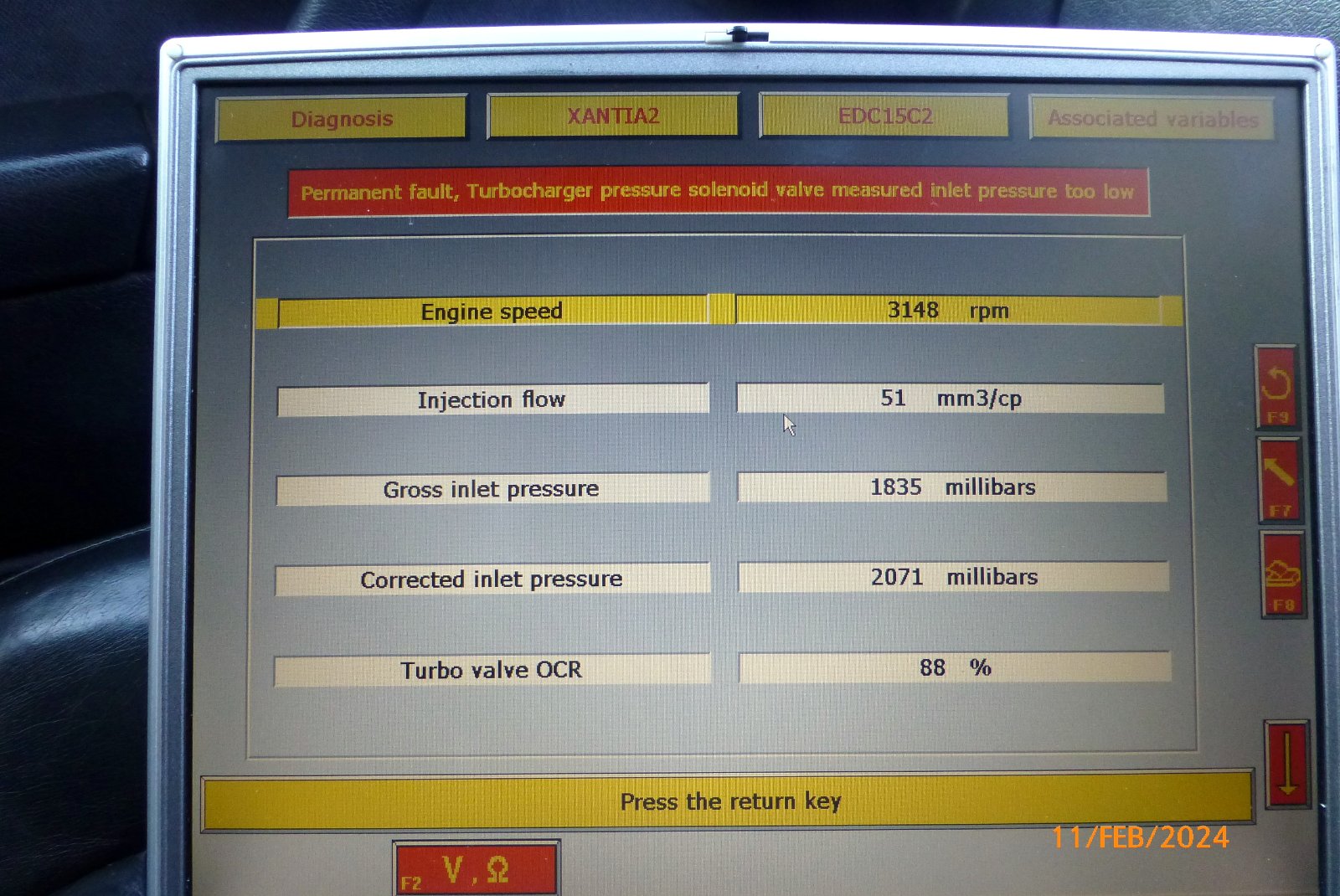

It’s been a while but I’m back on the case with some good news. I blanked off the EGR as suggested and its done the trick as its a lot quicker now… not a job I want everyday! It took so long because I managed to break a connection on the fuel filter housing whilst laying on top of the engine and fun and games sourcing a replacement. Although its got it’s vitality back it’s still throwing a light when I put my foot down in a higher gear. You can see that I’m getting a fair amount of boost (1835mb) so things are not that bad provided I don’t go mad. Like to get it sorted before start of towing season.

Thanks Jim. Not sure where we go from here. The turbo is the only mechanical thing left and appears to be o.k. since the actuator appears to be functioning normally.

Success! Goes like it’s on illegal substances now with turbo pressure clocked at 2353mb.What a difference! From my last post you can see turbo was up to 1835mb which was liveable with but could throw a light. I thought I’d have a go at changing the 4 month old new branded turbo solenoid valve for one of my used spares and voila! How many times does that happen? To sum up: the main cause of the power loss was a dodgy EGR and new turbo solenoid valve. Not bad considering it’s in it’s 25th year and only done 239156 miles. Next job: replace strut tops,
