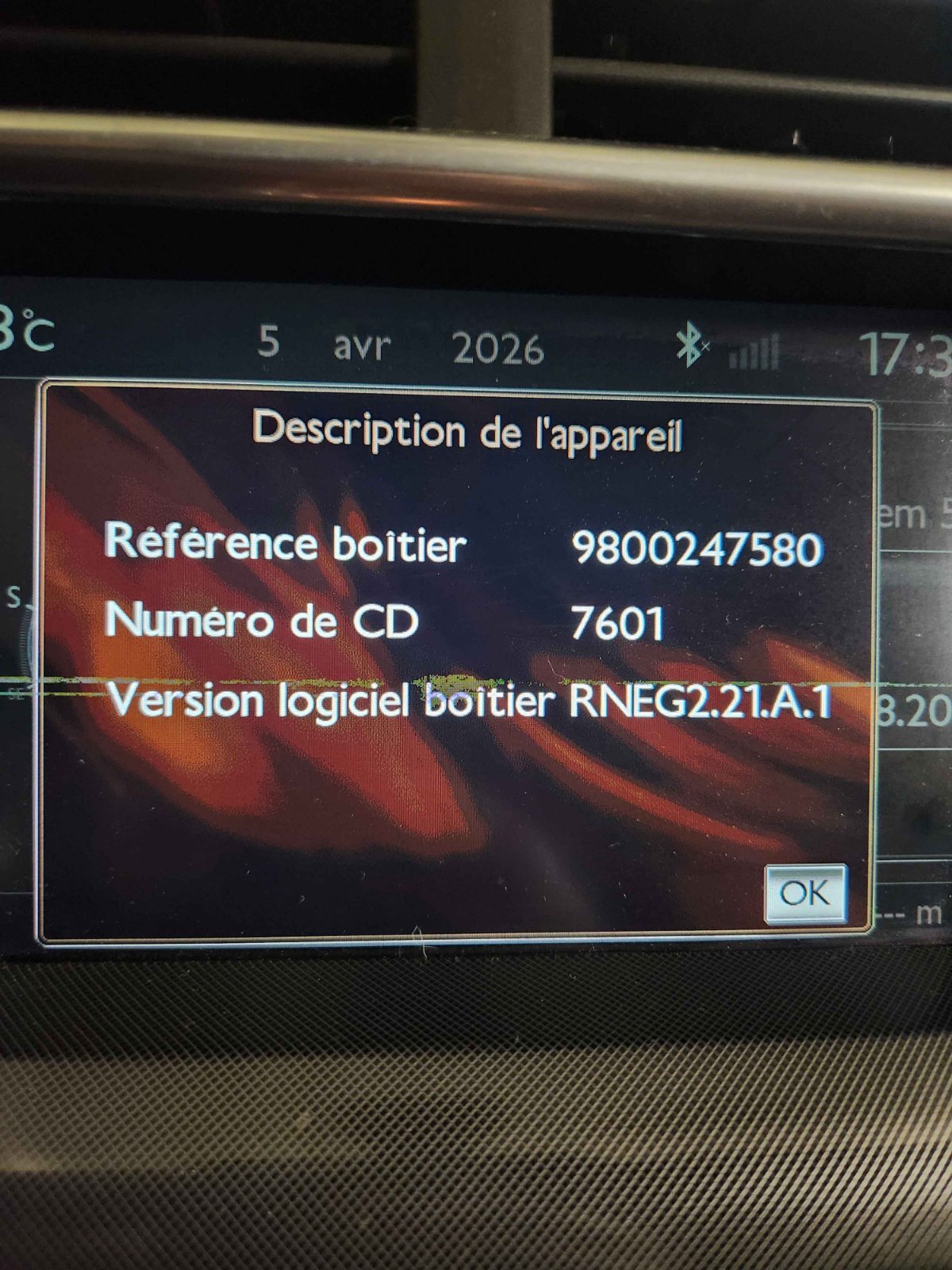

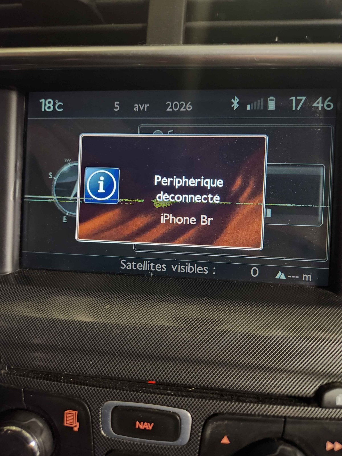

Hi Paul,

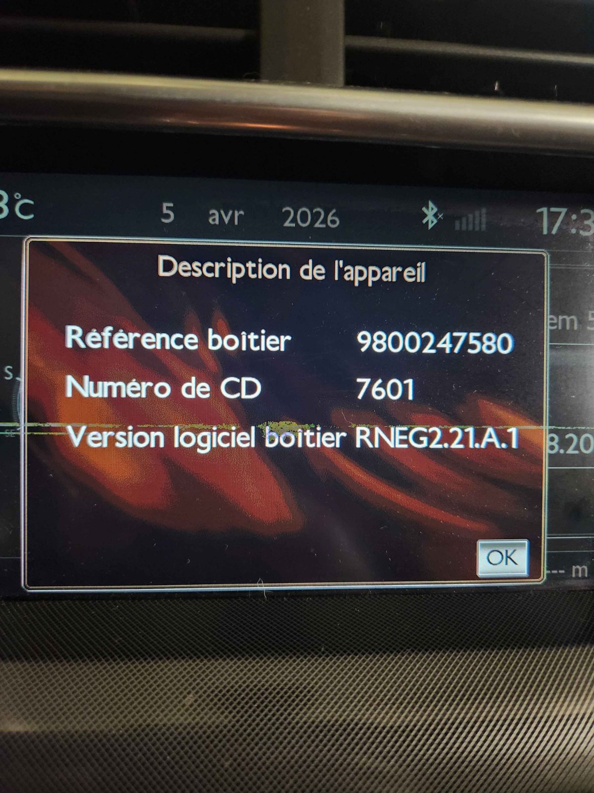

I proceded to the upgrade of the frimware 2.10 to 2.21.

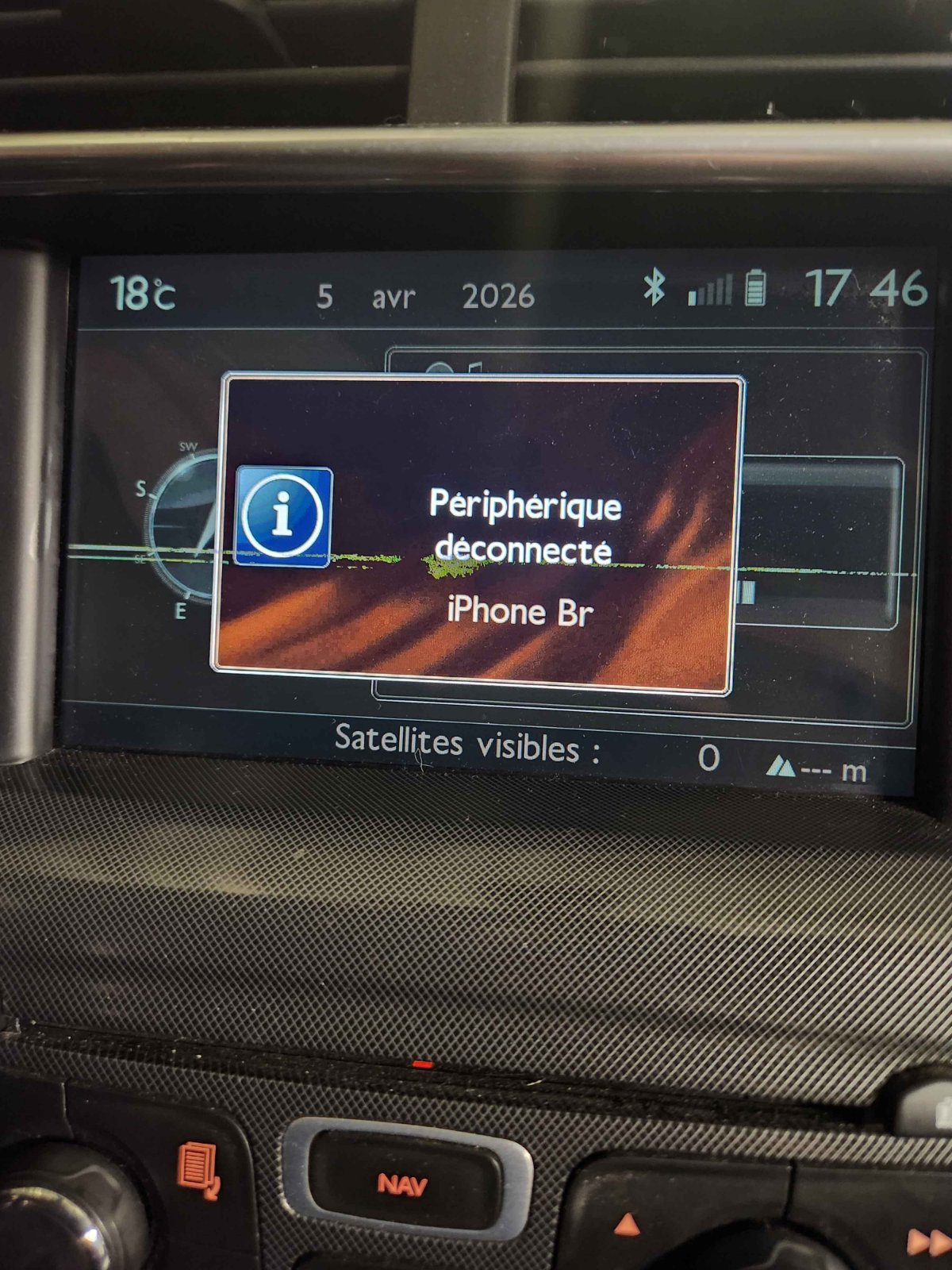

The problem of the bluetooth is yet here but less curently.

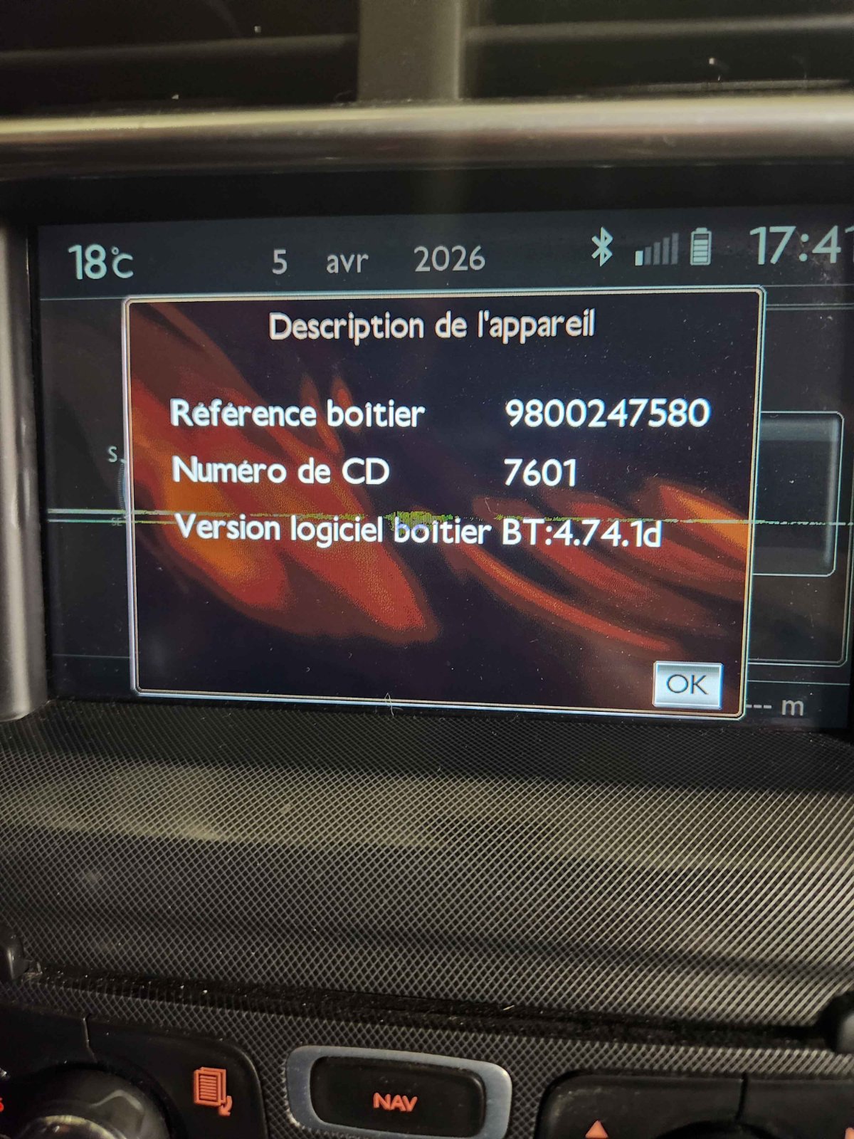

I use iPhone 13 mini and the BT version of my C4 is : BT:4.74.1d.
Is it compatible ?
Thanks !

Brandon1998 wrote: 05 Apr 2026, 17:16I proceeded to the upgrade of the frimware 2.10 to 2.21.
Whilst researching my answer to you I did come across a post by someone who said that had cured their BT problem when the reached version 2.7something (probably 2.77). So maybe do that but if you do there's no going back if it makes things worse.

Brandon1998 wrote: 05 Apr 2026, 17:16 I use iPhone 13 mini and the BT version of my C4 is : BT:4.74.1d.
Is it compatible ?
Sorry I do not know anything about iPhones.

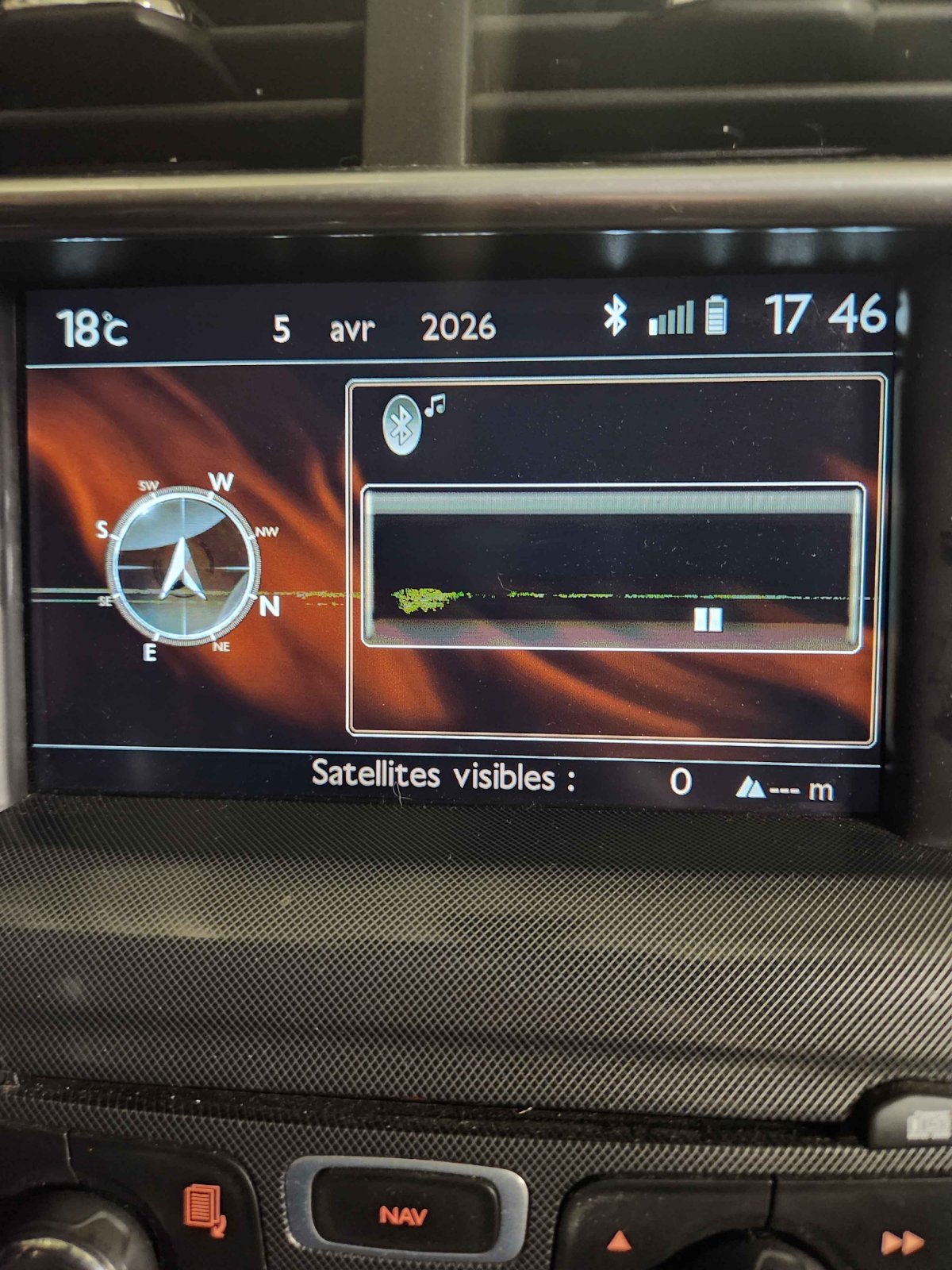

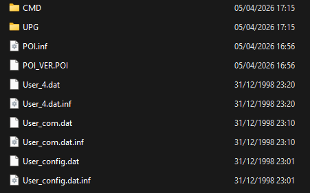

I come back to you aftyer 1 week, I want to be sure that my problem is not temporally. Unfortunatly, he's not...
Yes I download my configuration with Mirascripts?

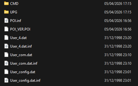

Here the capture of my USB Key after backup

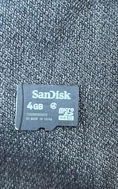

Do you think that the problme can be my microSD card ?
Can I buy a new microSD card and restore my backup with mirascipt ?

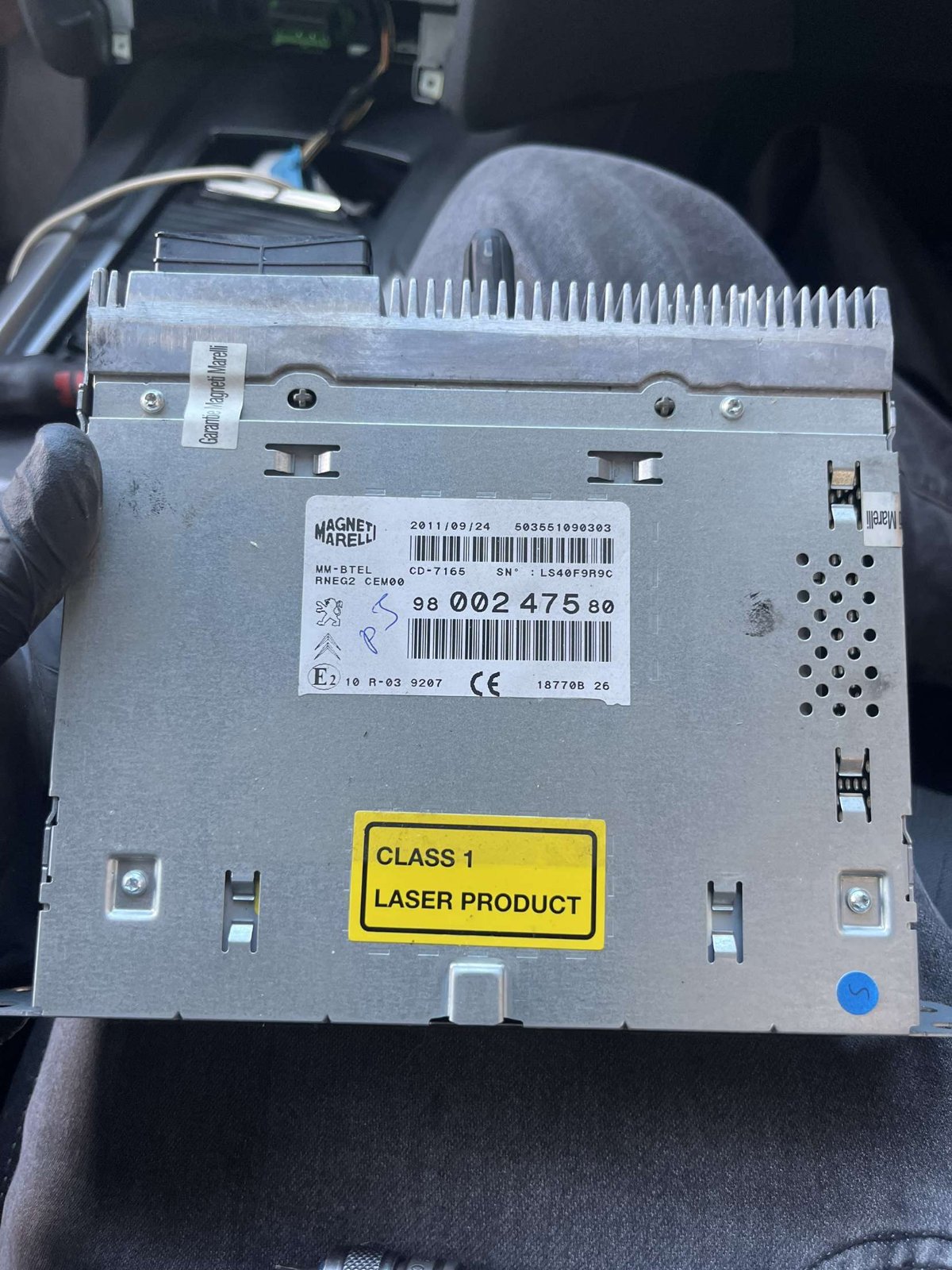

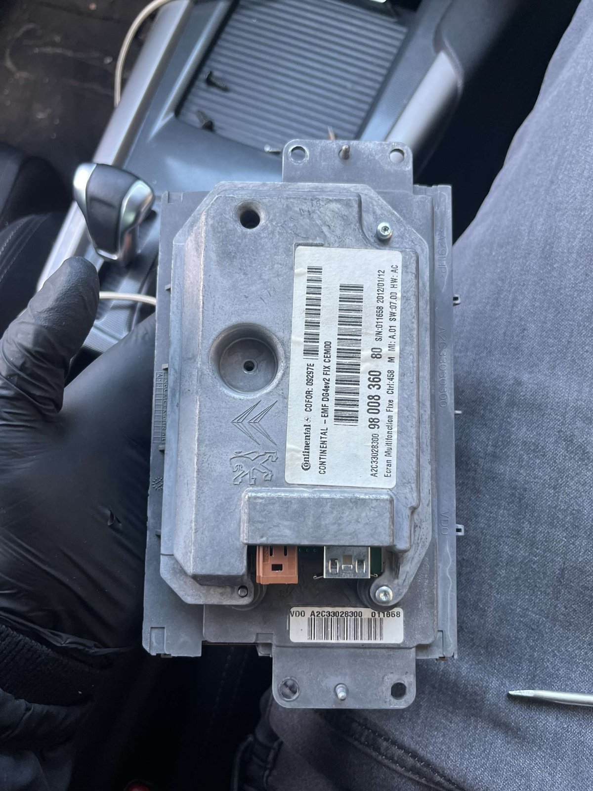

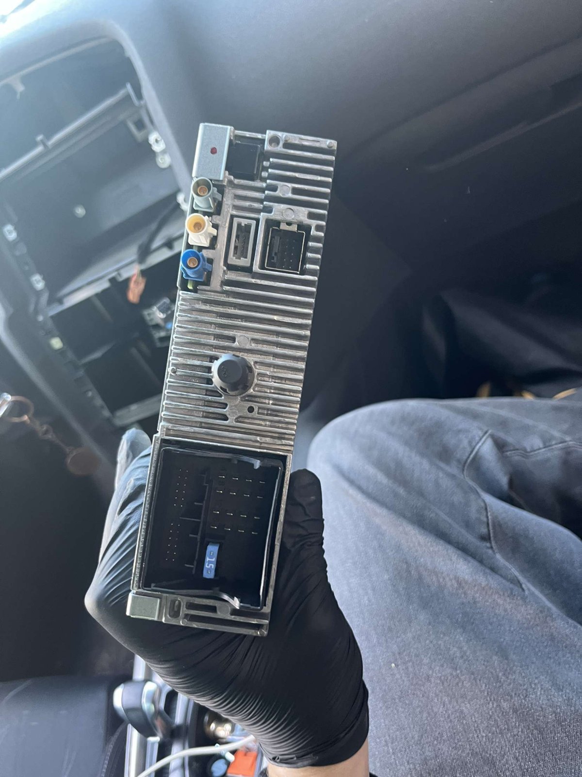

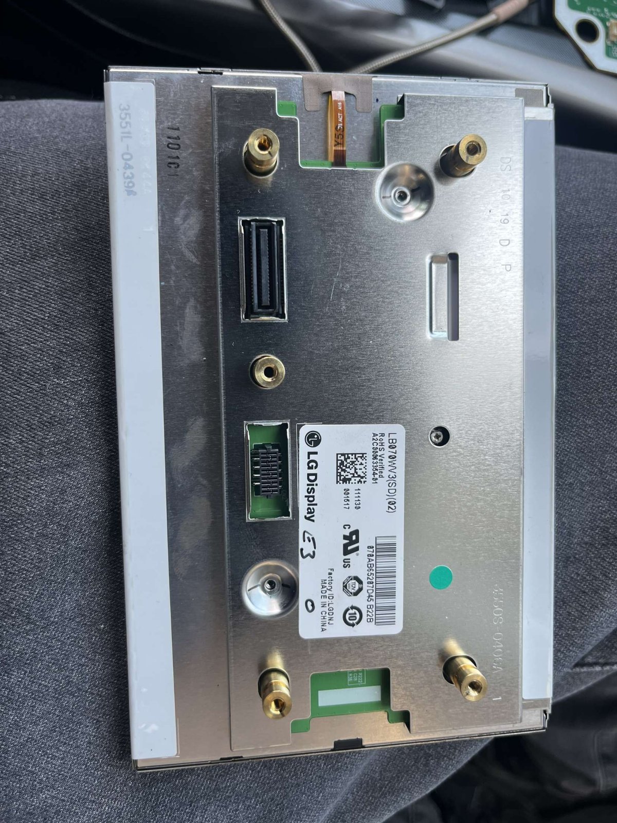

I dismantle my radio, and this is what I have
Well, it doesn't look wrong! You won't know until you try to restore the configuration though.

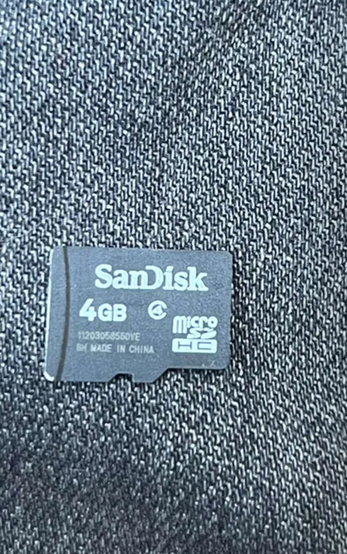

Brandon1998 wrote: 14 Apr 2026, 01:01Do you think that the problme can be my microSD card ?
Yes, it certainly could. I would suggest you upgrade to an 8GB microSD card though.
Brandon1998 wrote: 14 Apr 2026, 01:01Can I buy a new microSD card and restore my backup with mirascipt ?
Yes, absolutely.
Brandon1998 wrote: 14 Apr 2026, 01:01I dismantle my radio, and this is what I have
The photos don't show much that we didn't already know except that the SD card is 4GB capacity and confirming that the radio is RNEG2 (RT6). It doesn't reveal what firmware version was originally fitted.
