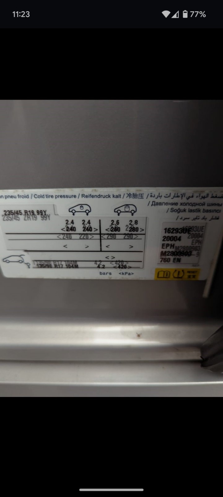

One question for givemeabreak just to double check something. my plate on the passenger door gives a code EPH and I presume that's the paint code. have you got any suggestions for touch up paint as there is allsorts out there and I could do with a paint pen or similar.

Hi, yes, that's correct,:-
EPH = CHRYSTAL PEARL PAINT

Let me know if you require your Factory Build Sheet.

Hi
Thanks for the offer. I suppose that may be helpful to see the build sheet if you can get me one. I'm not expecting any surprises on there as it seems standard spec.
