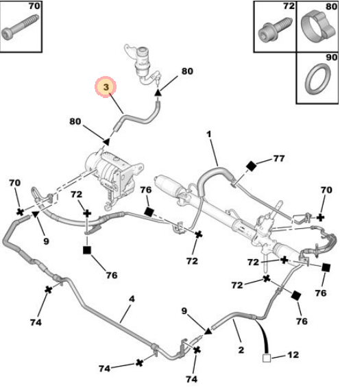

Sorry - I was looking at (1) as that was highlighted in the diagram. Yes (3) is the low pressure pipe 4012P3, £40.14 from Citroen (UK Pricing), still available. Measurements are not provided.

would it be reasonable to assume 13MM ID (1/2 inch) ?

Sorry can't advise on this, never had this pipe go on mine
