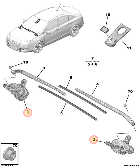

If you need an official part, your membership provides for this, so just ask on the parts thread in future to ensure you get the correct part:
viewtopic.php?t=69962
(1) Front Window Wiper Motor Right (RHD Vehicle only), part: 6405LA, £453.55
(2) Front Window Wiper Motor Left (RHD Vehicle only), part: 6405LE, £453.55
Be careful buying aftermarket parts as left hand drive vehicles have different motors for the left and right side and differ from right hand drive vehicles so cannot be interchanged!

Thanks!GiveMeABreak wrote: 27 Nov 2023, 14:44 If you need an official part, your membership provides for this, so just ask on the parts thread in future to ensure you get the correct part:
I bought the right part.. Fitted it last night...
And it's still broken.
Granted the second hand part looked a little worse for wear, so it could be that.. But seems unlikely.
What's the next thing I can check?
