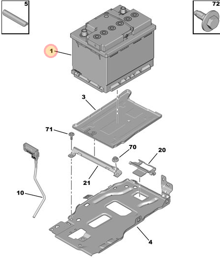

Hi Mario
Battery type is AGM
(1) 12V Battery
Original, (L3-70AH-760A-AGM) part: 9678006180, £303.91
Cheaper Alternative, part: 1620012780, £215.15
