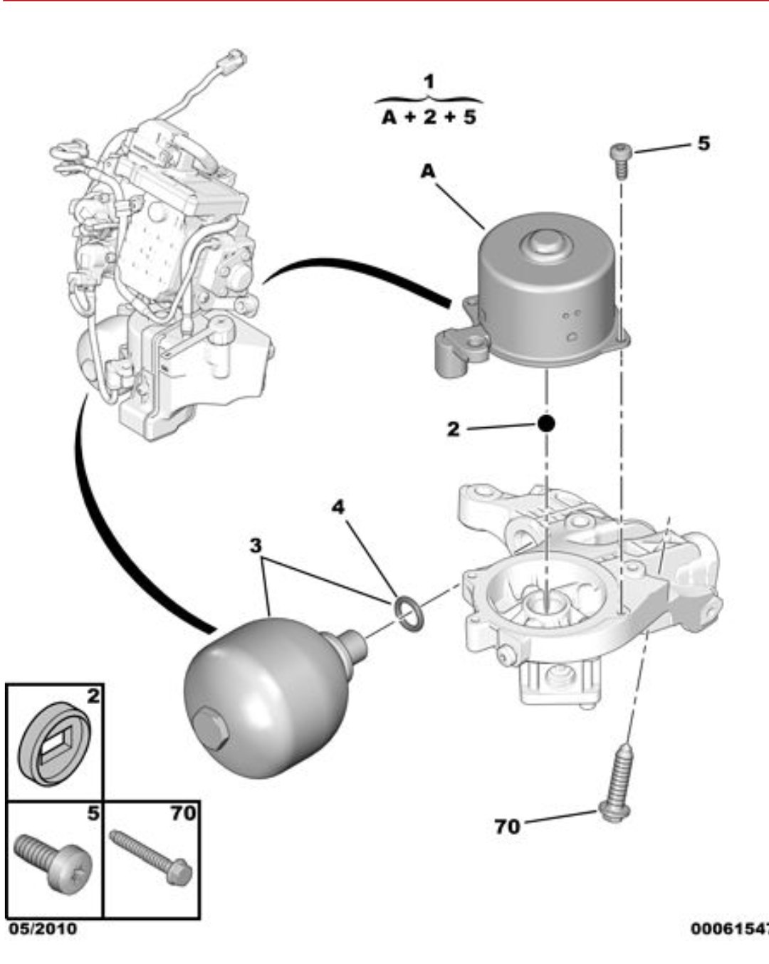

2461F2 this is the product number
I could not find the youtube vidoes but not so hard.
You will remove the "70" part number bolts (4 pieces If i remember right or 3) and you disconnect the oil tube and you can remove the bottom side

Thank you so much!kalm007 wrote: 24 Jun 2025, 11:32 Hello
