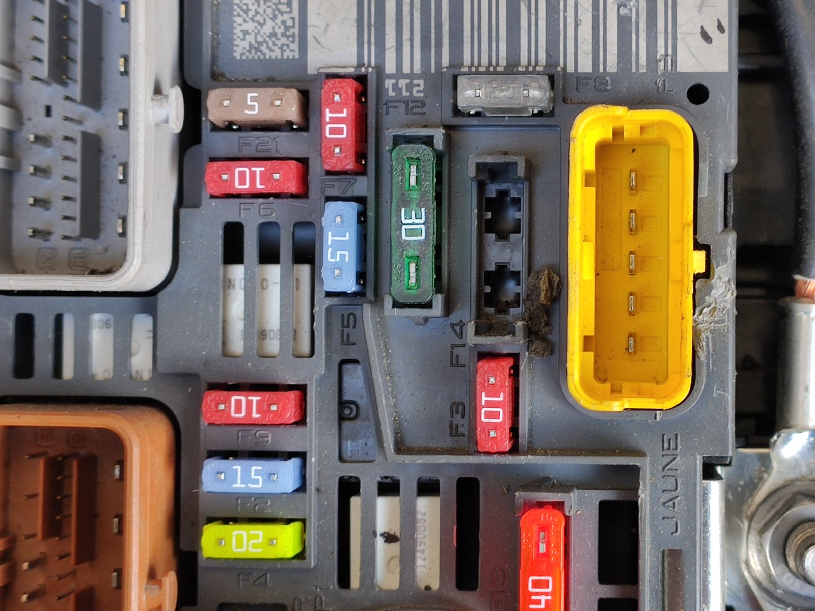

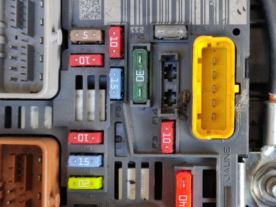

so does that mean it's still 'active' even if no fuse is fitted/unused? At the F14 fuse point?wheeler wrote: 29 Aug 2023, 20:22 I had already said about the fuel filter recall in my previous post. If it was just in a dealer this should have really been picked up, they are supposed to check every car that comes through the doors.
As for F14 it shows on the wiring diagram as its internally connected to the other fuses I mentioned, i was just going by that. if its not on the actual car thats fine. It just may be unused on your car, its still on the same circuit as the other mentioned fuses

According to the wiring diagram yes although it sounds like it may be physically blanked off in this case. Many of the unused fuse positions can still be live on these cars.

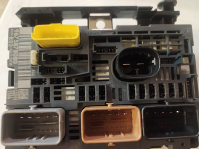

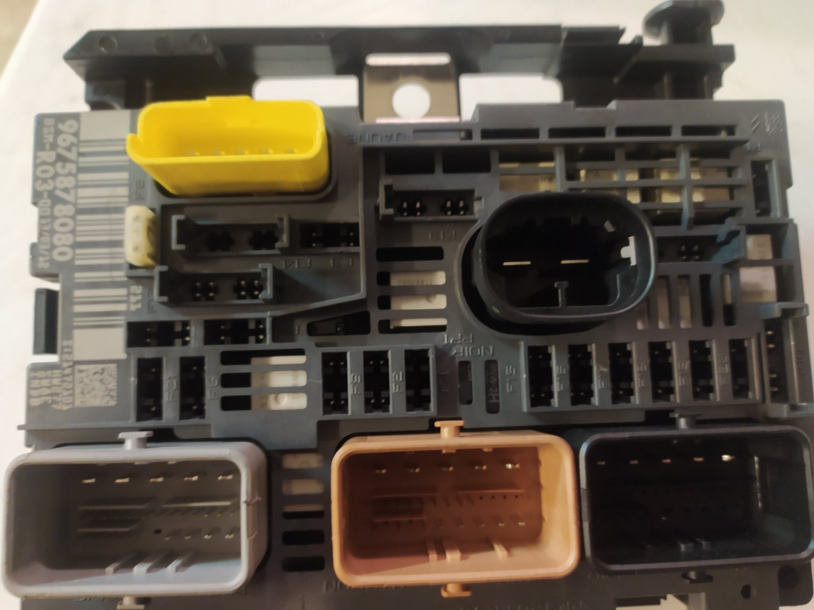

"First signs of failure were: when turning the key (starter position - 3) the startermotor didn’t do anything (no cranking or even clicking), there was just a soft/quiet click in the BSI"
Sorry for my bad English
I had same issue as quoted above and just solved it. The problem was faulty Delphi Bsm R03 9675878080. I have bought a used one for about 130Euro and now everything works fine. Changing this part also fixed another problem with automatic windows open/close switch(I thought it was bad switch or wires). My mechanic tested engine starter =Test Pass OK, cables from starter to Bsm =OK...
