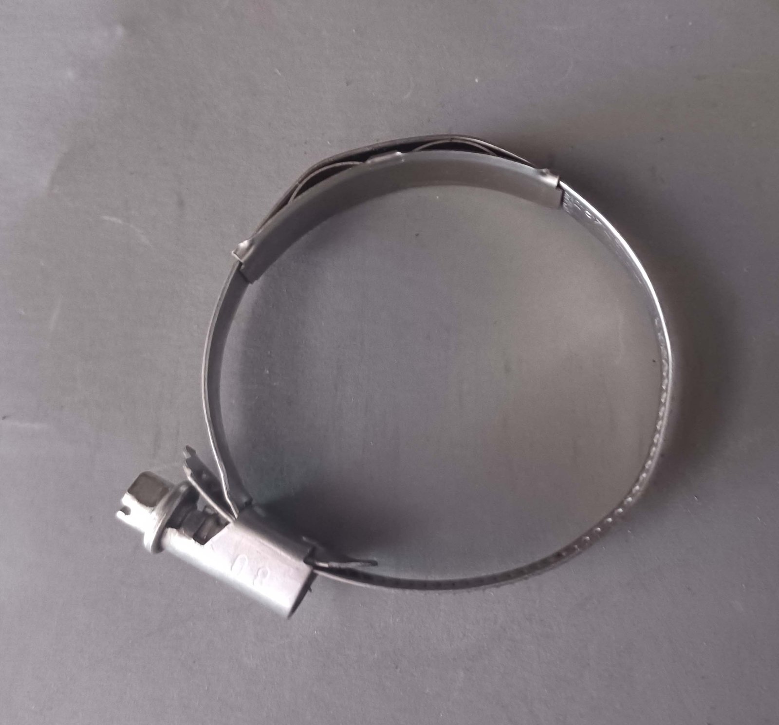

Update: the clip and boot was slipping off !.........bugger !
So, Plan No3................................................................
The problem: .............The rack has a grove in the neck, applying a strap off the car is easy as you can tighten it so the boot is compressed into this grove...as we all know, there is NO access to do this off the car and narrow banding needs to be used to allow this to happen..... jubilee clips are normally to wide and "bridge" the groove which is why they come off.
VAG "squash" type bands cannot be tightened correctly due to the very limited access and are also to wide and also bridge the groove.
The solution (I hope it is)....................................... 1.....I used 3mm TIG welding wire (annealed in a flame/no quench).

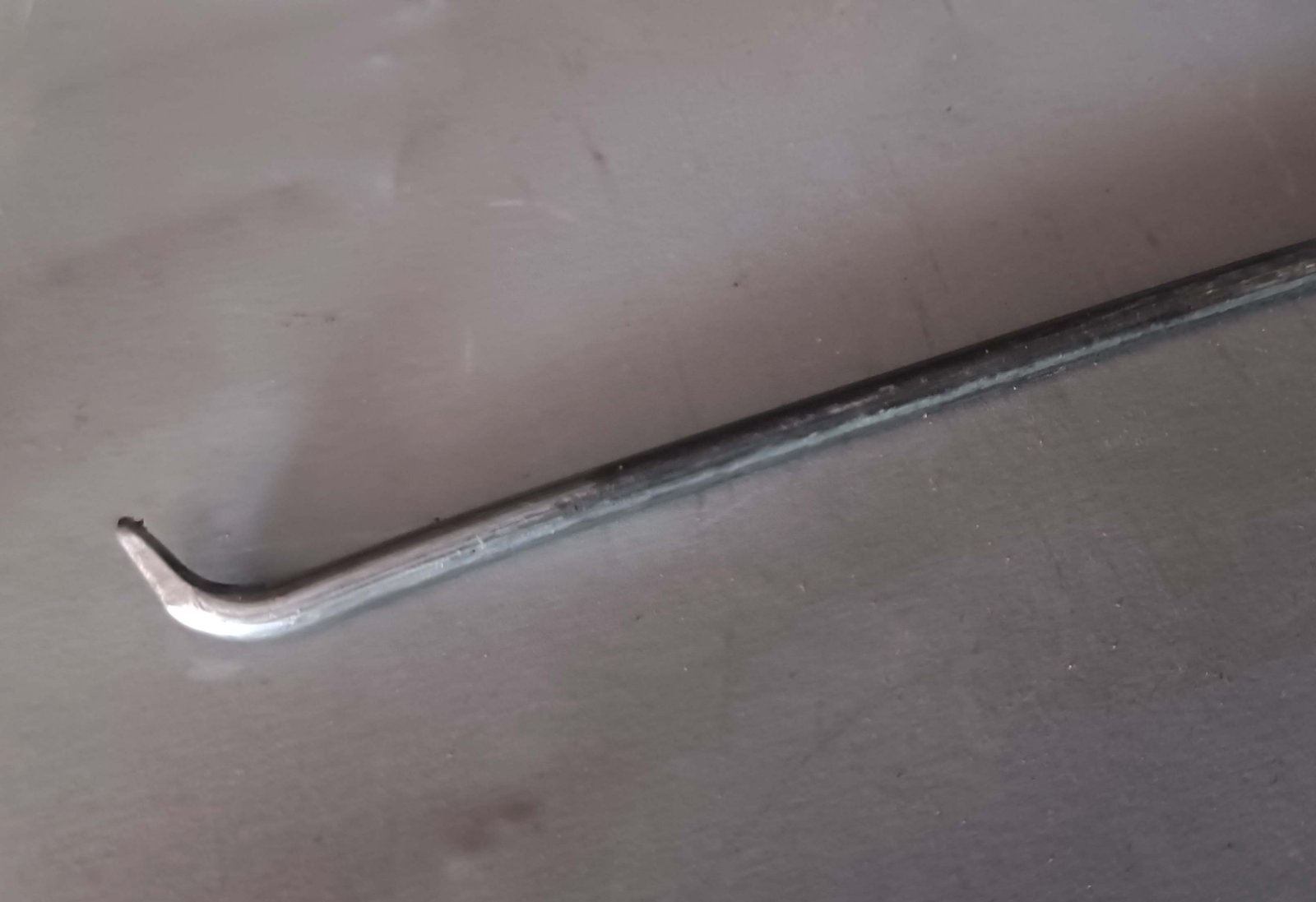

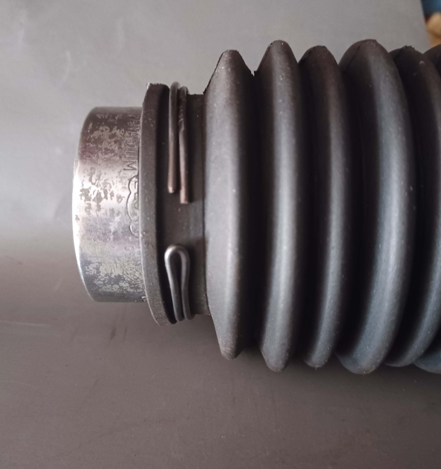

2....I folded this over on itself, squashed the folded end close together in a vice......then using a spare boot (to check roundness/size) and using short pointed pliers formed it to a circle, I cut it off about 5mm short of a full circle and rounded the ends well with a file.....I essentially fabricated double wire "circlip"....9/10th of a circle. 3....I put this over the boot (via the wheel arch) and using a hooked rod and fingers, moved it over each of the bellows until it got to the strap-end.

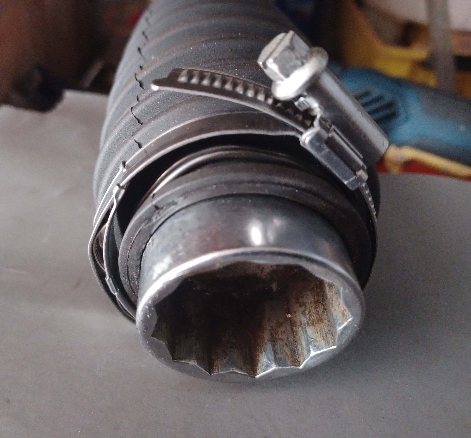

(I tried hard not to open it up to much and took care not to force the ends through the rubber boot...but these are very strong). 4.....The plan here was to apply this wire circlip OVER the boot "strap-collar" and set it to be above the rack groove and use the jubilee clip to compress this wire circlip into the boot/groove with the jubilee clip holding the boot and the wire circlip in the groove. This would thus be now locking the boot in place by it being now pressed down into the groove in the neck of the steering rack as it was designed to be. ...........................................................................
UPDATE. The boot/clip is still on this morning, it has not moved a single mm.......the steering was left on full lock/boot fully stretched all night.
I think (hope) this new method will allow the use of the after market rubber boots
