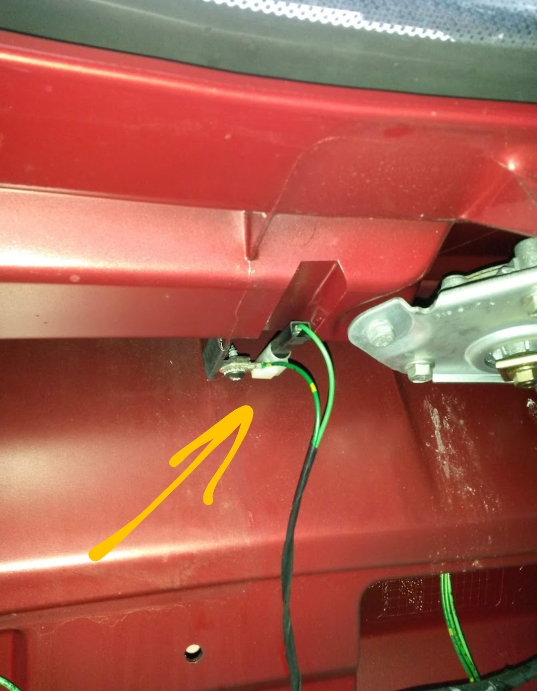

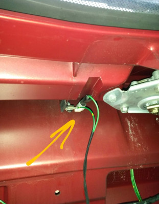

thankyou all for your input, i think i could do with finding what powers the buzzer under the steering wheel as a last resort and snipping that, i can live with the message as the clock is almost unreadable anyway and any EML should show on the dashboard anyway.

They've not used a tilt switch like on the S2 Xantia to detect it being open have they? In which case it need not actively be anywhere near the latch.
Just a thought. Though I'd usually have expected issues if it was that sort of setup to manifest itself as failing to detect it as open than the opposite.

Zelandeth....I doff my cap to you sir I believe that may be the culprit!
