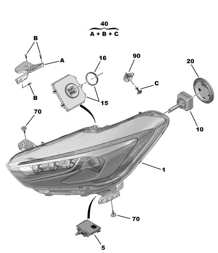

Re: DS5 Headlights
Guys - there ARE separate lamp units for LHD and RHD vehicles for these headlamps on the DS5 for ALL variations of Headlamp type, Halogen, Discharge, Discharge & LED.
NotAnInterestingName
- Posts: 236
- Joined: 11 May 2022, 12:58
- x 51
Re: DS5 Headlights
Are you sure? That one listed in Poland/Ukraine is the same part number as mine.
Perhaps the number is just the plastic back shell or something, as they were different types anyway.
- x 6948
Re: DS5 Headlights
Yes I'm sure - that's likely not to be a part number. All I'm saying is that OFFICIAL Citroen / DS parts data have different part numbers for each headlamp type for LHD and RHD vehicles. That's why we only use official data from Citroen / DS.
Your lamps are above (Discharge & LED)
Right Hand Drive Headlamps (Driving on the left hand side)
Left: 1613381280
Right: 1613381180
Left Hand Drive Headlamps (Driving on the right hand side)
Left: 1613381080
Right: 1613380980
Left: 1613381280
Right: 1613381180
Left: 1613381080
Right: 1613380980
