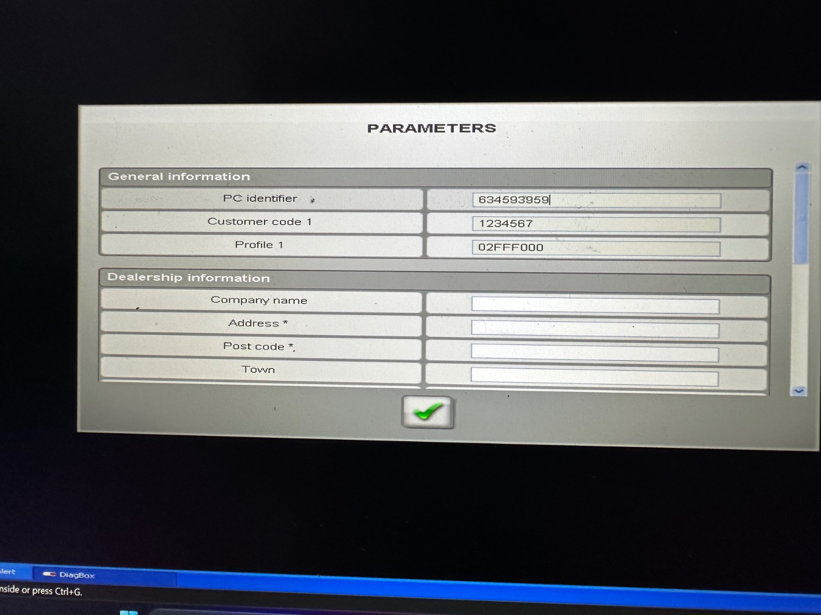

I’m trying to get it sorted currently. I have Scarrys patched 7 iso and the following updates but I get promoted to enter dealer details after it says activation successful and then I can’t find the activation files in root directory of C:

That’s before even applying the new updates. Should just be 7.02
This is the Same ISO as the seller would have been using, I managed to read the file from the original CD to get hash of the file. Also had Scary01 on the top of cd box

Is this normal or does it mean activation failed??

That’s exactly what I’m doing. 7.02 is what I’m attempting to install. He said it’s likely a rev B so don’t go no higher. I can’t afford to buy another interface. My car is on a 56 plate so it should work with it, same year as the C2 the guy I bought it from programmed. Unless it was a different protocol or something it should work no?
