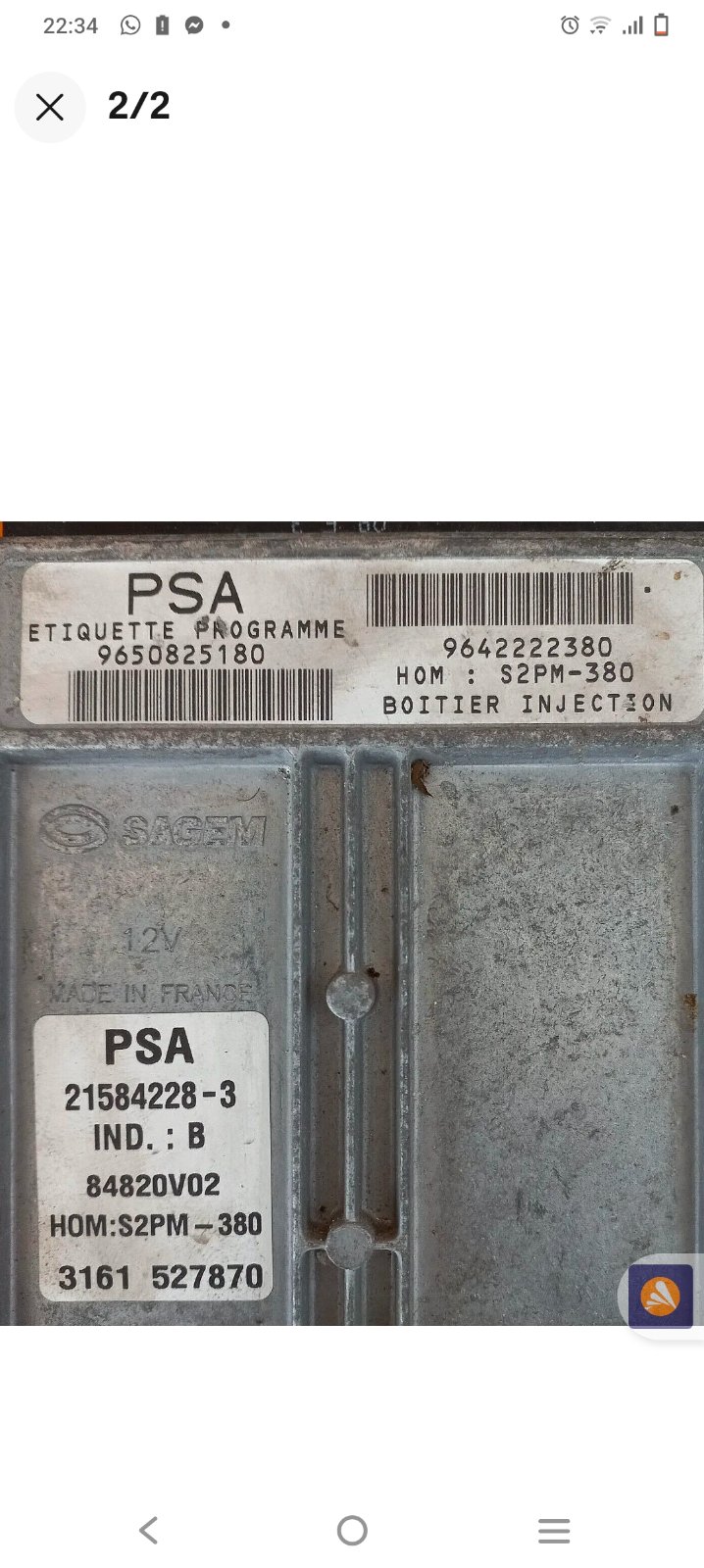

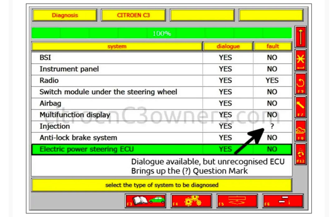

According to lexia it detects this ecu model...but why?
I will continue to experiment...

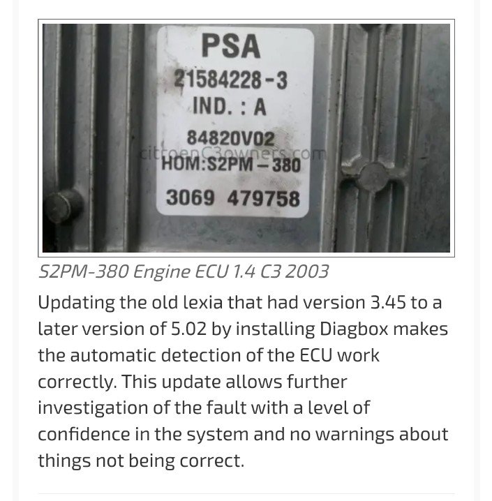

HiPaul-R wrote: 05 Jul 2023, 09:23 Lexia should work on a 2002 vehicle.
Do you have access to Diagbox? This might "see" the system differently even if all it does is to launch its own internal version of Lexia!
I think I have the beginning of an answer and it goes in your direction!
I also thought old car equals old lexia...
Apparently not to recognize this calculator written in 2002 you need diagbox 5.02
I hope this 3rd installation will work

The "?" at the injection ECU is unimportant - the control unit is recognised and can of course be called up.
The error query can then be used to determine further.

precisely it gives me the message that the ECU is not recognized and that the information cannot be guaranteed.
In the previous message I show what he thinks he recognizes is it's a ecu that exists but not my model.

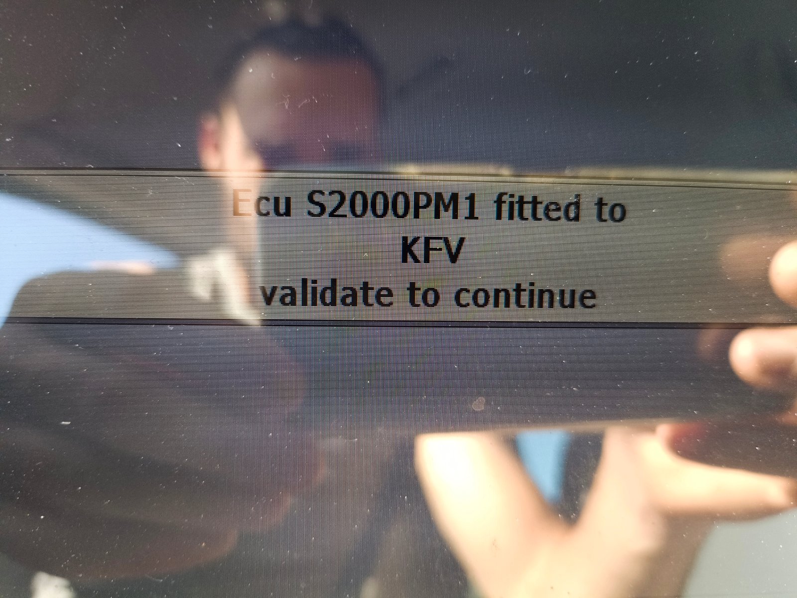

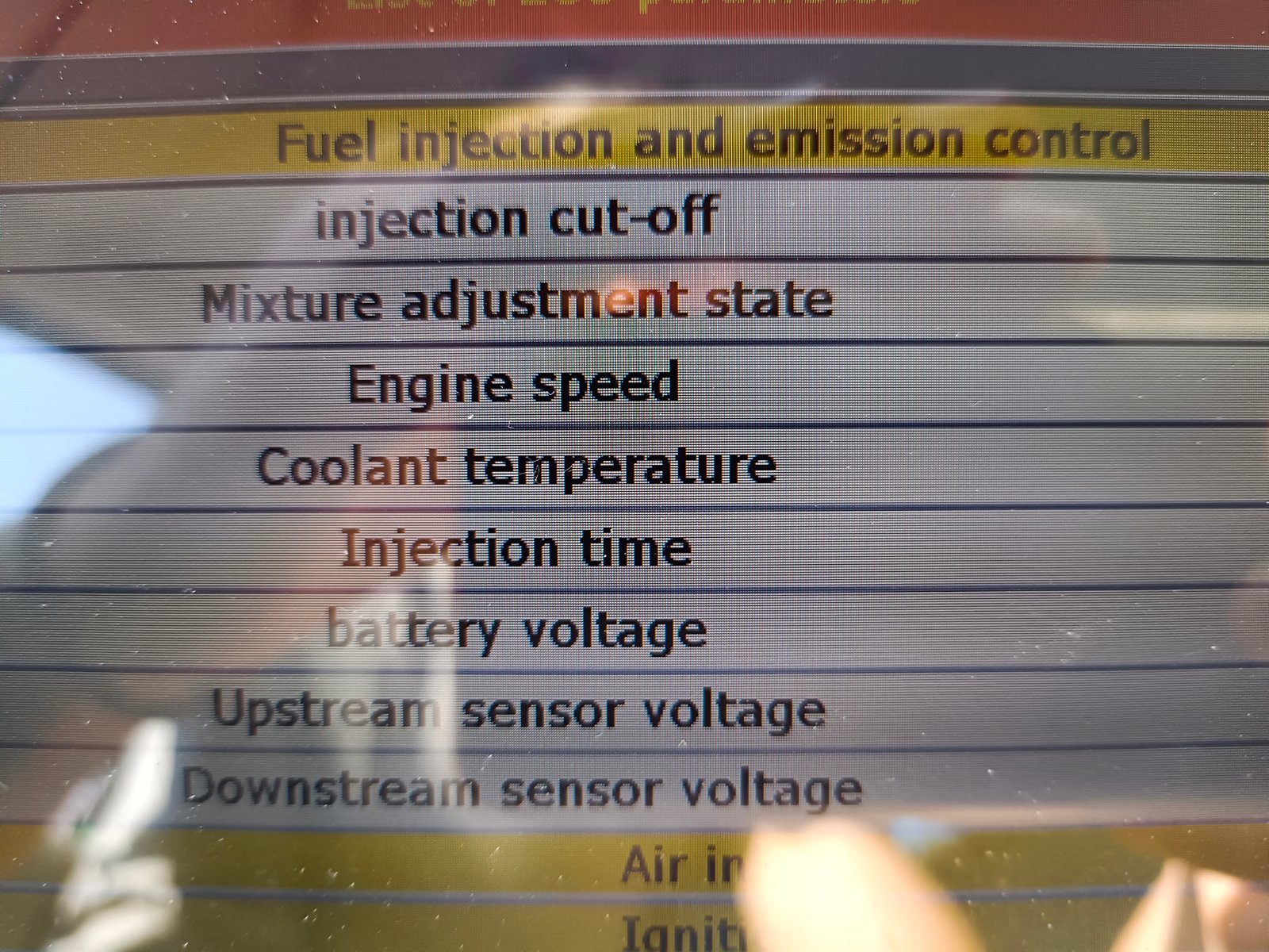

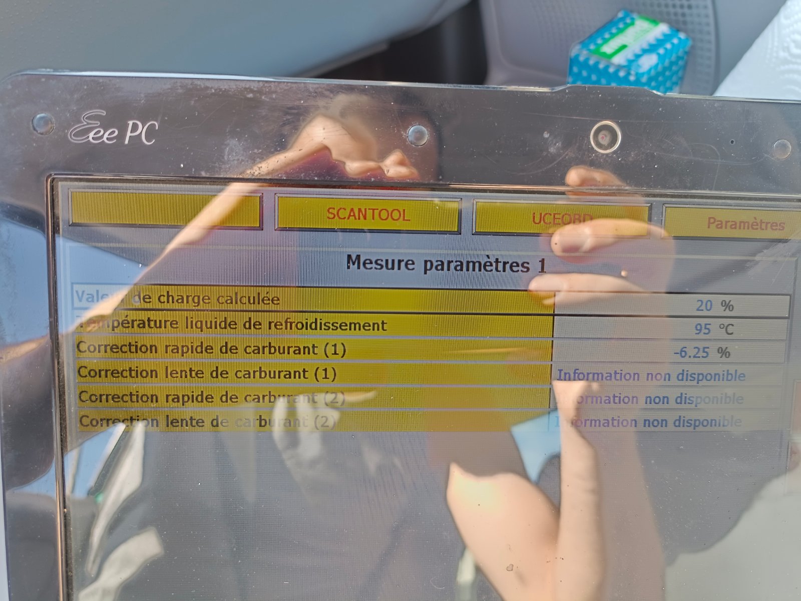

I reinstalled lexia 3.47 and this time it "works"
-He offers me some more model
-all dialogue is yes with no "?'
-he no lets me choose my ecu from the list, he chooses sp2000pm1, telling me this time that it corresponds to my vehicle.
-it only reads stft (the ltft is unavailable)
-data recording still does not work, it remains blocked. "Please wait"
I downloaded diagbox I will also test...

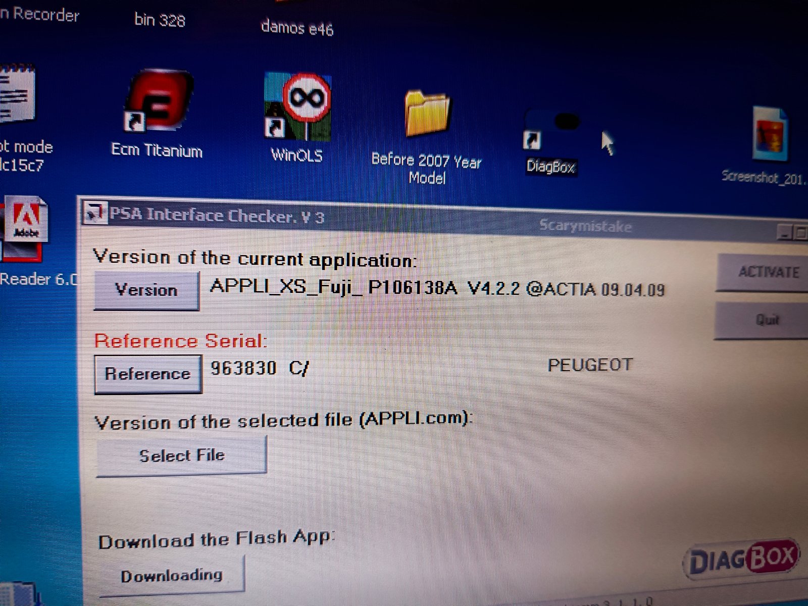

I installed diagbox 7.02 with the hope of being able to log.
The communication not doing so I used the application provided with "PSA interface checker" it is explained there that it is necessary to update to use diagbox.
It is written to activate then select a first file "appli" then download the flash app.
Then install the second file "vci updater"
problem I have no more communication after the first flash.
The tool flashes 3 times and stays green but psa checker is no longer connected..
So I deleted diagbox and put lexia back but lexia doesn't work now "no vci"...
Should I throw the interface in the trash?

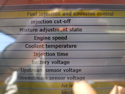

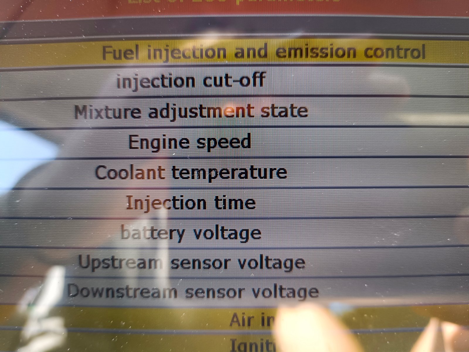

I can not:
- do live data
-read stft ltft
neither reset adaptation
like in this video
(I have not this option in lexia)
I managed to get my interface working again.
I returned to the starting point.
I can not:
- do live data
-read stft ltft
like in this video
- x 6945
Re: Lexia 3 read s2pm-380 C3 1.4i 8v 2002
Your interface probably has missing hardware so cannot communicate with certain ECUs on the CAN network. You need a Revision C with all the hardware for these vehicles. Cheaper clones are cheap for a reason - they are missing hardware, but were OK for older vehicles.
1. the video shows a Diagbox 9.68 VM and a very specific C5 R - each Citroen model has different intervention possibilities because there are different control units. The video is only valid for this specific vehicle type.
2. the LEXIA present in the 9.68 VM has mostly identical applications as the old LEXIA 3 - but sometimes less.
3. you probably still have an older VCI, which only works up to firmware 4.2.2 and therefore cannot be used with the V07.xx and certainly not with a V09.xx. Sometimes the VCI can be reflashed - but rarely does it work perfectly and it does not always survive the intervention.
4. any DIAGBOX can be used but for all old Citroen vehicles up to approx. 2009 the DIAGBOX is not necessary - the old LEXIA 3 is mostly optimal and also the older VCI can be used.
If possible, the old LEXIA should be updated up to ..348 (347.99).
If you think you can reach your goal with a higher software version, you will probably need a newer VCI with a corresponding laptop.
I understand a large part of your experiments only rudimentarily - but practice makes perfect.
Greetings Wolfgang
