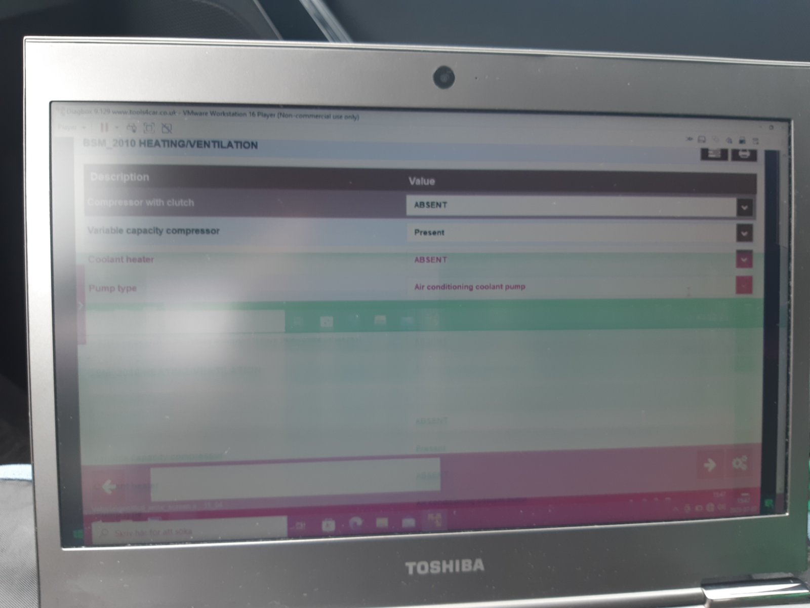

But meanwhile: here we go,
configuring settings i BSI:
1. clutch compressor is - !absent!
seems very wrong to me.
Other settings:
2. Variable capacity compressor - "present" (is that supposed to mean the opposite of a clutch type compressor or is it even right as present?)
3. Coolant heater - "absent"
4. Pump type - "air conditioning coolant pump"
Is that something that I can try to change?
I will try to shoot a better pict.
/Marian

Re: Diagbox 9.129 felkod B1003-00 on 508 SW1 bluehdi 1,6l
Bo, that's no odd, becssue there are some compressors without a clutch...like this:

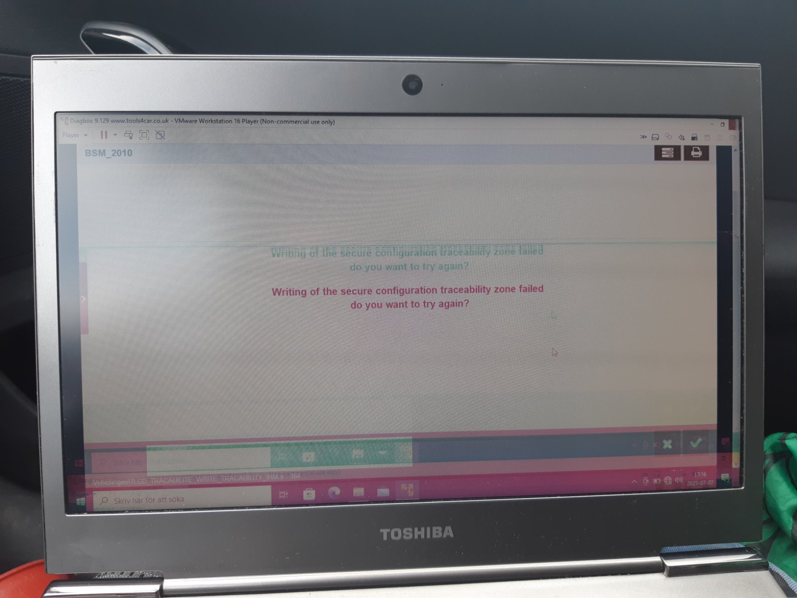

Hell, I dunna how, but it worked out!!
Although Diagbox reported that it couldnt be telecoded and led to a configuration fault - again. But miracolously the clutch is engaging now and a chilly breeze is entering the car! Thanks for helping out and safeguiding! Really appreciated!!
