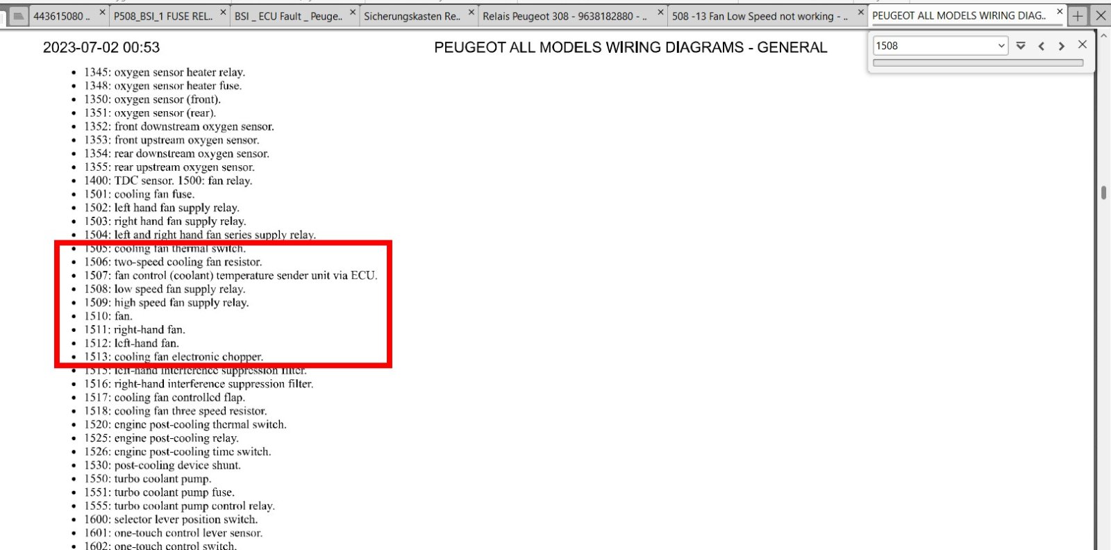

Marian wrote: I found a wiring diagram for the first generation 508, (Number of the relais in this list is 1508, if that can be of any help).
and a scheme for the fuses and relais of the box that I can pm.
Yes please, I would love that! Thank you so much!

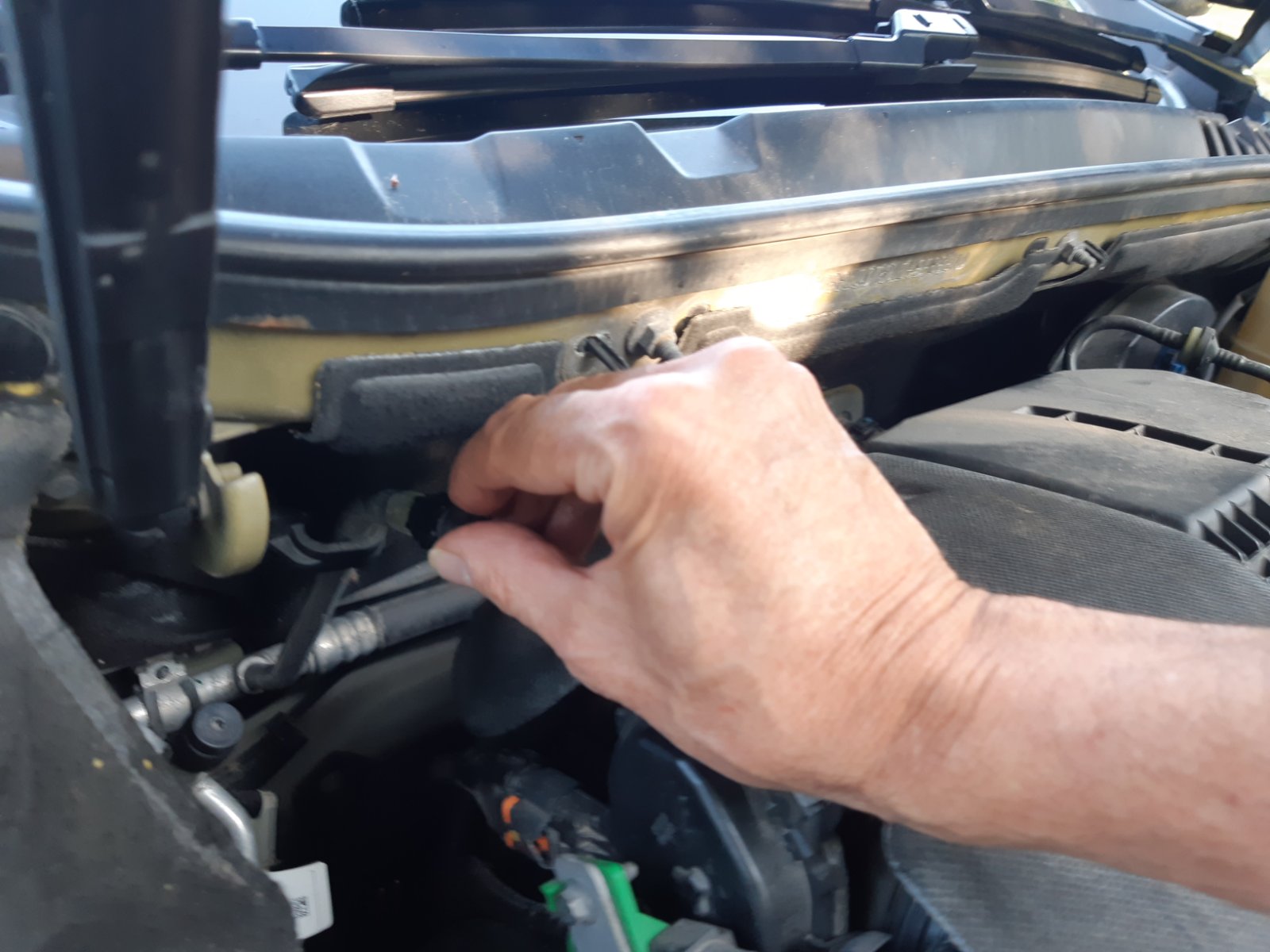

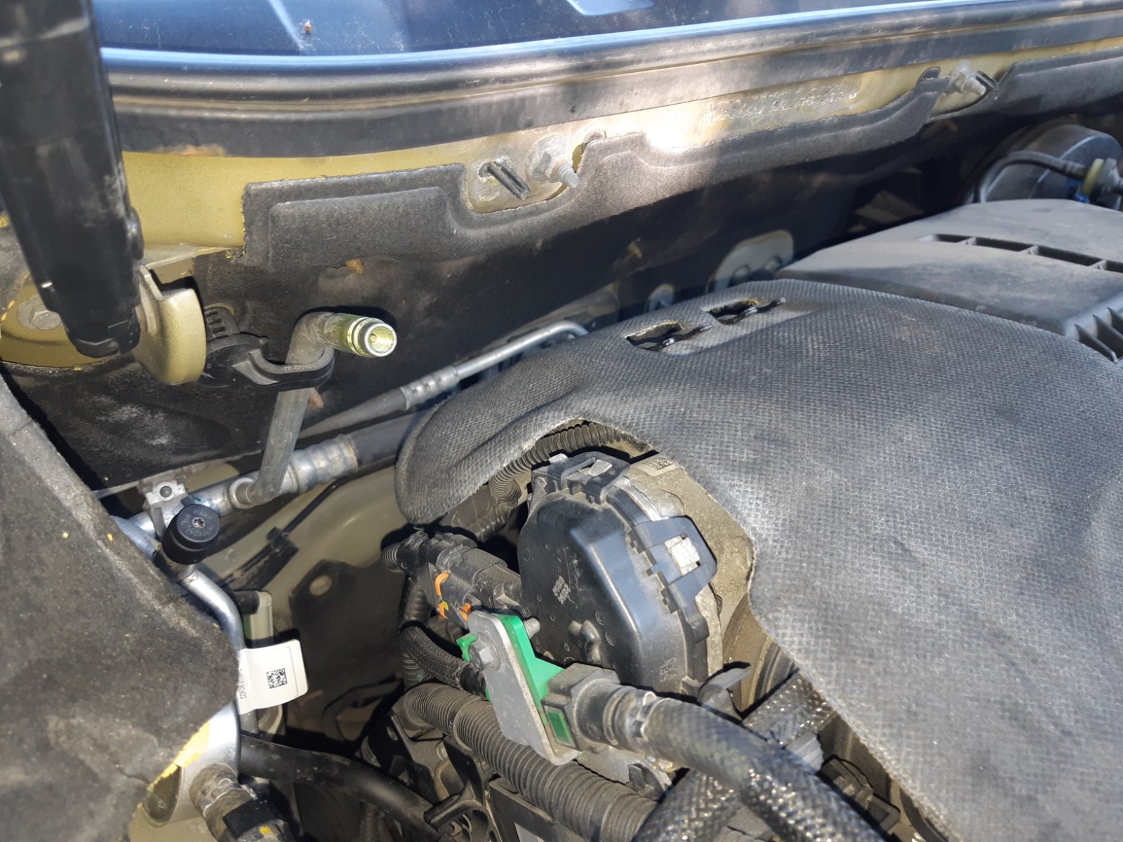

Hi, just press shortly with a small screwdriver the connection valve of AC. If it is good it responds with a forcefull noise :), liekeba tyre air valve or even more :) /Marian

Unfortunately that test will only tell you if there is no refrigerant in the system at all.
Even a low charge will cause oil and refrigerant to hiss out. Which wont tell you much.
However, if you do get nothing out...well, you'll know what your problem is!

Marian wrote: 12 Jul 2023, 17:26
This sounds interesting … I might try this for starts. Thank you

ozvtr wrote: 13 Jul 2023, 00:16 Unfortunately that test will only tell you if there is no refrigerant in the system at all.
So if the system is empty nothing will happen, correct?

Yes. When you push the center pin of the Schrader valve nothing will happen if there is no refrigerant in the system. You may get a tiny puff but that will be it.
However, if there is any refrigerant in the system, you will get a rush of gas (and maybe some oil). Unfortunately that doesn't tell you how much refrigerant is in the system.
