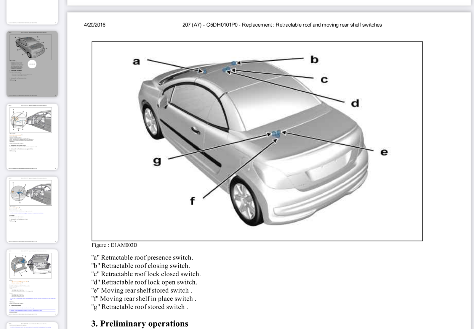

These are the Micro switch positions, I’d take them one at a time and using a test light make sure they work.

i've looked at the panel that has 3 microswitches which is fixed above the lever in the boot. I gather the front of the roof presses on this which should activate the hydraulics to reverse and pull the boot lid closed. I have tried fixing a coin to this lever in case it needs more contact to activate this stage but no luck.

Good afternoon iow207cc and welcome. There are two 207CC here. Roof systems very reliable yet one failed to open once (now fixed). It was due to an insect trapped in the very front beam latch mechanism that caused a stuck microswitch there and only the first three seconds of action. The switches can look "normal" yet need a bit of action and lubrification. One there wasn't broken inside, just needed it's contact nose to be lubed and moved like this
If a reader of this thread tries a diagnosis with a multimeter; it's possible, just not using "beep"=0 ohms mode. The switches have resistors in series (and a few in parallel) such that a controller knows they're installed and available or if not, can declare a harness failure. If the controller "sees" the resistance it can then act and notice any other new failure to go open circuit as "something didn't move or if it did, the switch isn't working". So I recommend use the smallest Ohms scale. In the video, LM is great yet needs five hands to work and film so thinks to use beep. Rather looking at the ohm reading is necessary.
