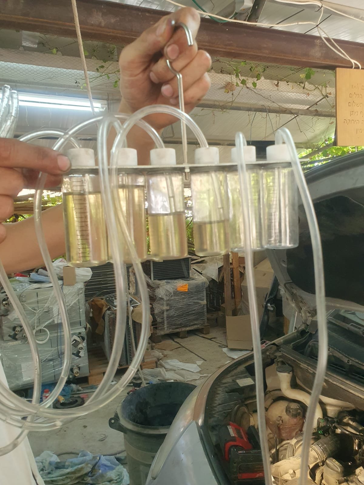

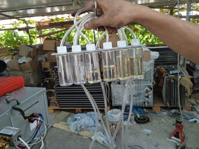

update , so i managed to do the eak off test , i removed the end with the o ring part, i took just the hose , and it was sitting good inside the return hole.
the bottels filled so fast , in like 20 sec it reach 80 ml on the right 2 injectors
added pics of the result.
i took the injectors out , remove the cap and the nozzle , cleaned it with utrasonic cleaner , put them all in , and did the test again , it gives pretty much the same results, (right side injectors fills faster then the left.
but in much slower pace.
dono what else could be blocked in the injector?
can i put the injector as 1 piece in the ultrasonic cleaner?
will see if the light come on again...

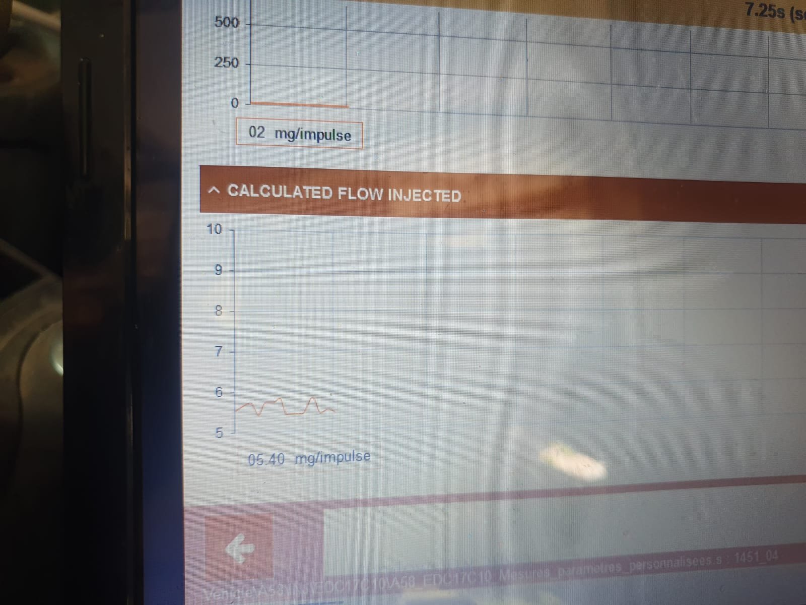

Run a Diagbox read again, see if the error(s) are the same. While the engine is running see what the figures for the fuel flow/correction for each injector is.

the code is the same , i will run the diagbox and will upload the results, i have seen in ebay genuine injectors , so thought about swapping the right 2 injectors.

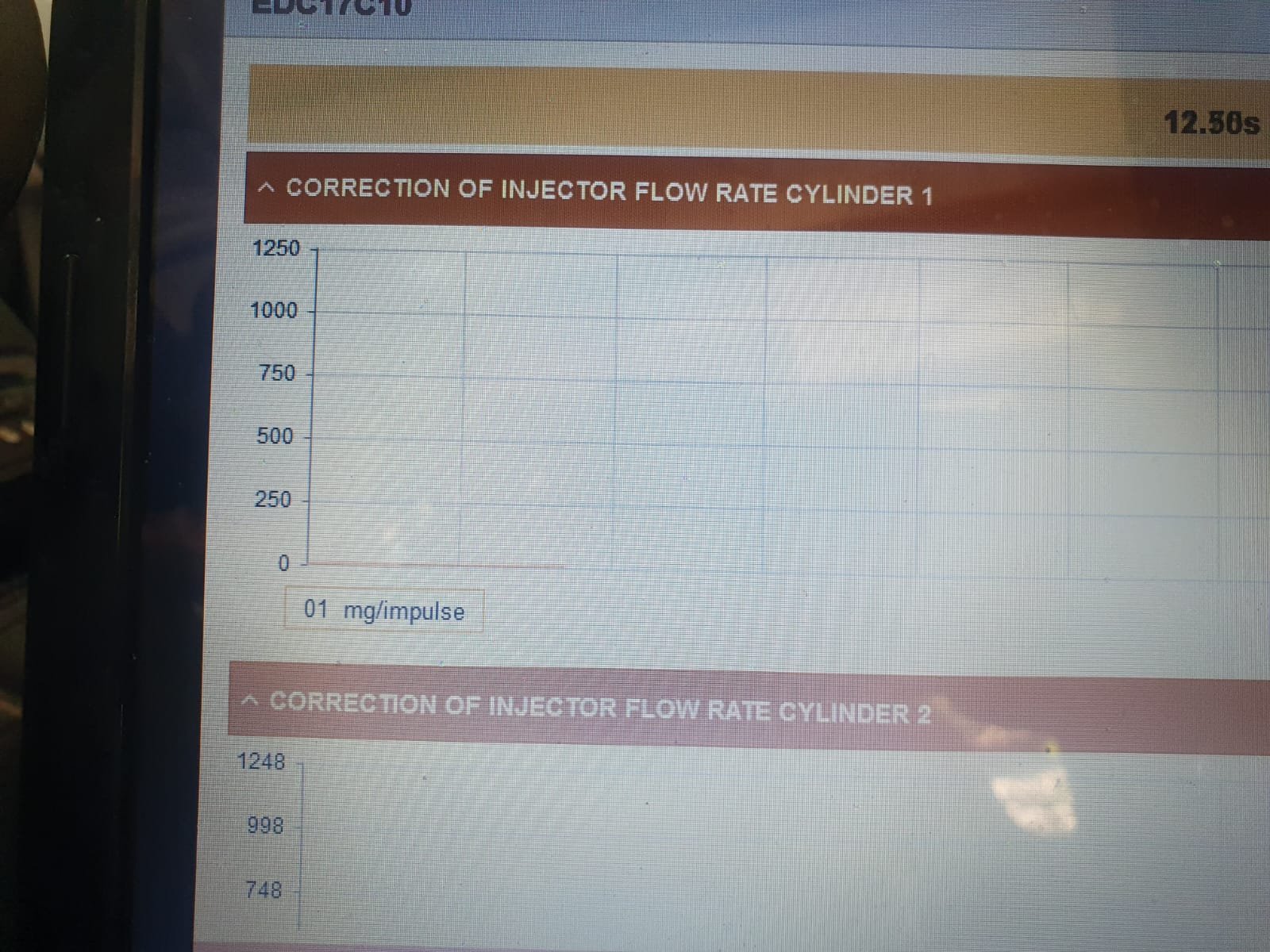

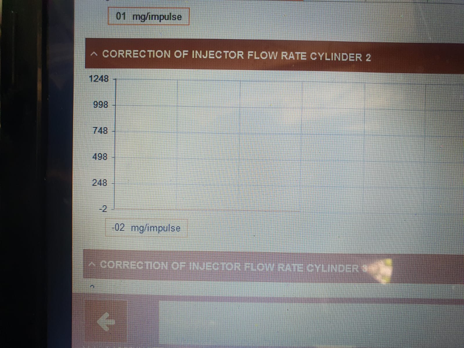

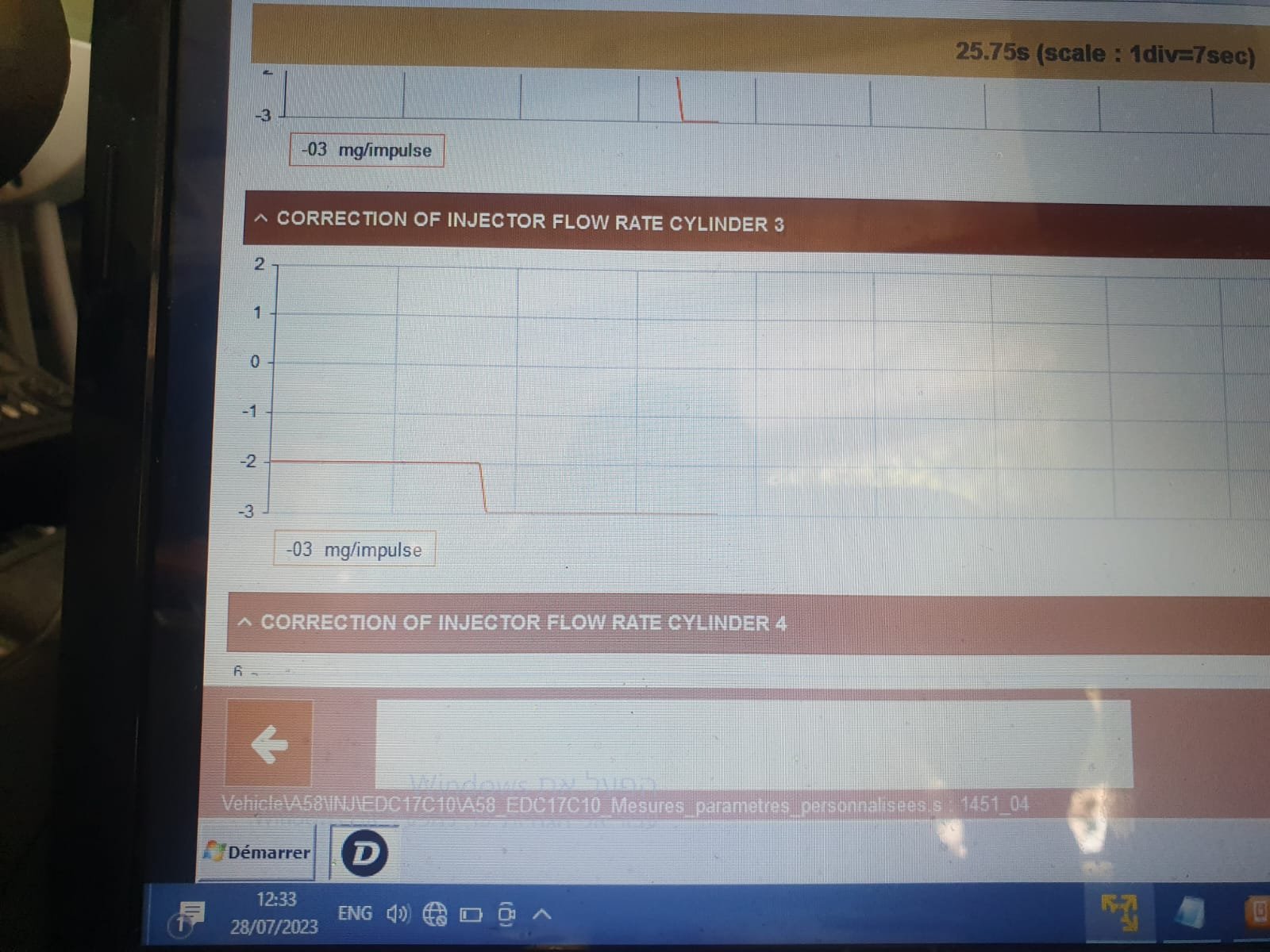

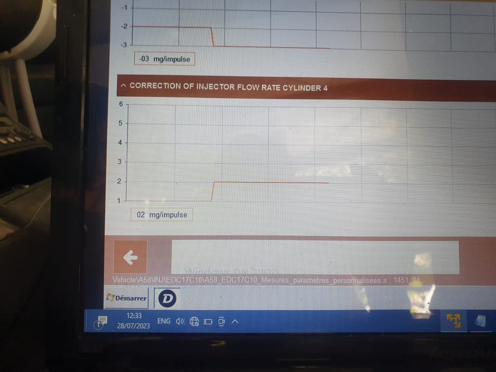

piki
- Posts: 129
- Joined: 27 Jul 2020, 17:33
- x 5
Re: Fuel rail/system pressure too low
have no idea how to read it, i thought it should be like a graph that moving up and down.
what are the meaning of the minus 03 mg/impulse?
