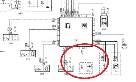

Sorry guys, i was in a rush when i wrote this morning, the wire number is actually 6738 not 6387(listed a vehicle speed signal) it comes from pin 24 of the ABS ecu, The connector & pin numbers were correct.
ozvtr

LOL! That's the "strange wire" coming out of the ABS module that I mentioned before.

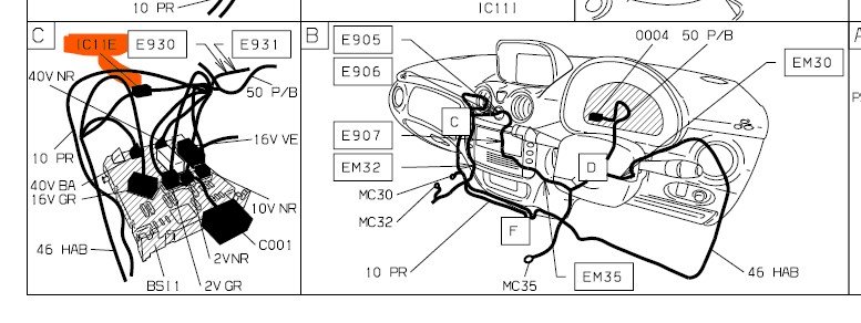

Did you tap into the speed pulse at the connector above the BSI?

wheeler wrote: 19 May 2023, 17:25 Did you tap into the speed pulse at the connector above the BSI?
Yes, that wire you said, did exactly what you said it should! Thanks heaps!
