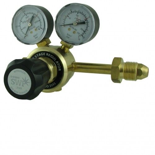

Would I not be able to buy an appropriate SWP regulator complete as shown and change the 300 bar gauge to one with better calibration ie 5 bar increments?Jay-Bruce wrote: 13 Apr 2023, 18:29 But yeah, time for a more pleasant topic, engineering... You'll likely need a different fitment for the nitrogen bottle, as typically we use US style bottle fittings, with a little bull nose on the regulator rather than the continental style flat face regulator, so your regulator and it's connection looks like this...
Forgive my ignorance but I've never touched a regulator but that you looks as though it would fit straight onto a Nitrogen bottle so all that would need resolving is the connection to the sphere?
viewtopic.php?p=452127#p452127
In David's link, we have the resolution to the sphere connection. We just need to get some manufactured...

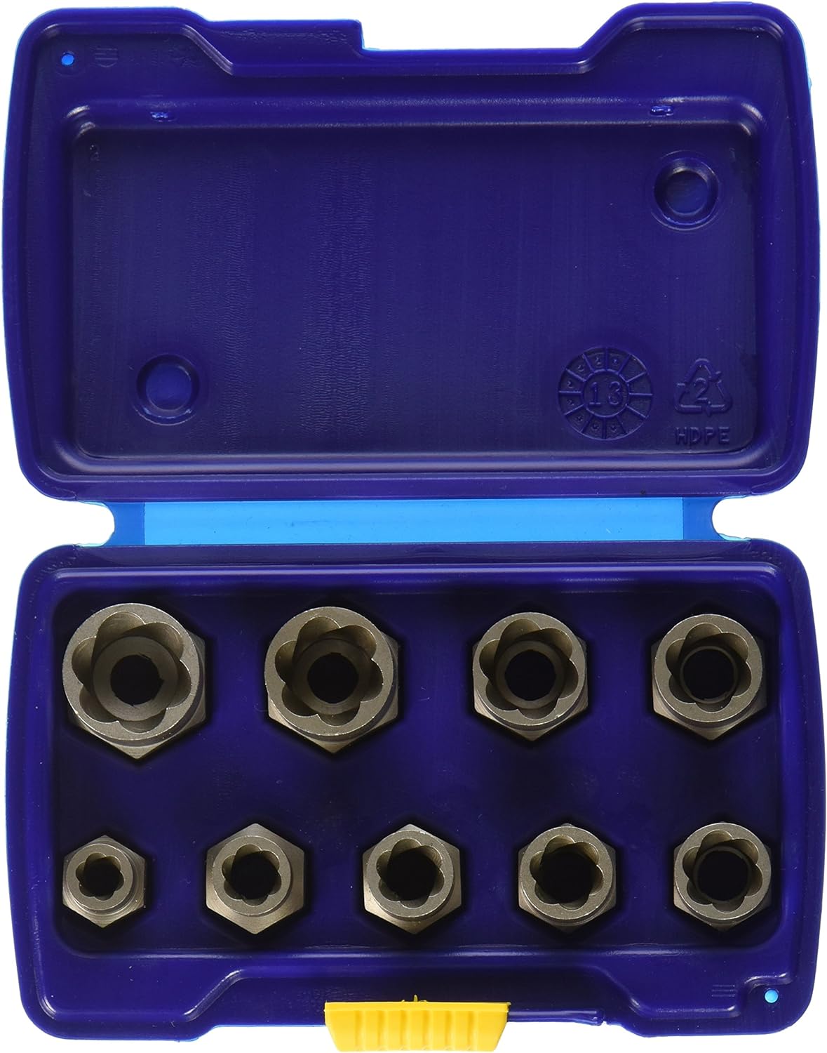

Enlighten me, Jay. What's an Irwin tool? I search Irwin on the net and it comes up with Irwin Tools UK...Jay-Bruce wrote: 14 Apr 2023, 17:21 It's basically a hollow truncated cone with a thicker top permitting a couple of o-rings to go around the 3/8" extension used to drive the Irwin tool, and a monster o-ring around the bottom to seal onto the sphere. Rodger, would you like me to finish modelling this? Or you could give me a back of a napkin sketch, with dimensions, and I'll model it in CAD for you?

Rhothgar wrote: 15 Apr 2023, 11:44 Enlighten me, Jay. What's an Irwin tool? I search Irwin on the net and it comes up with Irwin Tools UK...
Irwin "bolt grip", used for taking off rounded bolts, they are angry little ba$t@rds with a sharp left hand rifling which means the more you pull to unscrew the bolt, the harder these things dig into (what's left of) the head of the bolt. They have a hex on the outside of them but always have a 3/8" square drive hole in them so you can drive them with a breaker bar / ratchet.

Regulators that have two gauges on them are typically set up so that one gauge, the one with the highest scale typically on the left, is showing the inlet pressure, as in the pressure from the bottle, and gives you an idea on how full/empty the bottle is. The second gauge is the line pressure, as in what pressure the regulator has reduced the bottle pressure down to. Usually the outlet gauge covers the working range of the regulator, so the ebay one I've shown you goes to 15 bar, and you'll never get more than 15 bar out of the regulator, you could however swap out the 15 bar gauge and put in a 3 bar gauge to use the regulator for tyre inflation, but you can't slap on a higher pressure gauge to get more line pressure out of it as the combination of spring, port and diaphragm won't permit it.Rhothgar wrote: 15 Apr 2023, 11:38Would I not be able to buy an appropriate SWP regulator complete as shown and change the 300 bar gauge to one with better calibration ie 5 bar increments?Jay-Bruce wrote: 13 Apr 2023, 18:29 But yeah, time for a more pleasant topic, engineering... You'll likely need a different fitment for the nitrogen bottle, as typically we use US style bottle fittings, with a little bull nose on the regulator rather than the continental style flat face regulator, so your regulator and it's connection looks like this...
That rig is absolutely awesome and in fact he has posted on the end of this thread! I never knew Citroen did this tool for their workshops. I imagine they regassed spheres and charged the customer full price for a new sphere...
Seeing as you are an intelligent lad and quite curious about this sort of stuff, here's a useful little run down on the inner workings of a regulator for your edification. https://www.wonkeedonkeetools.co.uk/gas ... lator-work
