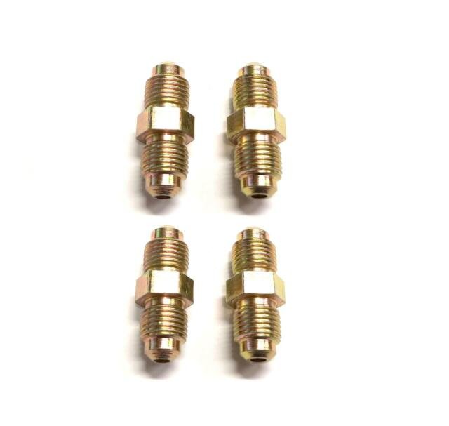

Thanks Jay,
I was thinking of using one of these instead, what do you think ?
Kenny
Kenny

They would do for joining two flared pipes to each other, I've used something similar where I spliced steal to cuni halfway along the floor pan.

Okay, I'm thinking about using one into the hydraulic pump sealed with Loctite and splicing in a piece of Cuni pipe as I have a kink which maybe restricting the flow plus a very slow weep from the pump.
Kenny
Kenny
