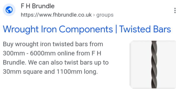

It's probably fine, close enough. Those who lean heavily on the breaker bar or give it a good blast of the pneumatic impact wrench then wonder why they have stripped threads out the hub are in the ones who should give it more thought.
I always do them up with torque wrench, not because I worry I couldn't get them tight enough to not come loose, but because I picture myself having reduced the standard wheel brace to something like this:
And I don't fancy doing that, again! Particularly if is on the hard shoulder rather than at home! I also always add a little copper grease to the threads first time they come off in my ownership. Though I do understand others seem to worry about doing that??

I always use the torque wrench now too, to justify having it.
Was taught by my dad, a steam then diesel engineer, how to tighten bolts 'enough'.

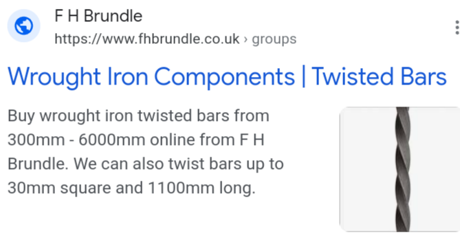

I always do them up with torque wrench, not because I worry I couldn't get them tight enough to not come loose, but because I picture myself having reduced the standard wheel brace to something like this:Image
Rattle gun are ok you just have to know when to stop lol
