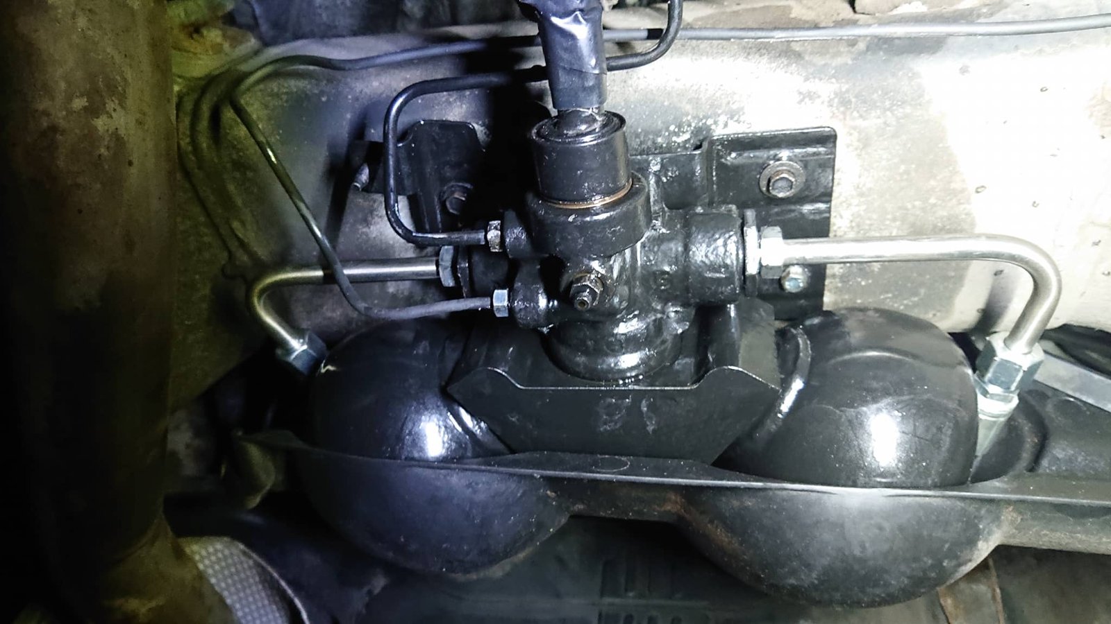

The unions in your last picture look correct for my C5 divider to rear right wheel strut pipe. Citroen part no is 5270 QA.
I'd be really interested in buying an assembled one - or if that is 3/16 copper pipe, just 2 sets of unions, seals etc would work.
Please let me know...

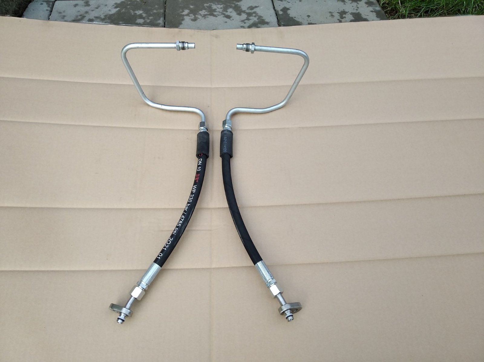

Svod wrote: 28 Mar 2023, 15:11 Hi everyone,
Two years ago I was forced to change rear hydraulic pipes on my ’09 x7 2.2HDi cause one of them leaks. Whereas the pipes was unavailable to buy here I decided to create substitute from original. I was working on it with my colleague. We tested almost 10 pairs during last year and half and we can now manufacture them for C5 X7
Citroen numbers for them are:
- 5270VG C5 X7 right
- 5270VF C5 X7 left
Tubes are similar to original, except they are not made form zinc steel, but from stainless to ensure long life. Next difference is that they are separable to 3 pcs (1st one is stainless steel pipe, 2nd one is rubber hose, 3rd one is stainless upper part which is connected to rear hydraulic piston). Rubber hose is certified for use with more than 300 Bar pressure, but even if somewhere in future hose starts to leak, it is possible to change only the hose. Not whole pipe.
We want to make first larger batch and to specify the price I’m curious if some of you want to buy those for your C’s.
Let me know if you are interested or if you have any questions.
- Actual 1:1 original version
- First version with shorter stainless tubes
