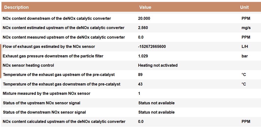

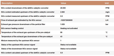

Re: deNOx issue
Hi.DMC23 wrote: 20 Mar 2023, 14:07 DeNOx system 2
8 NOx content downstream of the deNOx catalytic converter 20 ppm
9 NOx content upstream of the deNOx catalytic converter 0 ppm
I have a similar problem and the system is new to me but I'm wondering about up and downstream, shouldn't they show a result and not show 0 and 20 ppm which indicates either no connection or locked? My result is the same but it also shows that the signal is not available.
