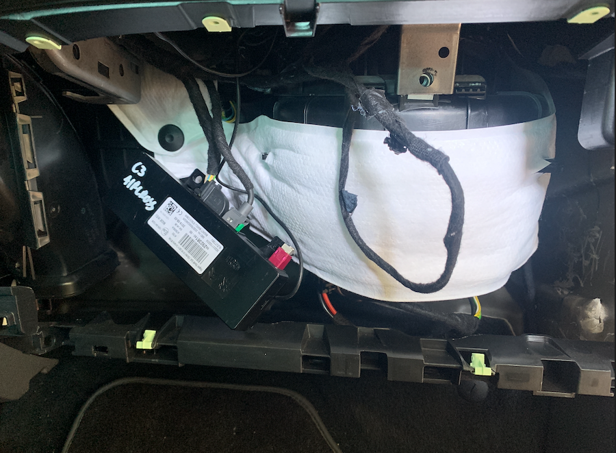

I had original BTA box that came with the car for emergancy calls (SOS and DS buttons on the ceiling).
But that one wasn's capable of permanent Internet connection - needed for Connected Services...
So I bought a newer BTA2.0 Box from a crushed C3 Aircross 2018 and installed that one (instead of the factory one). All the connectors were the same.
I tried telecoding BTA2.0 but you can't do it because the ECU is locked - needs connection to Stellantis servers.
Luckilly, it works without any telecoding! :-)
PS: not the easiest thing to remove the glovebox in DS5 and relpace the BTA box (it sits atop of the glovebox), but once you remove the pegs on the bottom sides, then it goes out...

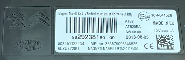

What part number did you get please?
MacSlavko
Posts: 132
Joined: 17 Aug 2017, 23:39
x 32
Re: DS5 Wave 1 to Wave 2, and Connected Services
Unread post by MacSlavko »
This one:
