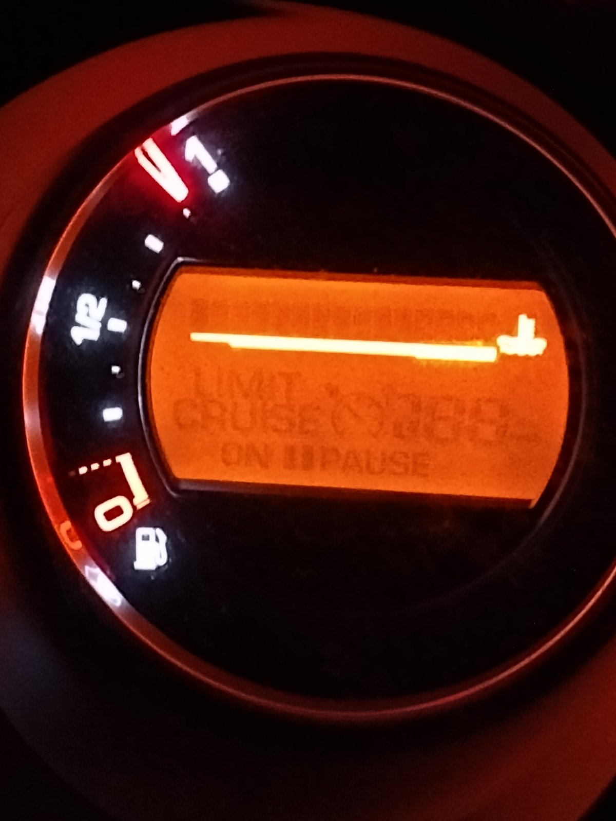

655 miles covered, 68.51 litres replenished.
68.51 l = 15.09 gallons.
43.4 MPG.
Happy enough with that. Onboard gauge actually under reading as it thought 38.7 MPG.
Interestingly, despite letting the pump click off three times when filling, this is how full the car thinks the tank is.

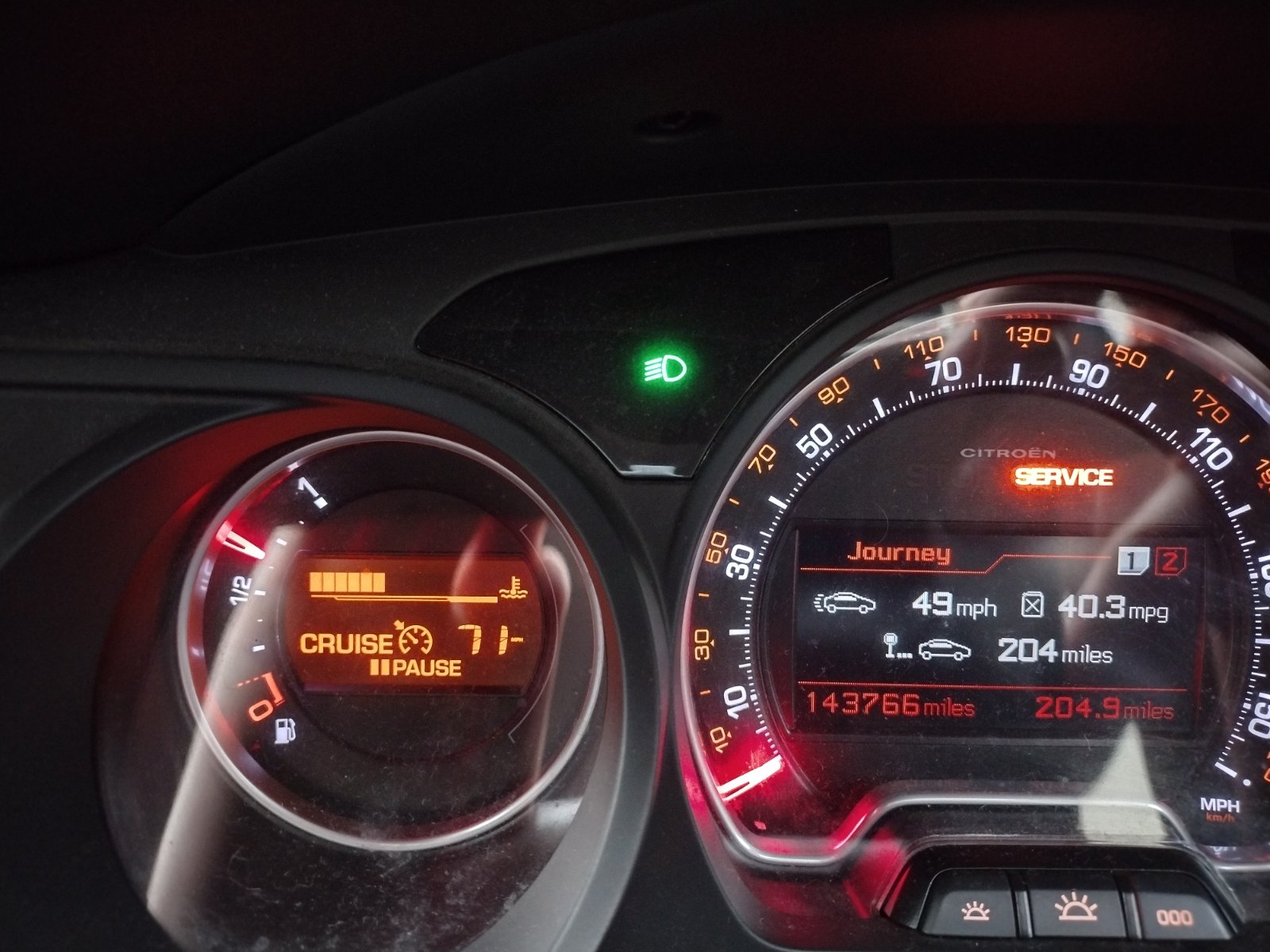

CitroJim wrote: 16 Mar 2023, 05:40 Enjoy a great trip today Matt :D
Thanks Jim. Lovely quiet roads but flipping heck it was wet up there today!
Some more respectable values on the read out, had 42.2 mpg on screen after the first 50 minutes of the journey, 71mph cruise control up the motorway. Rest of journey is a mix of fast A road (some dual, some single) and rather slow, tight twisting A road, so does take the edge off. Obviously a second warm up cycle for the return as well.
Pretty happy with that. Will run the tank right down again then another refill. I'm curious if onboard estimate is consistently under reading or else the fuel station pump last time cut out early. Tank to tank brim full is susceptible to that error, but usually get a result the other way (worse than expected) on next fill.

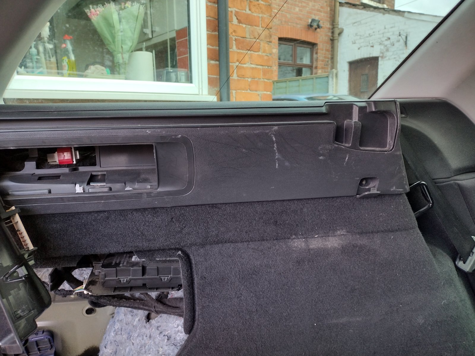

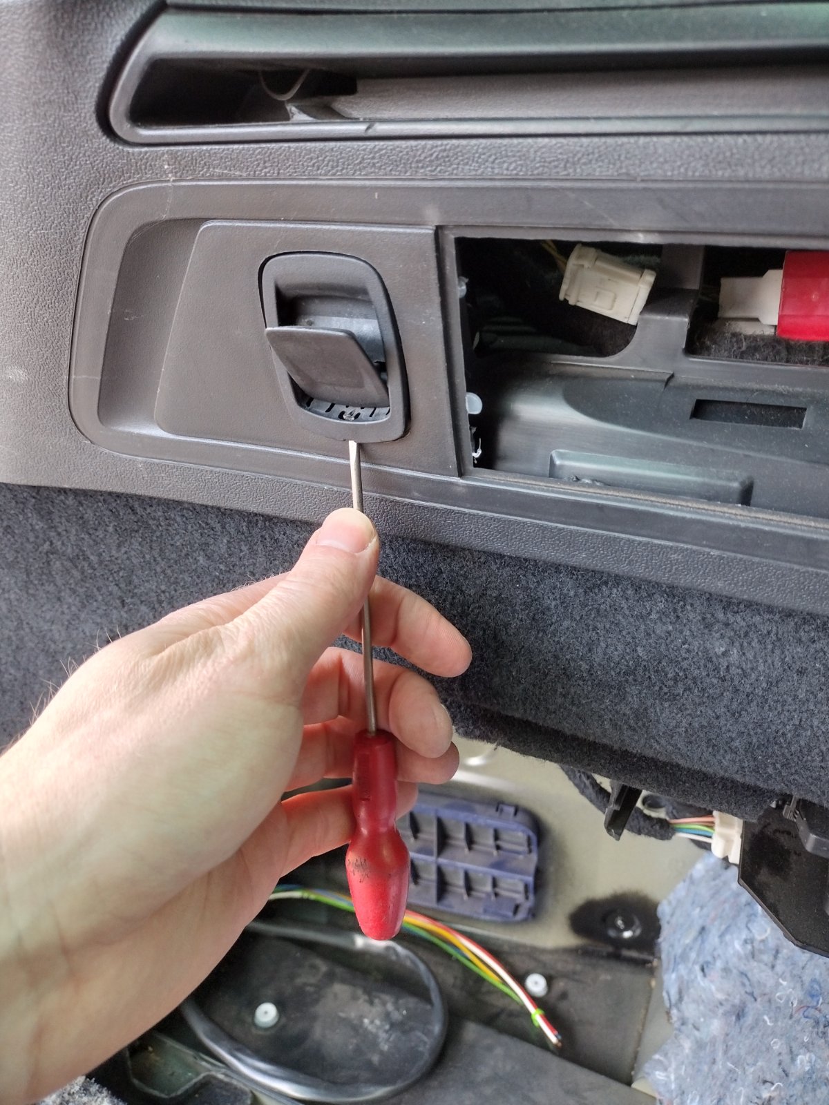

So, as the forecasted rain hasn't yet arrived, thought it was time for a go at the towbar wiring.
Remove boot torch
Remove boot torch
Only clipped in, don't lever at the back edge (hooks at that end. Various splodges of hot glue gun from previous owner.
Gives this
Gives this
Lever under the carrier bag hook
Reveals a second T20 Torx

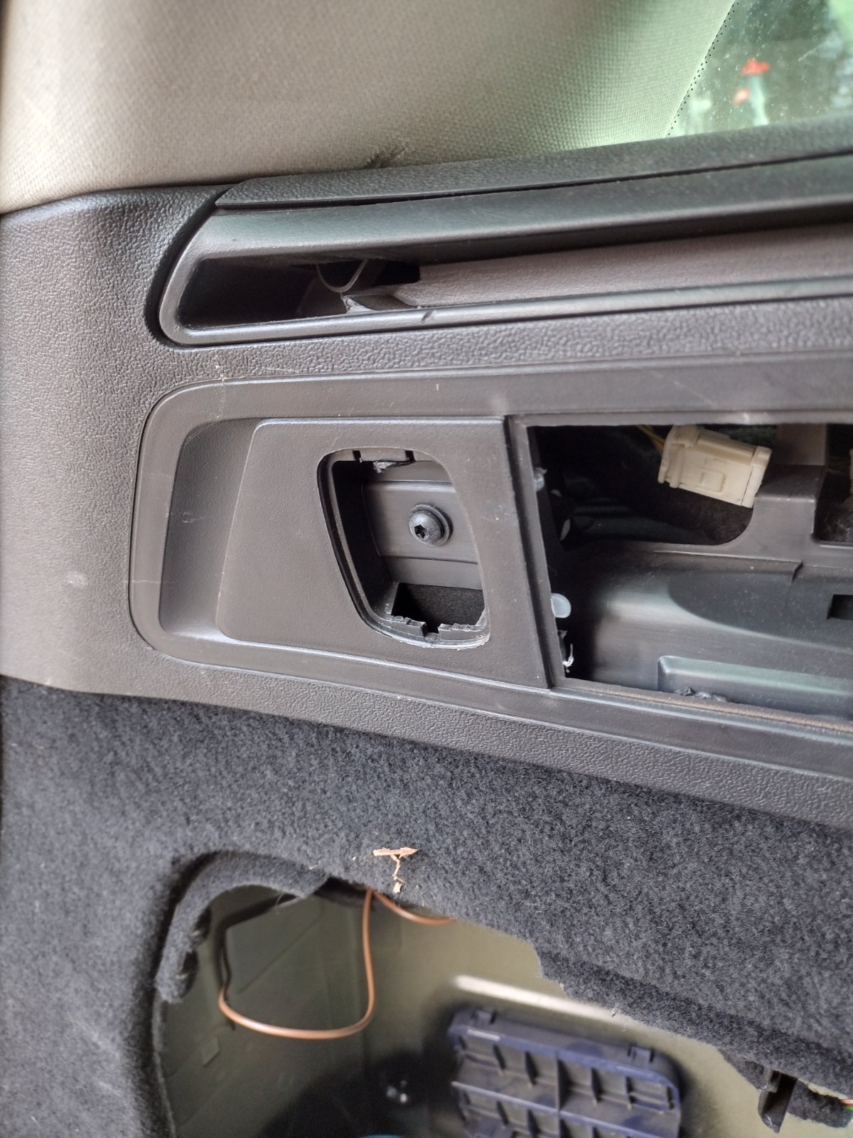

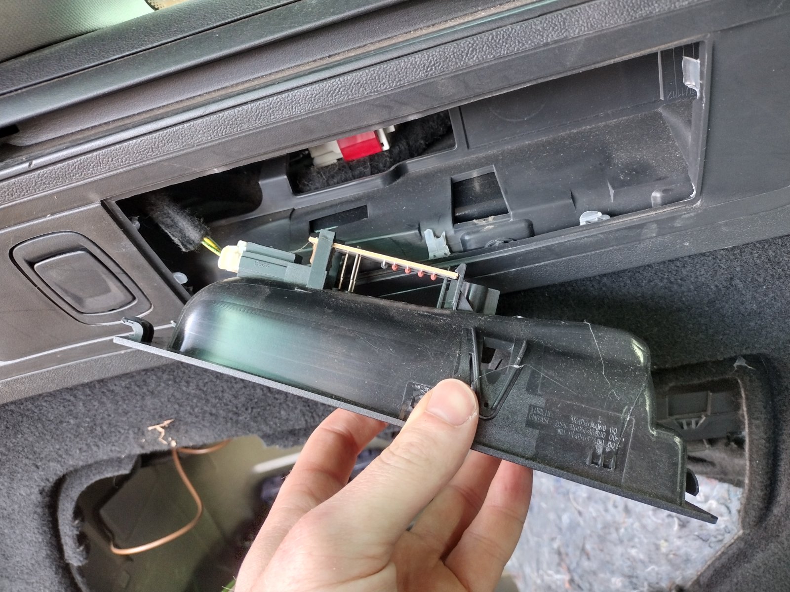

1st T20 Torx is front end under a plastic flap levered it out from the top.
Bag hook hidden screw

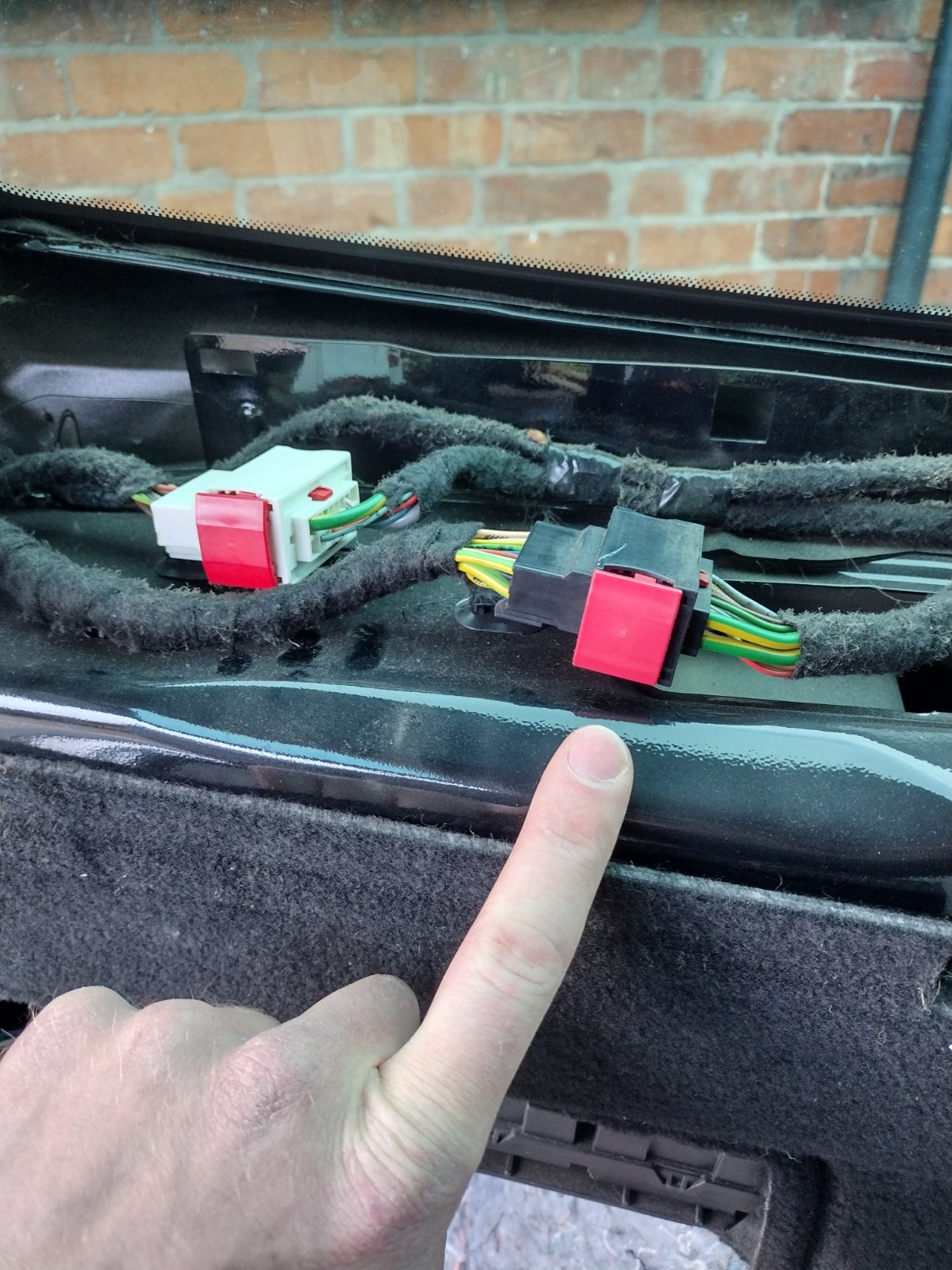

Scary large pile of wiring!

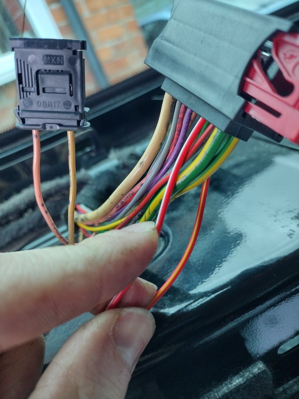

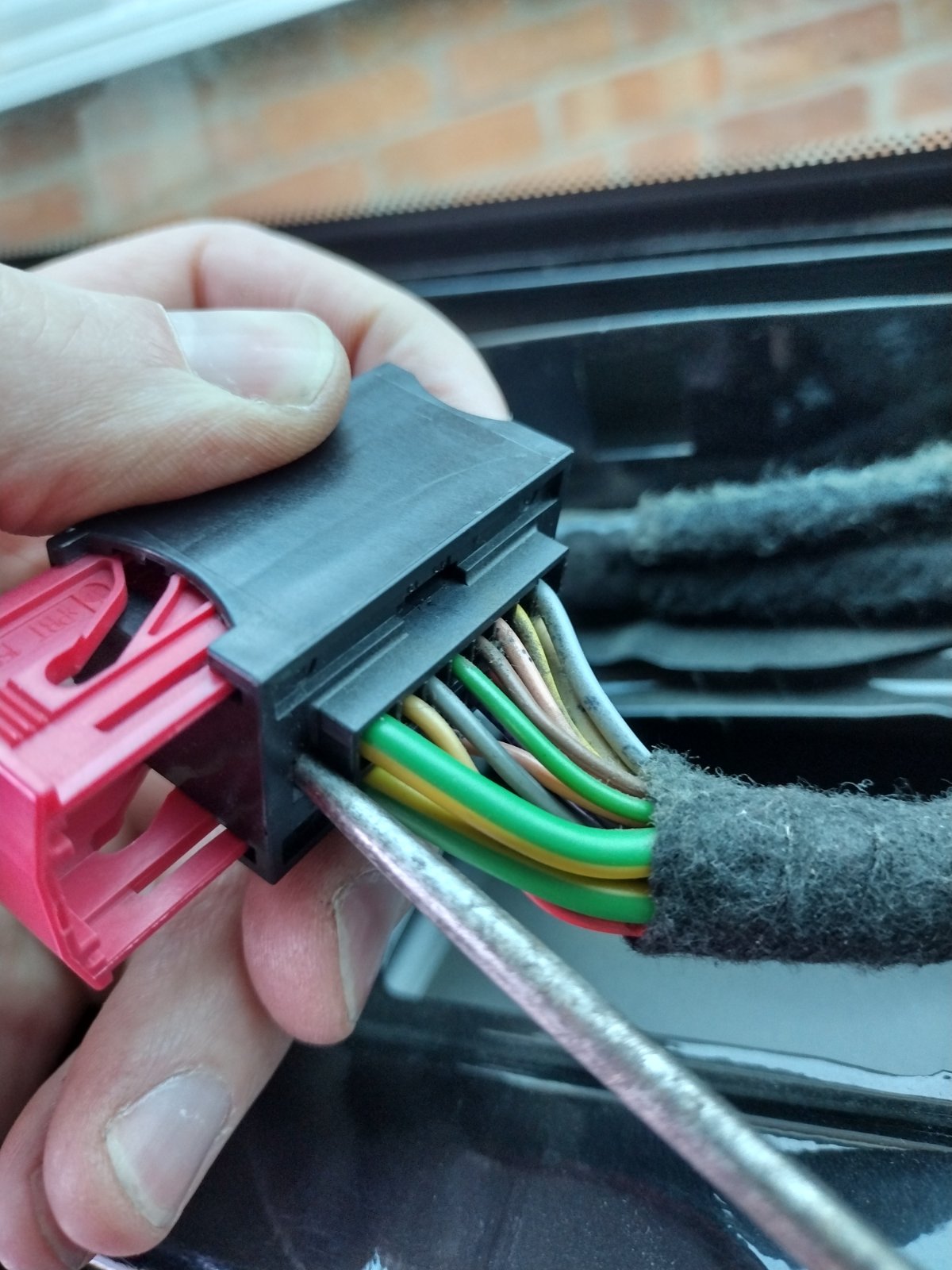

Surprisingly complex reverse engineering pin swapping etc of black and red connector
Unsuspecting victim
Unsuspecting victim

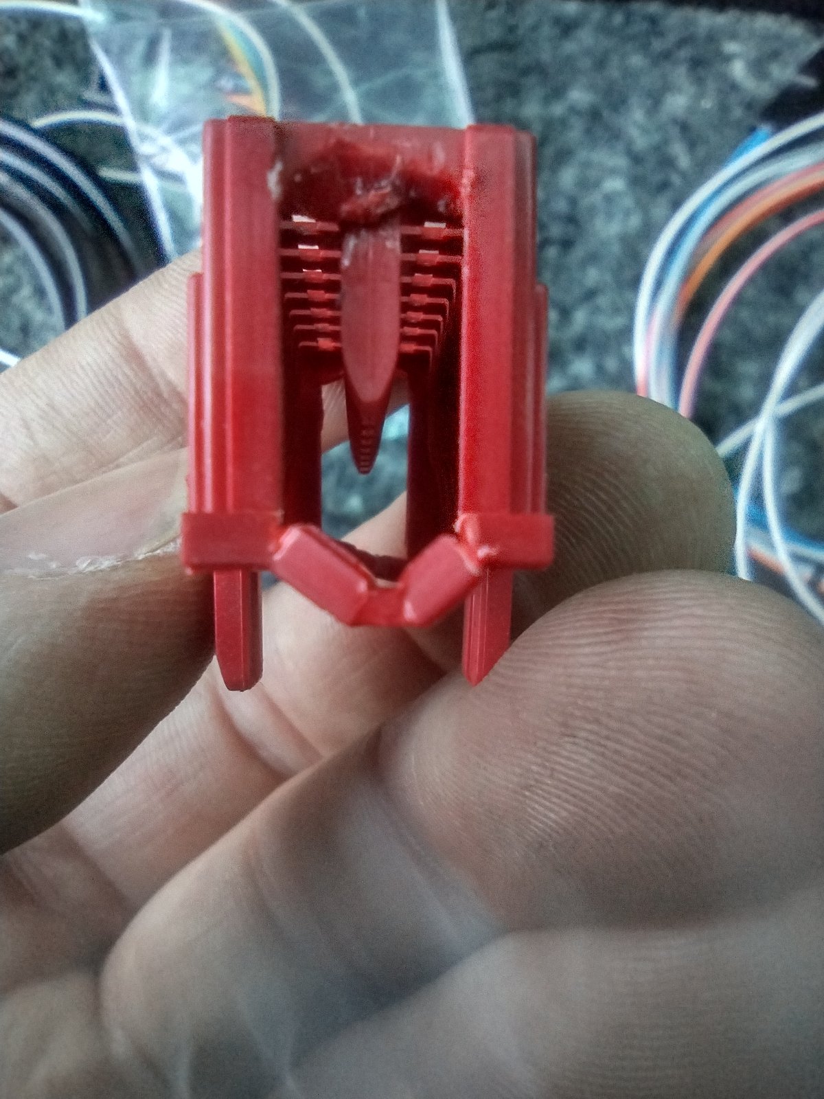

Bradawl through tiny holes in failed attempt to...
Not break either...
Not break either...

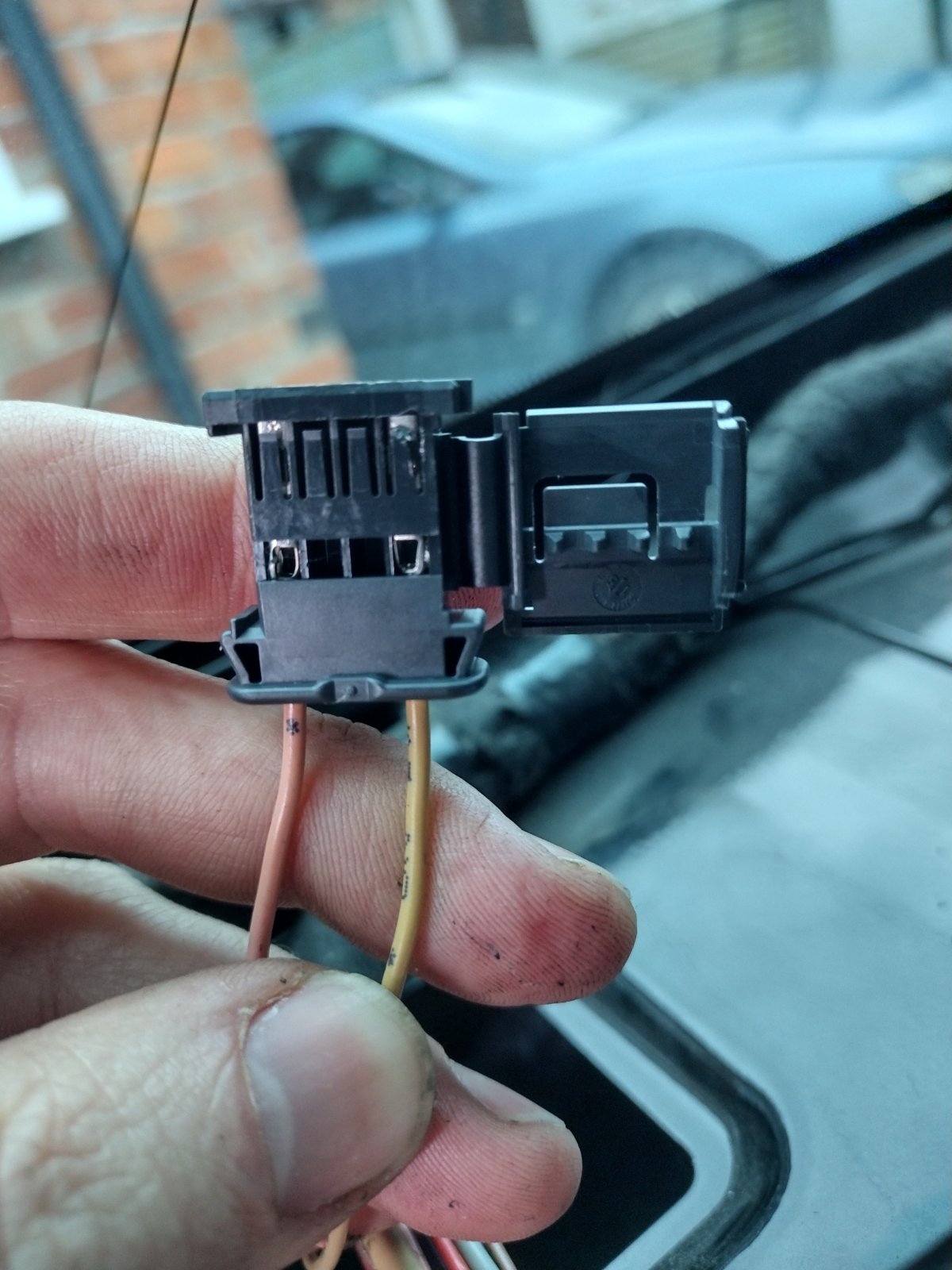

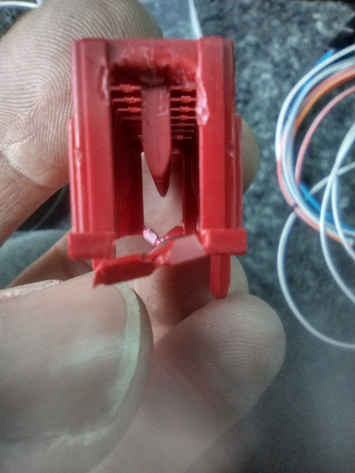

These two edge clips
Two wires extracted from black and red connector to then push into this brand new connector
And two new wires go into the vacated spots in the existing connector

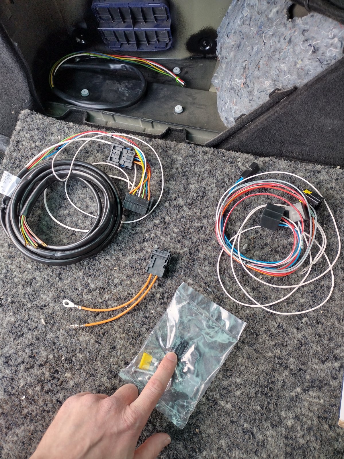

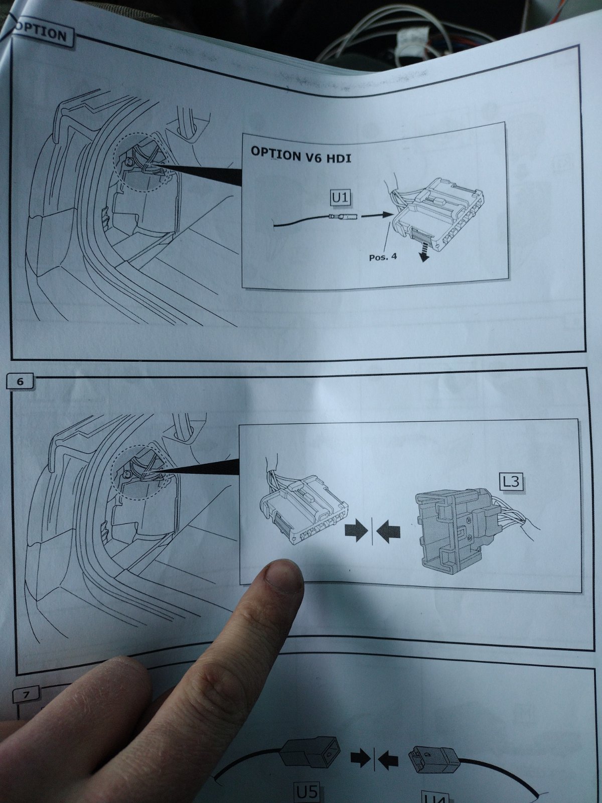

Then it all seemed to go wrong! instructions say plug presume light-colored or white 6 pin existing plug into L3 new connector.
Instructions
Instructions

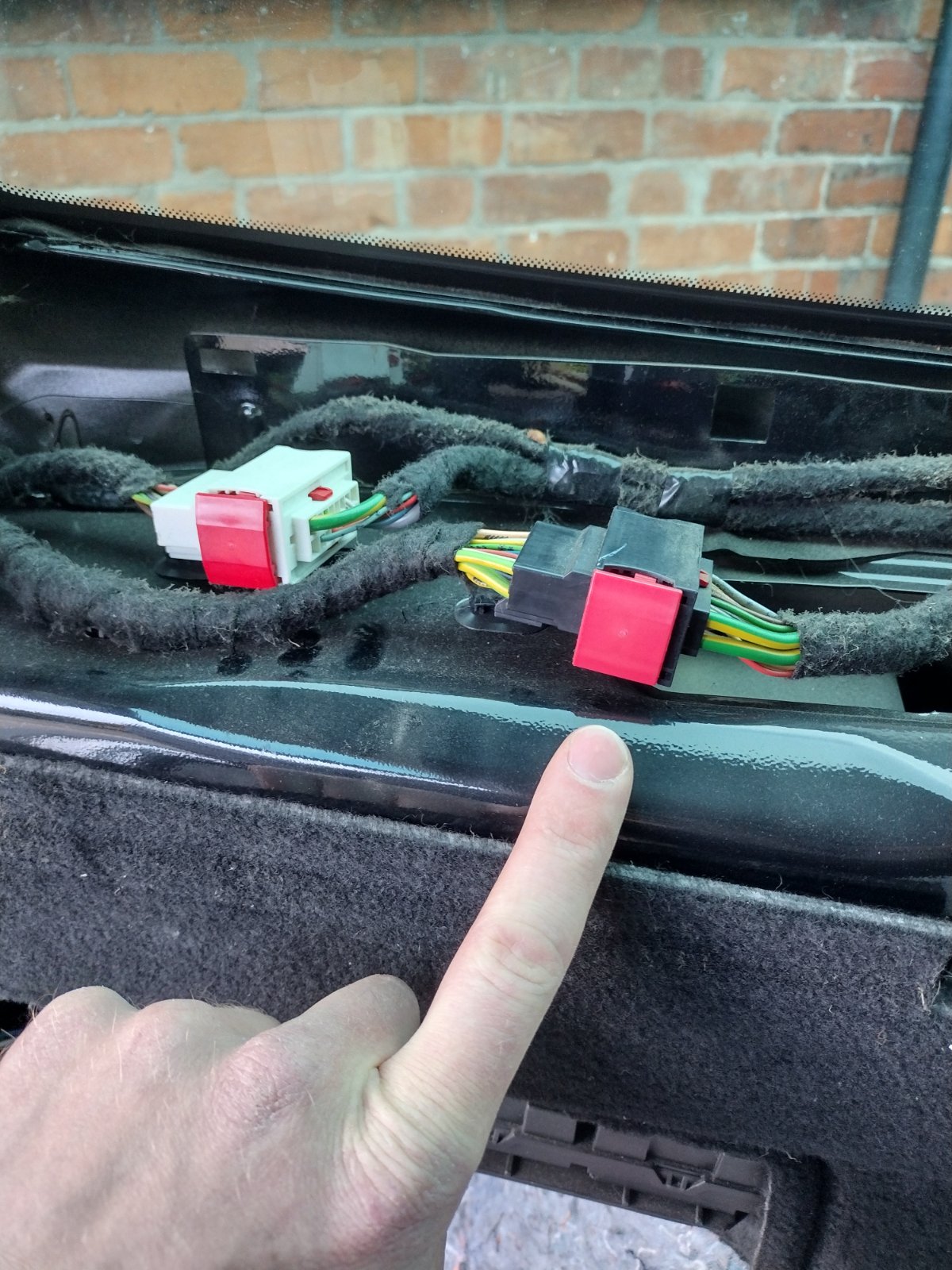

Can I find the damn thing, can I heck!?!
Top of the page is optional step for V6 HDi (so not needed on my 2.2 HDi) but this step isn't optional and there's four wires in that new socket. Doesn't feel right they wouldn't be connected. Ignoring the fact it appears to be saloon boot shown! There's no sign of this white connector in the circle area or anywhere else nearby I can find

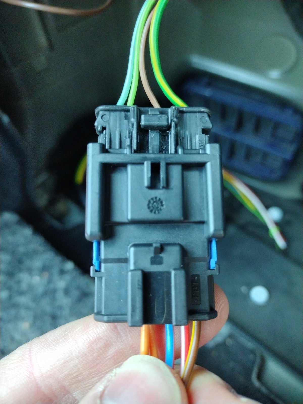

Existing tail light connector plug into new socket L3
So above is the only socket I can find in the vicinity which is direct fit in the supplied new socket however there's nothing in the kit which then plugs into to this now vacated turn light socket so that's not my not going to work!
